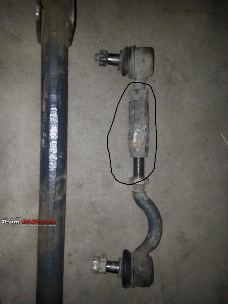

Recently, after a 6300 km drive, the steering in my Safari 2.2 started vibrating. The vibrations started while accelerating at speeds between 45 till 80. After that the vibrations stopped. No form of sound was coming from the suspension set up. My car has run 35000 kms and is 2.5 yrs old. I took it to the TASS Auto Vikas at Okhla Phase 1. They found a lot of play on the left front tyre. After looking at the issue, they gave me a long list of parts to be changed, and total cost of approx. Rs. 20000. Following were the parts:
1. Lower ball joint - Rs. 2100
2. Upper ball joint - Rs. 1900
3. Bush kit - Rs. 1250
4. Center pin link rod - Rs. 4300
5. Center pin bush - Rs. 1900
6. Jumping Rod bush - Rs. 300
7. Tie rod end (2) - Rs. 2200
Lathe job - Rs. 1200
Labour - Rs. 3320
Greasing - Rs. 622
Balancing - Rs. 500
Though I am still within the extended warranty period (4 months left), they said that these do not come under warranty. Only if the shockers are not good, they will include under warranty.
Their interpretation was that this was due to wear and tear. The car had run only 35000 kms till date. Strangely, 2 months back I had taken the car to them for a full checkup, and that time they inspected this portion and had said everything is fine.
So I left and took it to a mechanic near Bhikaji Cama Place as suggested by V&V (we met on Sunday morning at the bhp meet). The were closed because it was a Sunday, so I took it to a mechanic at GK2 M block. These guys deal with a lot of cars on a daily basis (imported and Indian), therefore I was comfortable in getting the work done from them.
After removing the tyres, they suggested the following. I am not an expert, but I guess these are the ones:
1. Center link rod - The bush at the left end was not working properly. They suggested that this be repaired at the lathe, but better to replace. So I purchased a center link rod (Rane brand) for Rs. 2600.
2. Tie rod replacement (comes in pair). Costed 980.
3. Lathe work on the center pin bush - I think this is connected with the tie rod. Not sure. Costed Rs. 1000.
Labour - Rs. 700
That's it. All this was on the left side suspension. The right side assembly was totally fine. He looked at everything else and said things were fine and nothing else needed to be done.
Thereafter I got the wheel alignment done. Now the car is running fine once again. No steering vibrations.
Wanted to ask one more thing on the forum. The front right tyres are wearing out from the inside and the outside edge. All other tyres are fine. This is something that has been happening since a long time, but I never bothered. What could have been the problem? The alignment was definitely out, since the wheel alignment guy got it fixed. Is there something else I need to look at?
