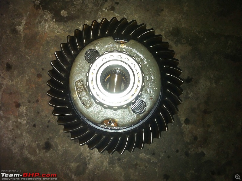

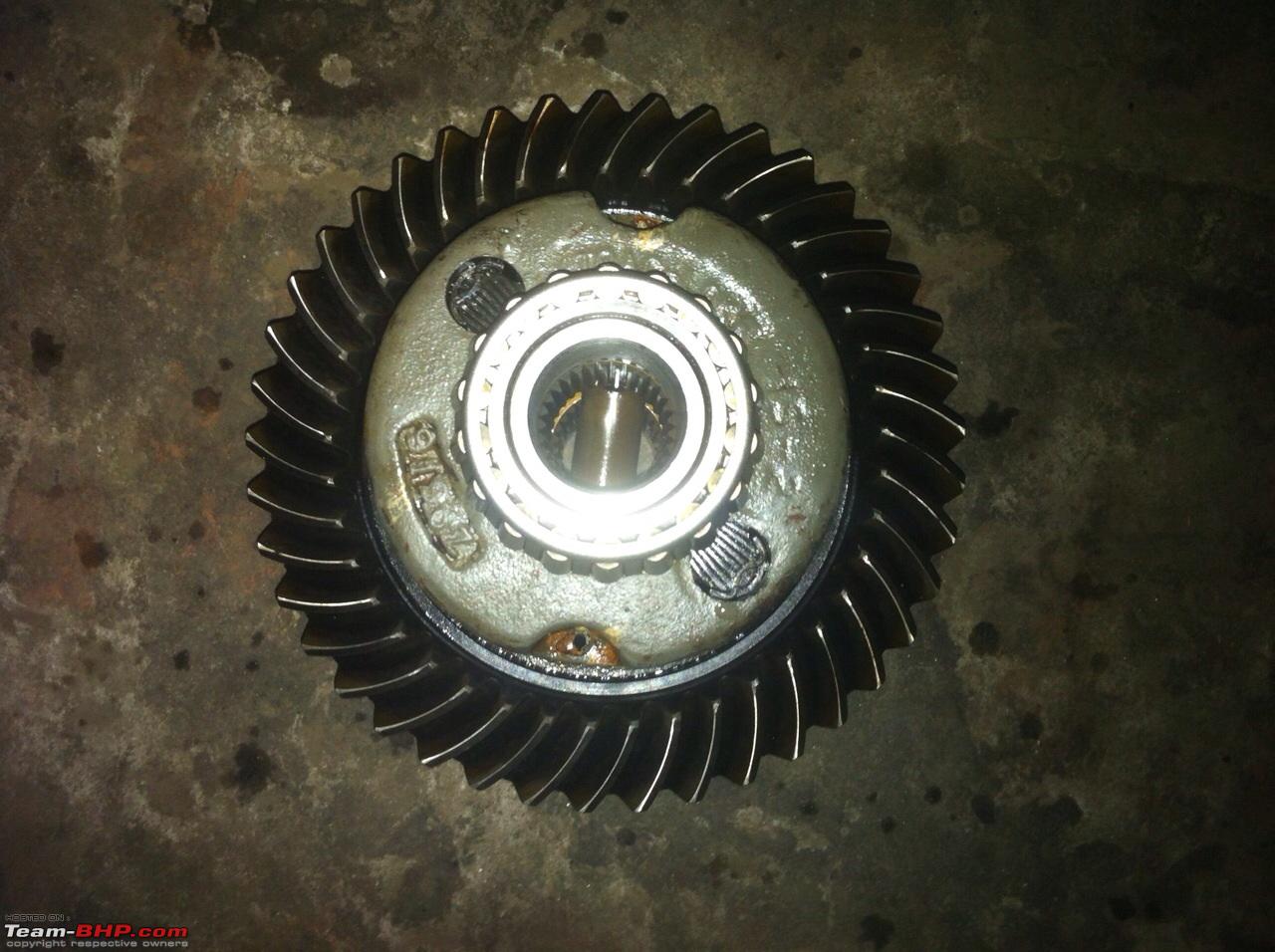

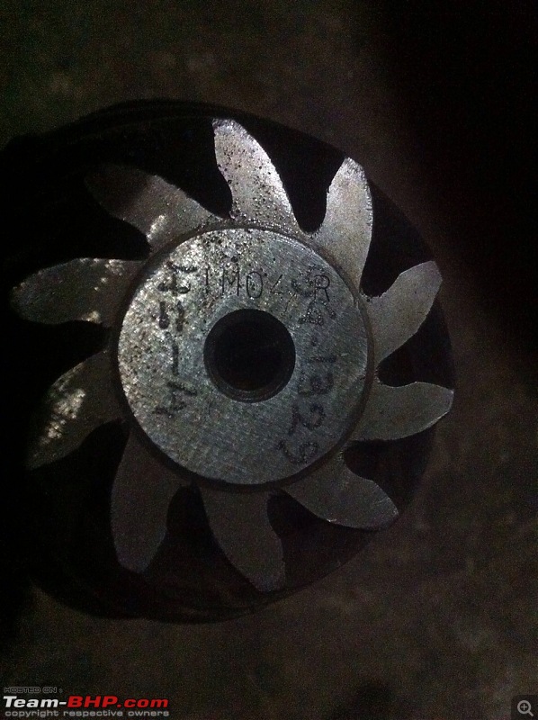

Hey guys!
I'm in need of urgent help for locating parts for the rear differential of my Dicor 2.2 4x4. The crown and pinion gears have worn out making grinding noise during >80 kmph driving. The rear differential is opened up at the garage but we've been unable to locate the gears despite a lot of effort. The LSD different has 41x10 gear set while the standard differential has 41x9. Suppliers and TASS are saying that 41x9 gear would do fine but my mechanic and myself don't want to mess with the OEM gear ratios. The 41x9 is easily available while the 41x10 is nowhere to be found!
If anybody has any information on availability of the correct gear set, please share it. I'm sharing images of the gears below.

I'm in need of urgent help for locating parts for the rear differential of my Dicor 2.2 4x4...
You can try/check with 99rpm.com. I have no personal experience of dealing with them though.
http://www.99rpm.com/tata/propeller-...x4-safari.html

Hey guys!
Its made by Spicer India in Pune :http://www.spicerindia.in/
send them an email and see
regards
