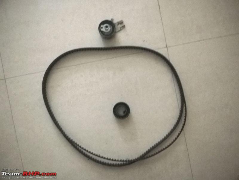

The Timing belt bug hit my safari while coming back from a long weekend just 40 Kms outside banaglore on the NH, luckily had a restaurant to rest and some roadside mechanic shops to help. This is the culprit below:
The Tata Safari 2.2L Technical / Problems Thread-tb.jpg
Outside the belt you can see the tensioner.
- There was a play found in the bearing which led to the belt to slip
- A part of the Timing Belt split into 2
- No damage to the engine otherwise
Called up Concorde who towed the vehicle and inspected the engine, repairs required a day.
I would recommend all owners whose Safari is 2012 or earlier to go for the F-Kit timing belt replacement asap or atleast get the timing belt inspected.
Mine was a D-Kit which lasted only 45K. Replacement Cost with Labor and other Misc charges is 16K.
There are few other things they found during inspection:
- Vibration due to injector, consulted CRDISamir, no change required, only the backleak pipes were replaced.
- Center link rod has play
- Turbo oil backflow pipe leakage
- Disc and brake pad need change
Does anyone know the life of front Discs, TASS told that they need to be replaced if under 21 mm
Also I need to fix the bugging air circulation which is there despite the flap closes (dont want to block the vent from outside), does anyone know how to access the flap itself, I will try to fix the leakage of air myself by padding it airtight, remember a post long time back talking about how to reach the vent but cant find it now.
dadu is offline   (3) Thanks
Old 11th October 2014, 13:49   #5706
Prowler's Avatar
Location: Madras
Posts: 800
Thanked: 1,416 Times
re: The Tata Safari 2.2L Technical / Problems Thread
Mine is dec 2008 and it was recalled in 2010 for some retrofitting - which included timing belt and a rubber cover for the ECU. I recently changed my timing belt, water pump and the front cover (they must have broken that when fitting) for Rs.25k
It included the routine service also - oil change, filters replacement and coolant change. My timing belt looked fresh and probably didn't require any change. But I didn't want to take a chance. My truck has just about done 27500 km in all these years.
The timing belt covers need to be replaced as part of the F-kit, the F-kit is supposed to be a fix for the earlier failures and currently runs on the storme, every part of this F-kit is re-designed to prevent failure, hence the new covers too.
dadu is offline   (1) Thanks
I got the F Kit at 40K Km some 2 years back as part of routine checkup.
The tensioner had uneven wear and unfortunately this was just after extended warranty got over but good to know still it is F Kit and they have not come up with G or H versions.
Dadu what were the symptoms on timing belt splitting and how you detected in time to prevent damage to engine ?
