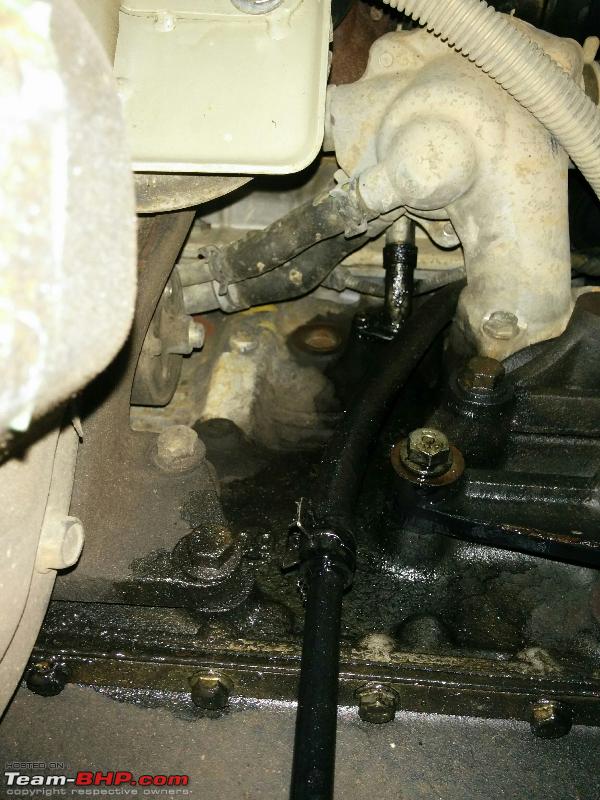

I wanted to swap the horns on my Xenon XT and so removed the slider at the front.
There seems to be some sort of oil leak.
Help please.

Pic angle is looking upwards from the front right lower wishbone.
