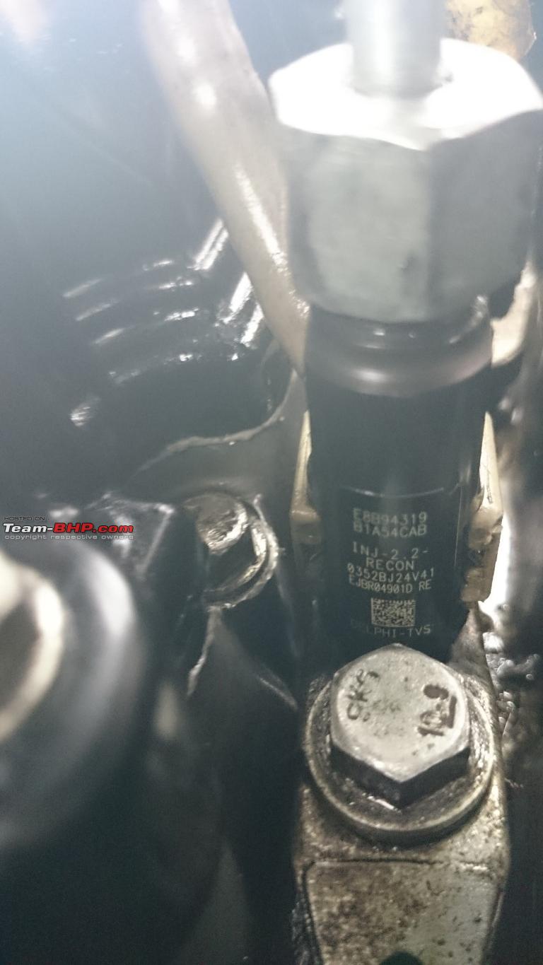

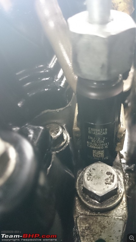

A mechanic tried to pass off a company reconditioned injector as brand new to me. Another friendly mechanic gave me the following information regarding differentiating a brand new injector from company reconditioned (aka recon).
1. The plastic storage cover on top of injector is yellow in brand new ones and orange in recons.
2. The recons have "RE" mentioned after the injector code on sticker (refer to image). This is not mentioned on brand new ones.
Please check this when going to buy new injectors from TASS or market.
The Tata Safari 2.2L Technical / Problems Thread-dsc_0042-medium.jpg
See the clear mentioning of RECON and RE on the reconditioned injector. Check for these when buying brand new injectors.

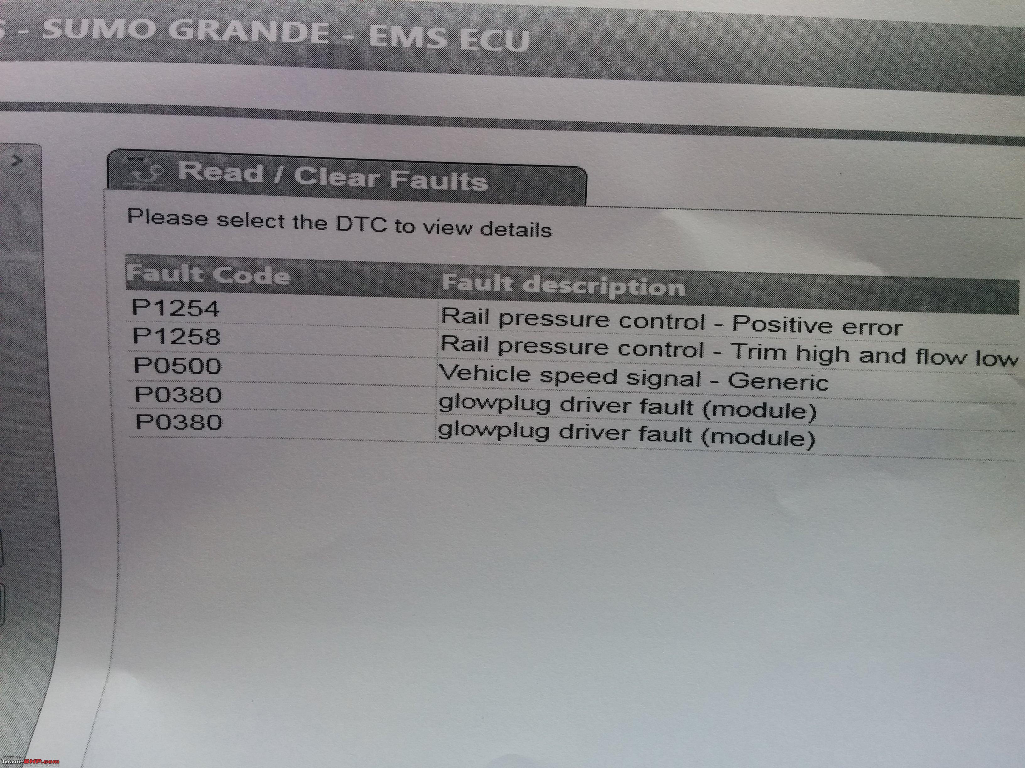

This isn't about the Safari, but since the Xenon is unknown to both the TASS, as well as FNGs, I'm posting my query here.
I had taken my Xenon to the SVC for clutch fluid replacement. At first they asked me to take it to the Tata commercial vehicles dealer (mine's an XT), saying that Xenon is no longer sold by the passenger section. Upon my insisting, the accepted the vehicle.
A couple of days back, a friend of mine had noticed the 'Check engine' light flash for a fleeting while. So, today I asked the SVC people to connect their diagnostic tool and check for any logged errors.
This was what the system threw up
The Tata Safari 2.2L Technical / Problems Thread-img_20150729_130158.jpg
As is the norm with SVC fellows, all errors were promptly deleted and dismissed as a random occurring.
Are they just that? Or, do I have to be concerned about any?
Car: Xenon XT 4x4 2010 pre facelift model
Kms run: 45000
Problems: super hard clutch, faulty tacho, rough engine note, body shudder at low speeds.
I migrated from a Punto, so some of the problems might be nothing, but with the super scarity of Xenon, I have no way to tell.
