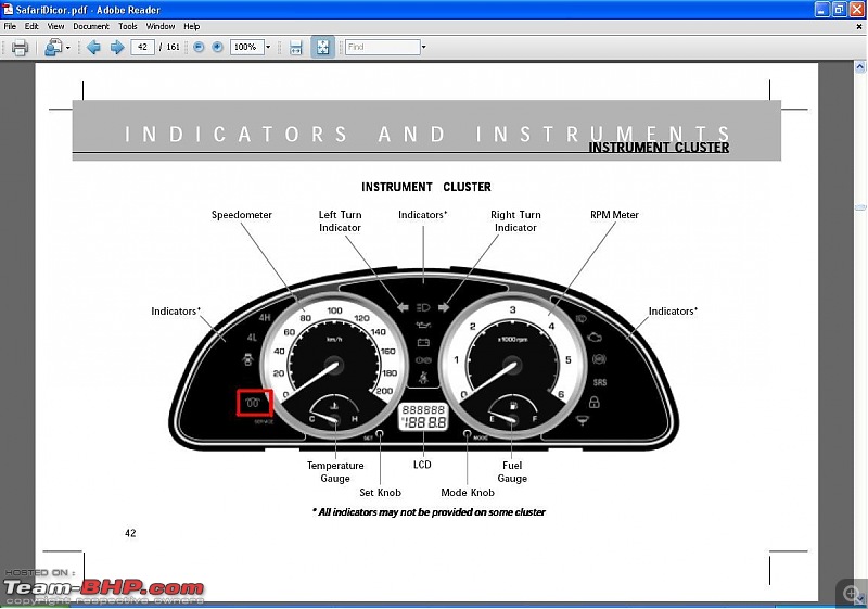

There is an indicator on the panel which is known as the
Water in fuel sedimenter Indicator
A quote from the dicor manual(2.2VTT)
This light indicates excess water accumulation in sedimenter which will come ‘ON’ when ignition is turned ‘ON’ and will go ‘OFF’ in 5 sec. When this lamp comes
‘ON’, water needs to be drained from sedimenter
immediatelyWhen the indication comes ‘ON’ the vehicle will run on
‘Limp home mode’ where there is a drastic reduction in the performance of the vehicle.
Till date I was assuming that this was the heating coil indicator meant for pre-heating in diesel engines.
Can some expert here enlighten me on my goof up?

Originally Posted by Alter_Ego (Post 1551600)
There is an indicator ... Water in fuel sedimenter Indicator
Till date I was assuming that this was the heating coil indicator meant for pre-heating in diesel engines. Can some expert here enlighten me on my goof up?
You need a course on "Teach Yourself Safari DiCOR manual in 24 Hours" :uncontrol
glow plug indicator is separate- its looks like a "heli-coil" comes and goes in a jiffy on ignition key on.
-BJ
-BJ
You are right.I just noticed the instrument cluster.Sorry for being silly.
Enlightened now.
but one more thing. Is the sedimenter indicator supposed to come on while turning on the ignition or not come on at all.
For me it comes up like all other indicators and then goes off as soon as I crank the engine.
And I guess my heating element LED is not working anymore.Just checked and that heli-coil does not even light up.Thats y got suspicious and mistook the sedimentor with the heating element.

Here is a better view:
The Tata Safari 2.2L Technical / Problems Thread-coil.jpg
Alter_Ego,
The sedimenter light will come on for some time and will go off immediately. The ABS light, if exists, will be the last light to turn off. Not sure of the SRS light, though! :)

The encircled coil indicator is not lighting up at all for me when I turn the ignition.
Need to report this to the TASS.
For that matter all instrument indicators in cars/bikes dash panel should switch on briefly when ignition key is turned on and will go off after some time a la Power-On-Self-Test (POST) mechanism on a computer. There may be some exception like battery charging indicator etc which go off only after engine starts runnning (alternator charging the battery) and left/right turn, high beam indicators etc which come on only when activated.
The mechanism which will affect engine (e.g. sedimenter, oil level) and dynamics (e.g. abs, srs etc) of a car will have a power-on self check. If they do not light up on ignition means indicator is faulty. If they come on a running car- they indicate a fault in the underlying mechainsm. e.g. engine oil light on a running motor indicates low oil level etc. Well this is how automobiles' instrument panel that I have seen so far behave... I haven't seen too many of these though hence, don't take it as a gospel :). The logic is simply to alert the driver that either some indicator is faulty or the underlying mechanism itself needs attention.
If your safari starts fine it is not a big deal. Looks like the indicator has faulted, but don't venture into sub-zero climate w/o glowplugs- push starting a 5000 lbs beast is not the best exercise for six packs. Have it attended to and pls update this thread what was wrong.

Originally Posted by Alter_Ego (Post 1551939)
Thanks Happy wheels.
No need to report to TASS :D
3.0 Dicor if I read correctly from your signature, doesnt have heating coils
So dont worry, just driveon the beast
If the coil image is there on the dash, it should be working. After all, it is just a heating coil from the days of the dinosaur!
I think he said it is not lighting up, and not it is not present! :D
(I hope I am right! else :confused:)
When it aint there it wont glow either :thumbs up
Hahahha... I then rest my case! If it ain't there, I will not contest the fact that it will not glow! :uncontrol
There are no glowplugs in the 3 liter. Normally large displacement engines do not require glow plugs
