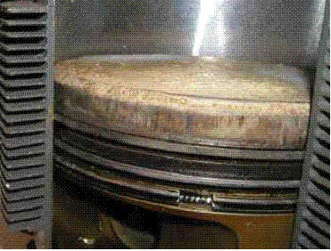

Piston Seizure and Cylinder cooling:
1. The cylinder must conduct enough heat to the atmosphere so that piston temperatures are below the oxidation point of the oil film and not so high that the piston:
  • looses strength
  • oxidize oil in the piston ring groove causing stuck and broken piston rings
  • suffers excess thermal expansion and seizes in the cylinder barrel
  • or develops hot spots that cause preignition.
2. Temperature is distributed evenly around barrel circumference so that barrel retains shape and doesn’t suffer from uneven circumferential stress (Hoop Stress).. and poor piston ring contact. If the barrel is unevenly cooled for any reason then you can see the circumferential cylinder head cracks. Achieving an even temperature distribution around the barrel is the function of the cylinder baffles/cooling fluid circulation around the block and is not an easy task for an IC engine designer. Using a simple baffle arrangement in a motorcycle engine, cylinder barrel temperature increases from the baffle entrance to the baffle exit as the air going thru the baffle heats up.
Piston Head is a large heat absorbing surface
Heat Path - how the piston cools itself
Piston Dome > Piston Rings > Cylinder oil film > Cylinder barrel > atmosphere
Since combustion temperatures exceed the piston's melting point, the heat energy in the piston is absorbed by the rings. The rings then transfer this heat into the cylinder walls and eventually into the surrounding air/cooling fluid.
Blowby of combustion gas past the ring belt ("ring leakage") prevents heat flow from rings to barrel. Piston temperature increases causing oil in ring lands to oxidize, thicken and eventually causing ring sticking.
Miyer is offline
