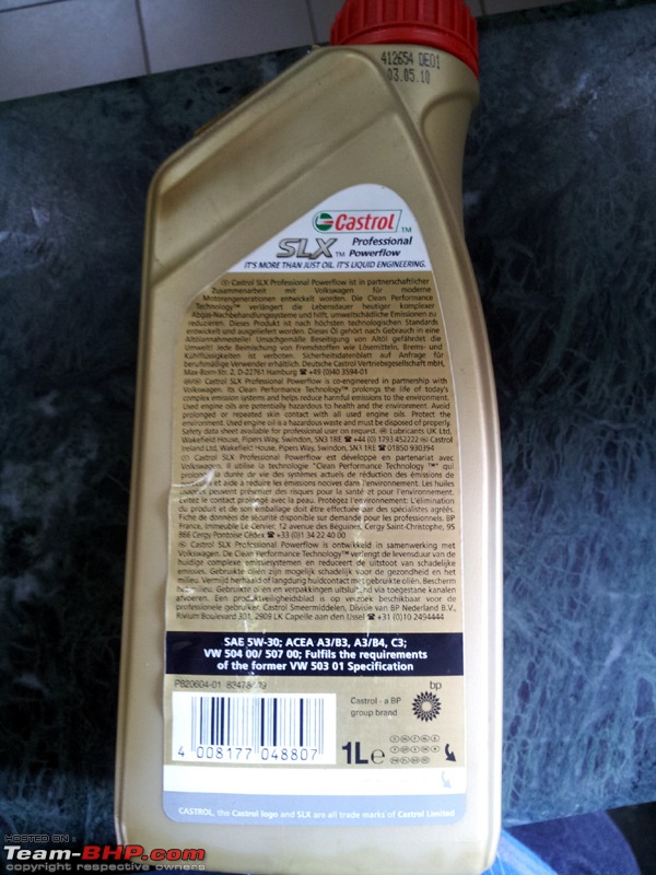

Skoda uses, Castrol Magnatec Pro. Try to get that. I have been using Mobil -1 since I picked up my car., huge difference in smoothness and vibes. Switch and try it and please let me know. Tried the fully synthetic, Shell Helix Ultra, but, was not satisfied. I agree, that these oils don't meet the VW specifications, 505.00 but then I am using them and no issues what so ever, have driven 70 k Kms till date all with Mobil 1
Originally Posted by drrajanvr
Skoda uses, Castrol Magnatec Pro. . I agree, that these oils don't meet the VW specifications, 505.00 but then I am using them and no issues what so ever, have driven 70 k Kms till date all with Mobil 1
Try Mobil delvac 1 instead of Mobil 1.
It's a better oil for diesels. You'll be amazed by the smoothness of the oil.
IMHO the castrol magnatec oil that VW/skoda uses is semi- synthetic one and doesn't meet 507.00 grade required. Try google for more info.
If your car is under warranty get a oil can from the service centre to be on a safer side.
The Castrol Magnatec Professional OE oil used by Skoda ASC's is in fact Fully Synthetic Oil and not semi-synthetic and meets 502 00 and 505 01 standards. Also find enclosed recommended engine oils from Skoda -
Skoda Laura: Problems & solutions thread-castrol-magnatec-professional-5w40-oe-oil.jpg
Skoda Laura: Problems & solutions thread-superb-engine-oil.jpg
Castrol Professional Powerflow SLX meets 504 00 and 507 00 standards and is also available at the ASC's on demand but is a 5W30 grade oil.
Skoda Laura: Problems & solutions thread-superb-1st-checkup-17_09_2012-oe-oil1.jpg
For Indian conditions 5W40 is a more suitable oil.
