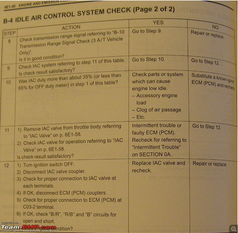

Now, for the basic checklist, pages 1...
... & 2.

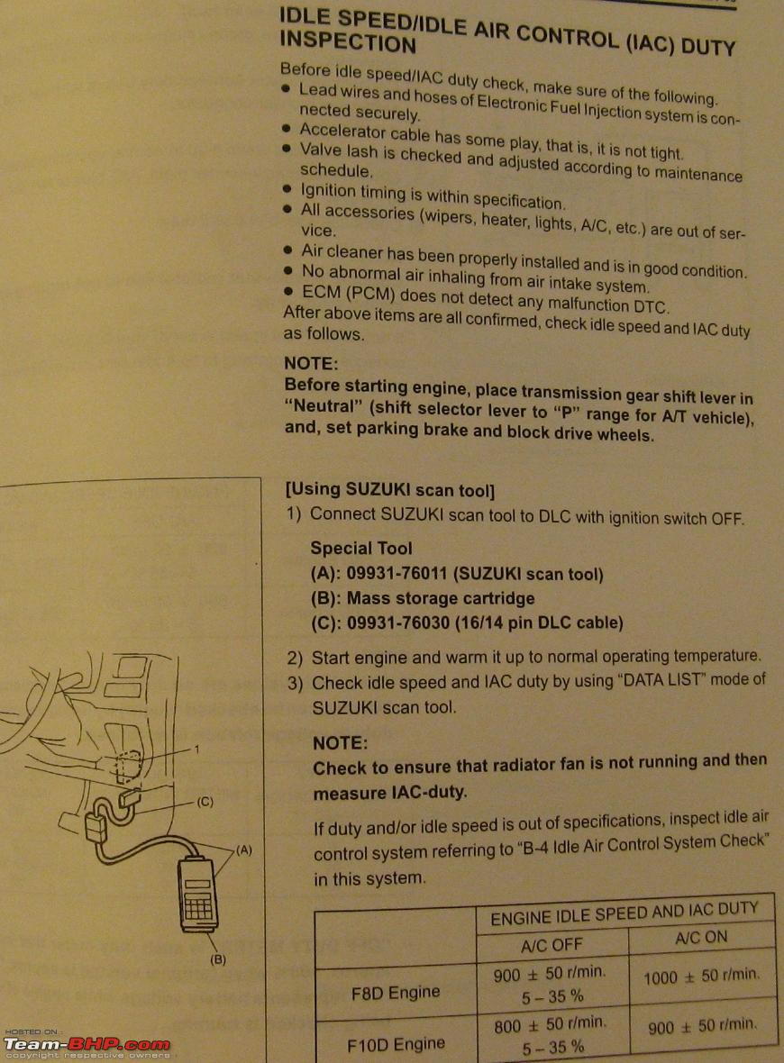

The next bit is regarding the procedure to check something called IAC 'duty'. First is with the expensive Tech-2 I guess.

The service manual & parts catalogs are great if you're interested in knowing your car. Thankfully, the service manual for Maruti vehicles is no state secret (unlike a few other manufacturers), your regular dealer or service-center should be able to help you with getting a copy. For the Alto, the parts catalog is 300 INR & the service manual is around 800 INR.

thanks a lot SRINI, the manual is of great information. i am just wondering why do MUL A.S.S people dont follow the procedure from the service manual.
i remember when the first time i got my throttle body cleaned the first thing they opened was IAC valve, whereas it is written in the manual that the IAC should not be disassembled. they also cleaned it thoroughly with CARB cleaner spray. i hope it hasnt caused any problem to the IAC valve.
the procedure of checking the IAC functioning for 60 ms was also never done. they also told me that IAC cannot be purchased seperately. i have to purchase the whole throttle body.
now i have to observe my alto for idling issues for a day or 2 and confirm.
one thing i noticed when i removed my PCV valve was that there was rattling sound when i shaked it. in the manual its written that if it rattles its fine or else replaced.
i think i need to couple a TECH2 again and check the IAC duty.
