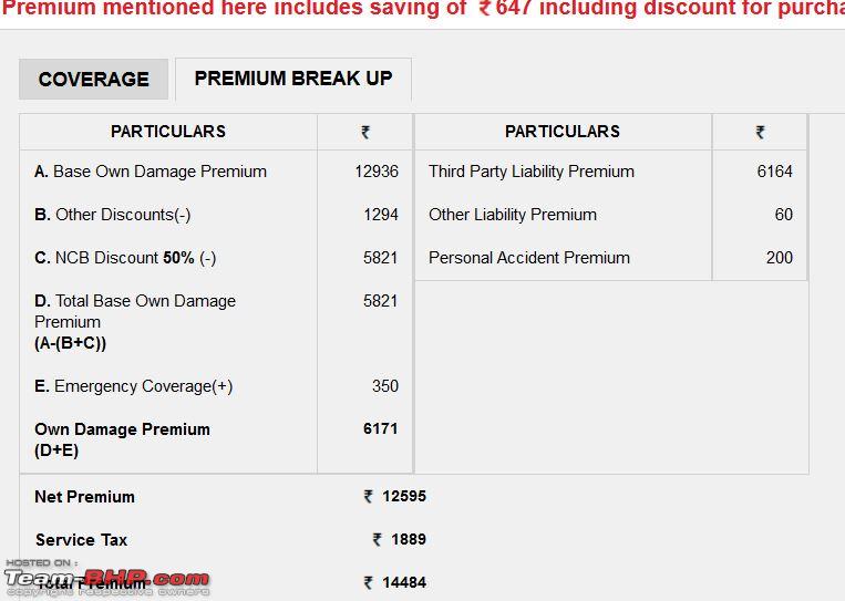

I was trying to renew the policy (last date is 31 May actual) thinking i may save a few thousand rs in the process. My last year own damage premium was around 6.4k and now it has been hiked to twice on HDFC website taking the premium to be paid to 14.4k. Last time i had paid just 11.4k. I called up HDFC and they said premium is hiked since age of vehicle has crossed 10 years and hence it has become twice. Frankly i am not buying it but is this true or just a cock and bull story.
Honda Civic : Maintenance, Service Costs and Must dos-premium.jpg
