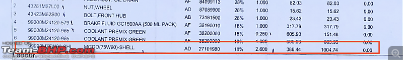

After a lot of searching for 75w90 oil for my SX4 Diesel, I left it to Maruti.
talked to the Hella guy (aftermarket division), and they have distributors only in Bangalore (Yeshwantpur). I connected with them, and they said they could deliver via Dunzo in Bangalore but not outside, as they do not have any e-commerce channel.
I needed this in Varanasi.
Boodmo had this in stock, but the delivery ETA was more than two weeks, and they had two prices for the same 2.5-liter bottle.
There is also oil from ZF, but its packaging is different from the international market.Outside India, they categorize it as Fluid 8 or Fluid 9 and similar, but here on Amazon, it's labeled as 75w90.
https://www.amazon.in/gp/product/B0D...H6DT6C9YJ&th=1
There is no product info on the ZF India site.
https://www.zf.com/india/en/company/company.html
This is what they store and use to fill all Maruti vehicles.
It does not specify whether it’s semi or fully synthetic.
Attaching the PDF and link for the same.
https://oilgrease.co.in/spirax-s4-gs-75w-90-shell/
https://birenenterprise.com/new/wp-c...75W-90-PDS.pdf

Originally Posted by ankitsharma View Post
There is one more brand available in the market. Rowe. Though it is an overkill for Maruti still if you really want to use 75w90, it is available
Thanks for this, this may help others who are still looking for synthetic 75W90 .
But this supports both API GL4 and GL5 so not sure if its suitable for GL4 uses.
There are oil available from Hella, Abro, ZF and I think Bosch too.
But getting them from genuine distributors and at desired location is challenge.
I guess we can trust Boodmo for Hella oil but I chose not to.
I am okay with Maruti's Spirax oil for now. I was worried that they have only 80W90.
Now the oil is changed it should be fine for at least 2 years
With the price charged for oil + GST, its almost at same price as other synthetic oils from Hella and ZF
