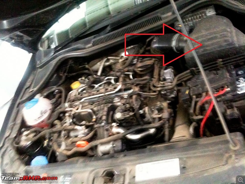

I've been through some of the very dusty parts of Maharashtra and Karnataka recently and feel my car's air filter may benefit from some self cleaning. Car is yet 5K KM away from servicing (Vento TDi).
Where is the air filter located in vento and in general otherwise? Is it something we can easily remove, clean and plug back? Is it advisable to clean it on our own before serviving from service station?

The air filter is located near the engine air intake. You will see a square/rectangular plastic box which has clips on it. From this plastic box, you will see a large cylindrical pipe which enters the engine block. That plastic box holds the air filter element. If you undo the clips on this box, and open it up,you should see the air filter element. It usually has an orange coloured upper part. It is easy to remove, clean or replace. Don't know where exactly it is located in the Vento (but should be within easy reach), as i do not own one.

2parag,
The red arrow shows the air filter. Open the box, remove the filter carefully, use low pressure compressed air to blow away the dust, box it back & you're done!

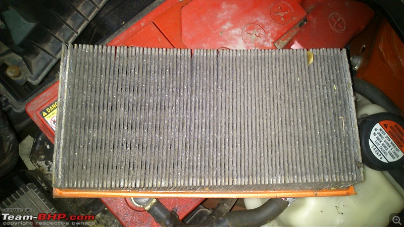

Yesterday, while admiring the Tbhp sticker on my car's bonnet I was struck by the idea of cleaning the air filter and good bye to procrastination. As it is a paper filter element, I didn't had much to do. . Btw, its a Ritz Diesel.
The screws holding the air filter box were pretty loose and thanks to the ' take it easy' attitude of MASS
The odo shows 18500 kms and it's the original stock filter. Never replaced so far and had accumulated a lot of dirt. Look the color. A pictorial guide to cleaning air filter at home (Page 2)-dsc_0244.jpg
Managed to pull a lot of dust with slight tapping and vacuuming
Did a small test drive and Voila! The engine felt refreshed and revvs are more free now. The turbo kick has also gone up. Now planning to change the filter every 10k kms instead of 20k as specified by Maruti.

I am not sure about Ritz petrol whether it has paper or sponge type filer element. But just make sure that you never wash the filter. Just tap, blow or vacuum the dust off. Once my friend did the same with his alto. By seeing the dust on its sponge filter he went on to wash the filter with water and detergent. What happened afterwards was the sponge changed its shape and the engine ran all over the tacho. Went straight to MASS driving like a maniac (no other way as the engine has gone crazy) and replaced the filter
