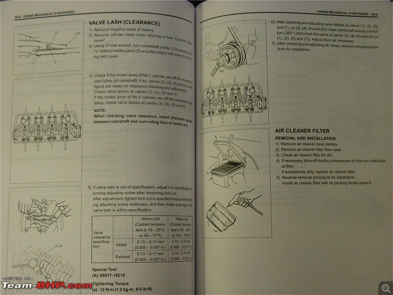

anyway here are the data. Its of F8B. Its 0.13-0.18 mm. 0.005-0.007 inch. Ideal is somewhere in between like 0.006inch. F8D is also same.

Well, thank you for the help. Funny, that the valve clearance is the same as with the old engine. Unusual. You are absolutely sure?

Good for you ! The F8D & F10D are simple enough that most of the maintenance can be done at home, if you have the right tools that is
Yes, SirAlec's right, for the F10D...
F10D/F8D Engine Valve Clearance Adjustment-f10d_valve_lash.jpg

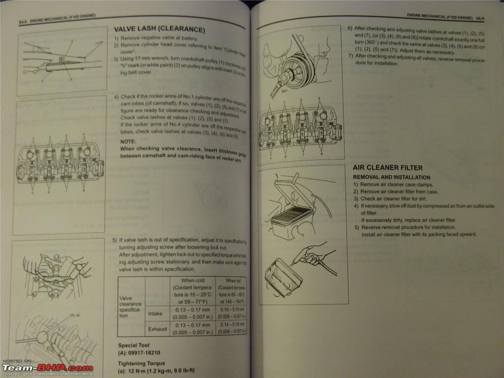

And for the F8D...
F10D/F8D Engine Valve Clearance Adjustment-f8d_valve_lash.jpg
