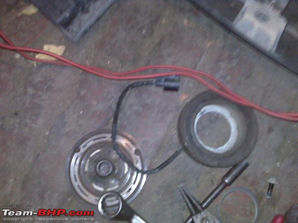

Hi all,
called up service station guys and they said if its anything in compressor whole unit would need re-placement, i asked about any availability of spares in case its compressor, they point blankly denied, I decided no way for official service station now.
Went to my old car mechanic, who's gem of a person, he sent me along his gy to A.C. repair guy, he figured out it to be A.C. compressor Coil gone bad and is over-loading the circuit, he didn't had the spares and asked me to check back 2 days later, but heat was not yet over, Gave Budget Rs.3300
including the GAS recharge which would be needed if he repaired.
Again went to my mechanic, he referred me to the Best A.C. Mechanic who was previously not available on phone and i drove to his small garage, he examined the circuit and then said its Definitely your compressor coil burned out, he even put some meter in place of fuses to test then drove some parallel wires to Compressor and it did some cooling but not normal.
He then asked his guys to open the front bumper, and some units, brought another coil which and said this would work fine, he gave me a budget of
guess what, Rs.1100/- wow.
In a hour and a half my A.C. was cooling much faster than before, No more Fuse blowing up, and of all, he liked L.E.D. lights so much he asked me to write the specs for him, make some temporary wiring diagram for his Bike, and i did so, also gave him one 12, LED light which i was having under Bonnet. he gave me Rs.200 further discounts, of All, it costed me Rs.900/- to get it back working, and a lot of mental pain.
Attaching few pics where you can see the round coil with small wire.
One point i would like to seek advice from helping Team-BHP Pals, don't you think the A.C. Cooling pipe (the one shown in attachment named "Cooling.jpg"), which brings in the cold air to blower should be insulated with FOAM or other heat proof material, In my santro the pipes inside the Bonnet are exposed to Heat of the Engine, however touching them gives a Nice COLD COLD Feel.

Sorry Guys, forgot the last pic,
Do you think the Cooling Pipe should be Insulated as we have in SPLIT A.C. Outdoor unit connected to indoor unit with FOAM Insulators.
