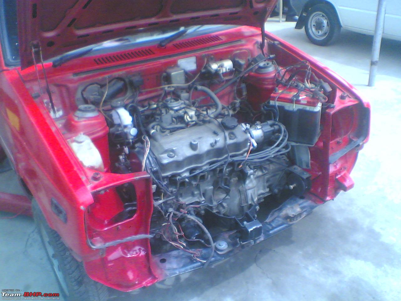

I have heard two people doing this. these are the images sent to me by him long ago. I lost contact with him now though. Only problem he was facing was the driveshaft alignment.
Other being a russian dude i met on a russian forum. WHo plonked a Zuki GTi engine at the back in a Suzuki Maruti (thats what its called there). He is all over the youtube.
