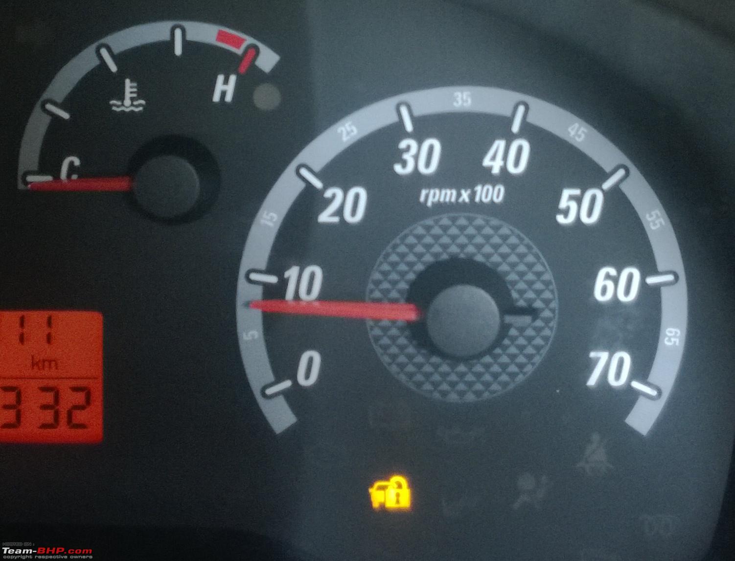

Punto self-test indicator glowing
I've noticed that the self-test indicator in the instruments panel of my Punto has been glowing intermittently for the past few weeks.
I consulted the manual and all it says is this:
Indicates that the the system is performing a self-testfor instance, for a voltage drop. If the indicator persists, contact the Fiat dealer.
Does anyone know more about this indicator? I noticed that the indicator comes up mostly when I cold-start the car and disappears if I turn off the car and turn it back on.

Re: Punto self-test indicator glowing
Iam not sure what it exactly means in Punto dashboard. But for Maruti vehicles that icon points towards Immobilizer system.
How old is the battery? The same sign used to glow in my T-jet's MID along with "Airbag Failure" alarm. The culprit was battery and it was changed under warranty.
It should be related to battery, get the battery voltage checked before the cold start and after the end of daily run. If the battery is getting drained, then either the issue must be with the battery itself or other electricals. A visit to FASS might be required then.
Its not a self test indicator but an indicator showing that the Car protection system failure which mean that the car's immobilizer is not functioning. If the indicators stays on for long, visit FASS.
