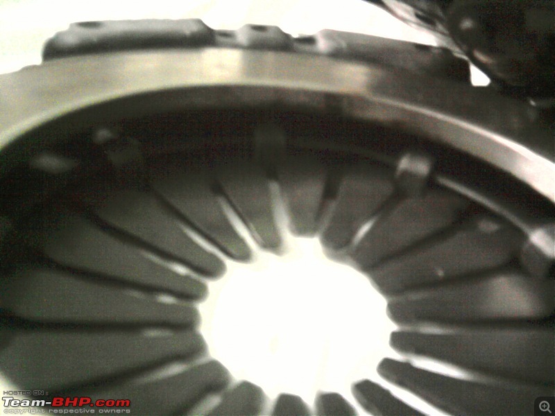

My Alto Lxi is 13.5 months old, and has clocked 11900 km. Today I heard a 'thud' from the engine compartment while driving in 3rd gear, and the clutch almost immediately tightened up. (It was a good level road, and no debris on the road to hit the under body of the car). The guy at the workshop says the pressure plate is gone, and I need to replace the Pressure Plate + Clutch.
The clutch plate and pressure plate is healthy, but the diaphragm spring has been bent at two points - clearly a case of manufacturing defect, as per the workshop guy. (He is an authorised Maruti Service, but not my dealer). He says it's very difficult to get warranty for clutch related parts, but I would like to try anyhow. I paid 3000 Rs at the workshop, I would like to forward a complaint to Maruti. Any pointers on how to do this? (The workshop guy has promised to help me if he is asked by Maruti).
I would post pics of the clutch plate + pressure plate + diaphragm spring tomorrow.

...... The clutch plate and pressure plate is healthy, but the diaphragm spring has been bent at two points - clearly a case of manufacturing defect, as per the workshop guy.
Posting a picture of my alto's Diaphram Spring, which is bent at the top two fingers. The picture of the healthy clutch plate is also attached, which shows that the failure is not due to driving style, but because of manufacturing defect... Somebody advise me on forwarding the complaint to Maruti,

Jinojohnt @ U will get the pressure plate under warranty, mine was changed at 12 thousand km including the clutch plate FOC under warranty, pressure plate as i was told does come under warranty in a new car atleast. Seems like a clear cut case of manufacturing defect.
Ask them to change it under warranty and also check clutch plate, flywheel for uneven wear. I would advice to change the entire set

Your clutch looks good ., atleast on the picture . LOL .
pressure plate also looks good . hmmmm .

It actually depends. If your clutch has "burnt" then you will not get warranty whether the car has done 1000kms or 100000kms.
However, if there are other problems(like hydraulic system fault, or release bearing etc.,) then you will get warranty.
Better show her at service center
