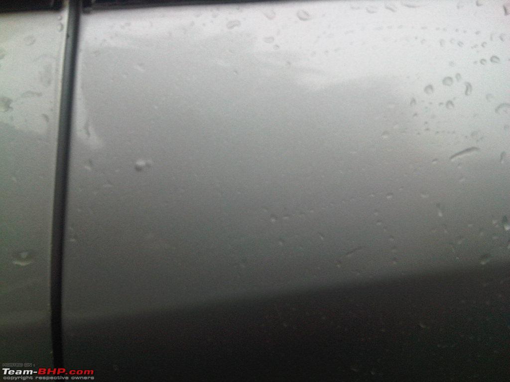

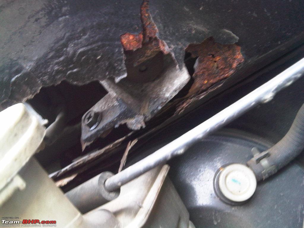

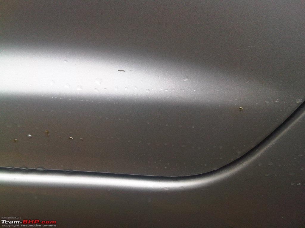

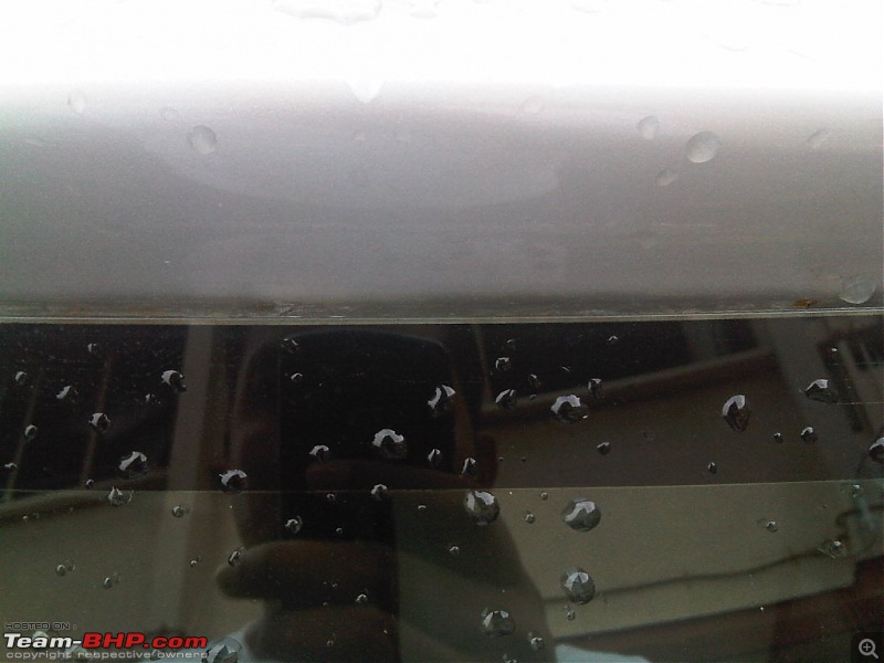

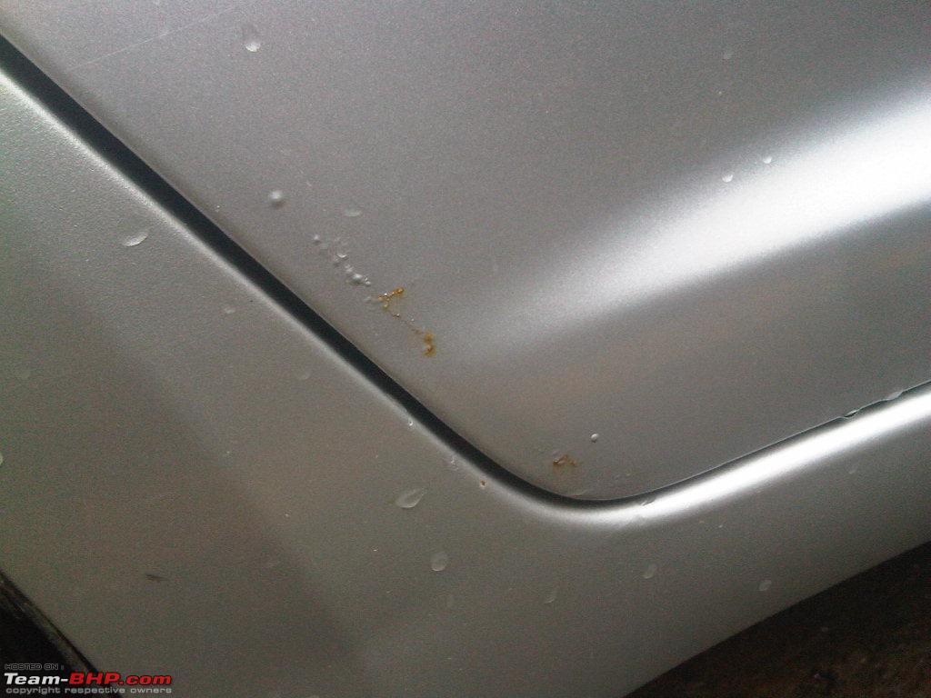

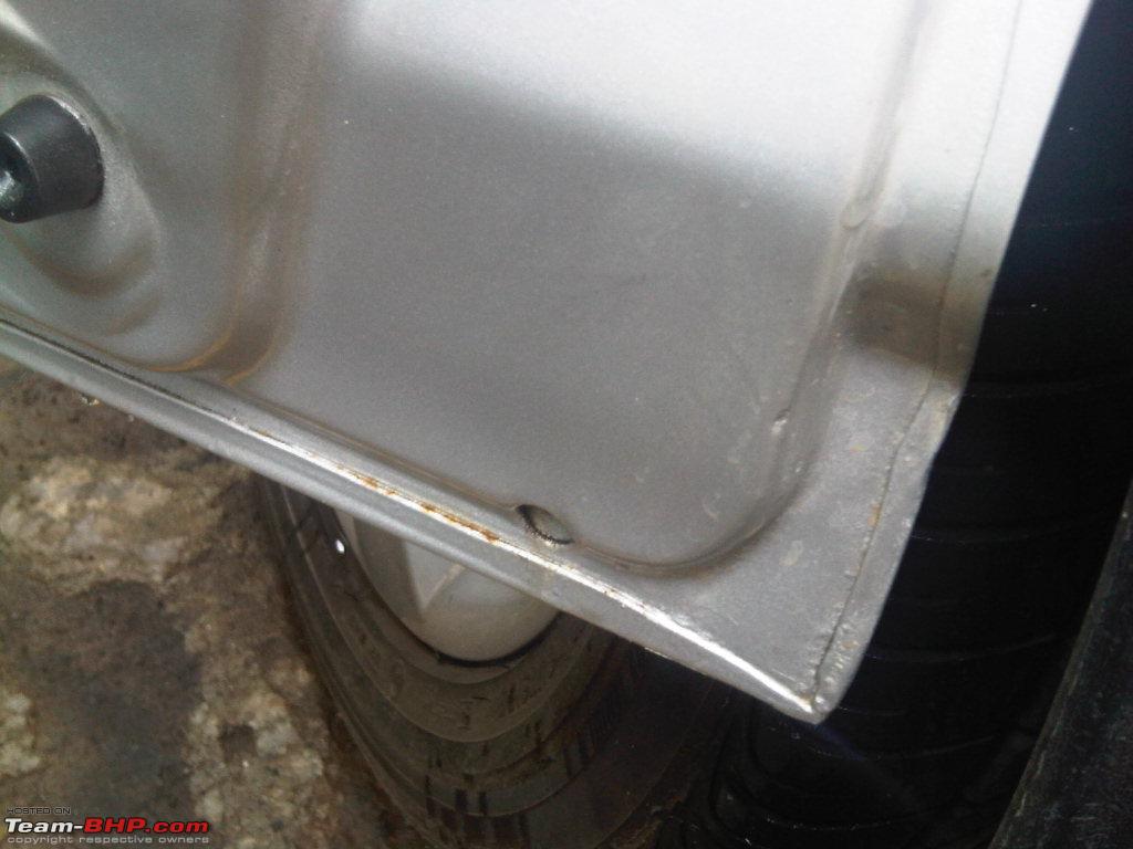

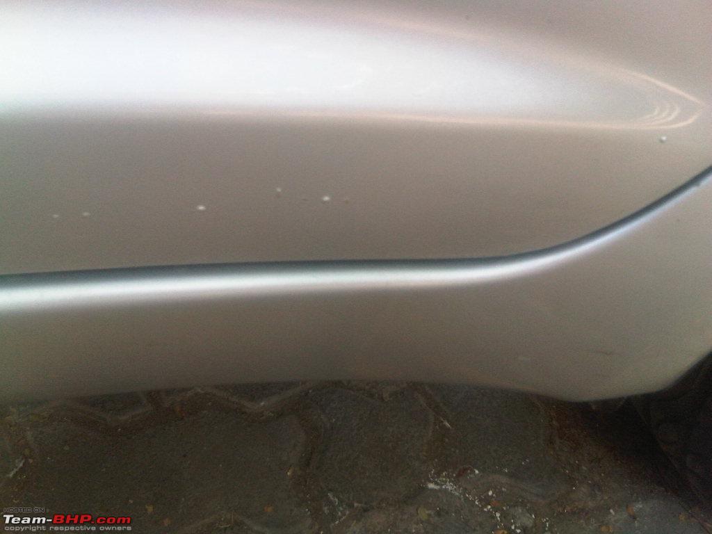

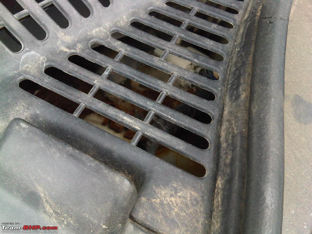

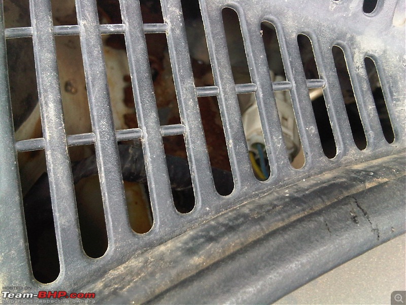

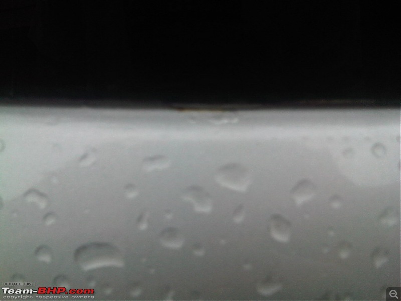

I had given my car for a paint job on 17th May 2010 for work on the affected areas which had paint bubbling and a bit of corrosion. I took delivery of my car on 24th May 2010 and everything seemed fine. But around two days ago, i.e. 08th June 2010, I got a shock as I found that bubbling and corrosion had started again. I was really sad and frustrated with this as the problem which used to take around 6 months to reoccur had surfaced again in just 15 days!!!
I have brought it up with Maruti again (this must be my 4th time now) and have written a very strong email to Mr. Pankaj Narula - EO Service and to the guys at Vitesse at Andheri West. I have again given my car to them today to have the job rectified. I am fed up and do not know what to do anymore. Also another issue that has cropped up is the panel below the windsheild (it can be seen through the plastic ventilation at the base of the windsheild) is totally corroded on the driver's side only which has led to a small leak in the car from under the dashboard. So I have asked them to change that panel too. Apparently it will cost me around 3500 including labour. I think that is too much. What do you think?
I also happened to meet my neighbour of mine if he is also having corrosion issues on his cars as he currently owns a Toyota Corolla & a Maruti Alto. He has however owned Marutis in the past like the 800, Zen & Baleno and was also using a 2008 Swift Zxi and he said that all his Maruti vehicles showed signs of corrosion in just 2 years of ownership. His Corolla has just completed 2 years of ownership but has no problems so far.
Now, do you think that Maruti is the modern Premier Padmini as the Premier Padmini was known for body corrosion every 2 years. I remember that when my family owned the Premier Padmini around 15 years ago, the car needed a paint job every two years!!
Anyway, I have attached pictures of all the affected areas on my car. Do let me know what you guys think and how to proceed further.

Please note these points:
1. After a cash wash(Using a pipe/Mug as many People Do) please open all the doors and wipe the beedings. If left un-attended then this is what happens !
2. When giving car for Water-Service, please be with the car to over see the work. Make sure they don't spray water inside the car as many service station personals do, to clean the door panels.
3. Always keep the car clean from heavy dust like mud and debris, such elements attract moisture and initiate the rusting process.
4. The frequent cleaning method used should be only with damp cloth.
Mr. Epic, you live in Mumbai. A sea-side city, where such rustings are prominent because of the Humid and Salty environment. For the minor rusts on the door, you may apply Brake fluid over them as a temporary option. After a few more months, after the monsoon you may go for a touch-up and Single paint.

No properly painted and sealed vehicle should rust just because of being near the sea. Lots of people, world-wide, live near the sea.
Epic, you can see some of the rust experience I have just been through with my Swift on this thread Do check that section under the windscreen wipers.

Thats the result of a bad paint job! Nothing to do with the seaside fellas. Mind you, this is not the only car in his building as he Epic has mentioned.
