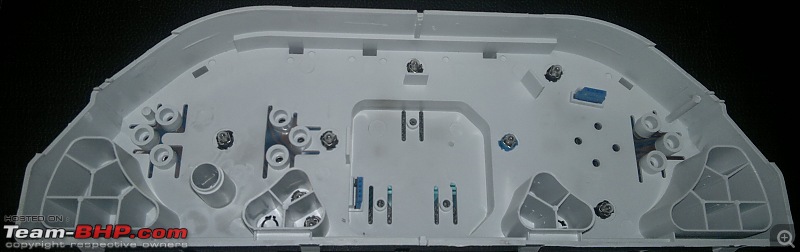

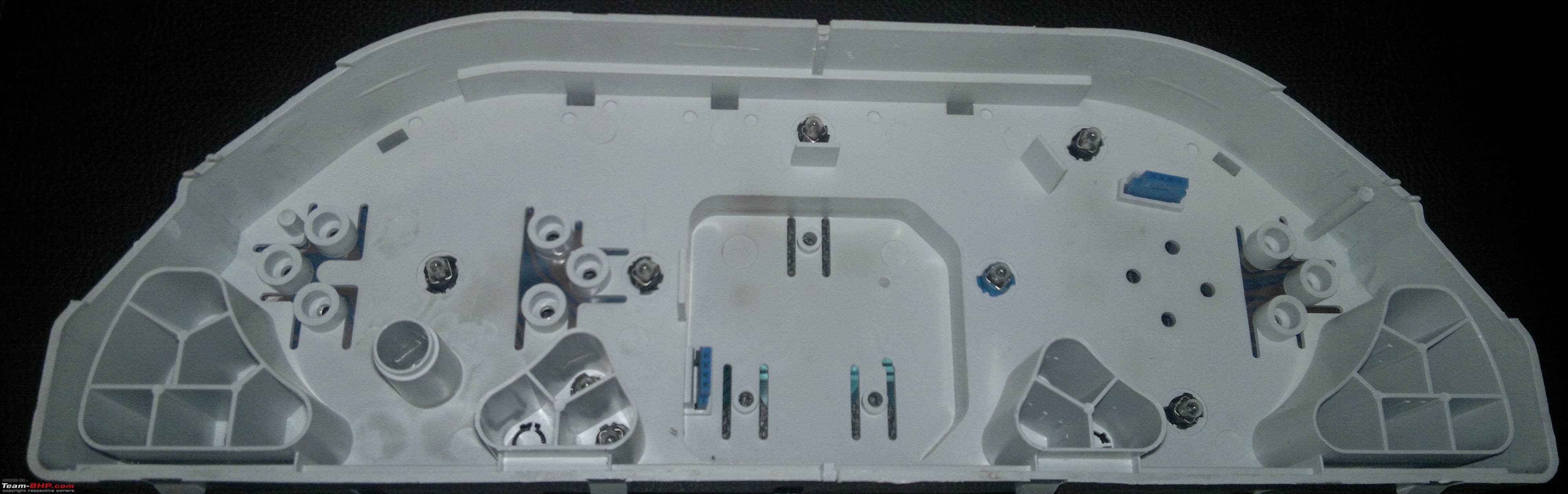

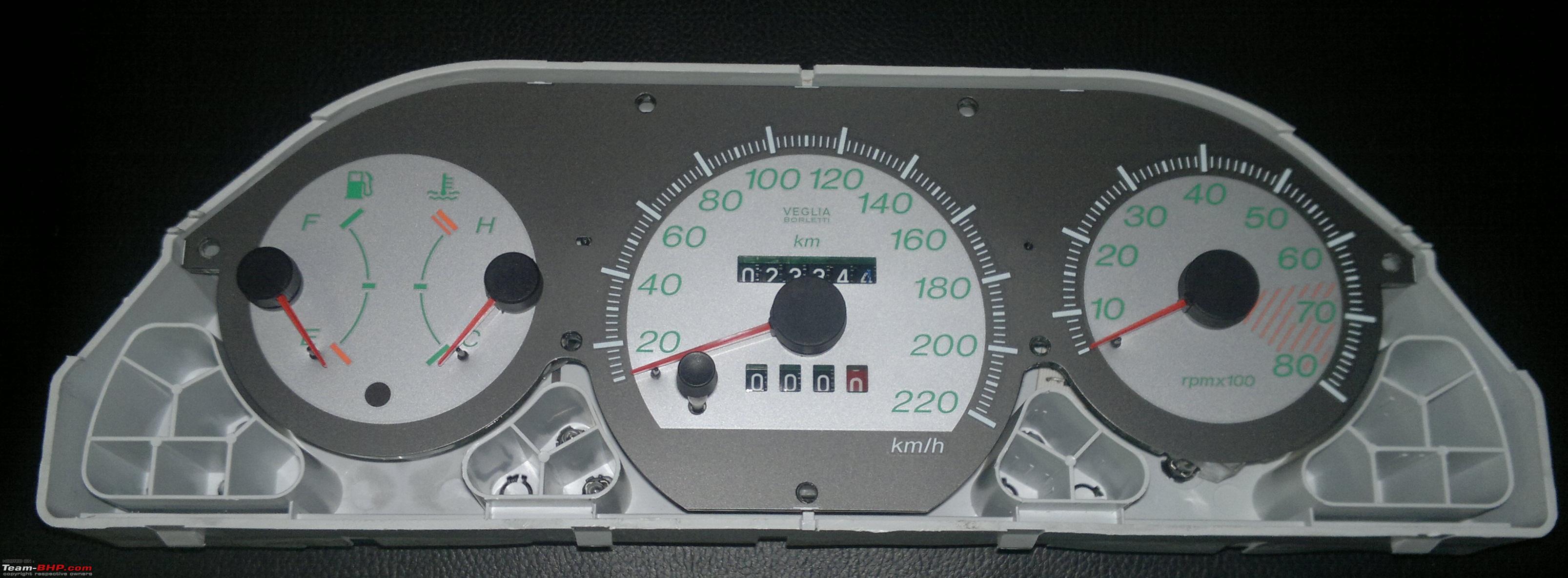

I had the exact same problem with my Palio Stile. The entire cluster works fine accept the odometer and tripmeter. After learning from TATA sevices in Goa that the price for a replacement is 16K I decided to go ahead and open the cluster hoping that it was just a 'loose connector'.
Well turns out it is something more than that. As some of you have rightly pointed out it has to be the stepper motor that drives the numbered wheels that has gone poof.
I think I will have to go to Mumbai's Chor Bazar or Kurla to find a replacemnt from a scapped vehicle. Trouble is getting to Kurla from Goa is a whole day and a half wasted in travelling.
Anyone has a good contact in kurla for such replacements. Do let me know. Oh yes, I have attached some pics I took with my N8 while I had opened if u guys would like to see.
