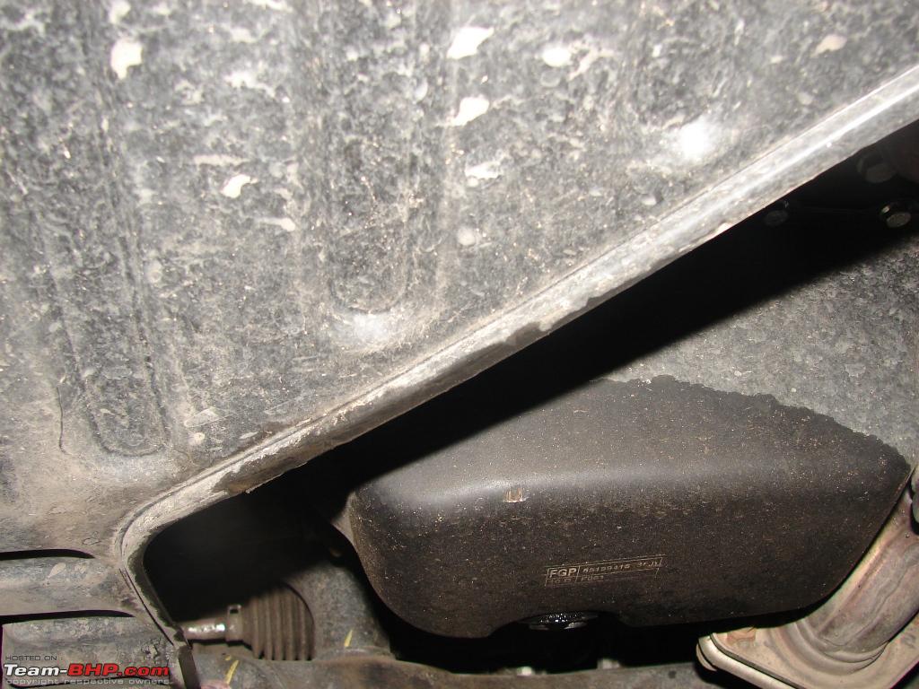

Today in the office parking I noticed that there was some kind of leakage from the engine. The liquid patch on the ground that I noticed after 10 hours of parking the car was about 10-12 times of what the patch size is in the first picture.
Liquid Patch created after 3-4 mins of parking the car
The place where the leakage is happening from
Distant view of the oily/greasy part of the black box where the leakage is happening
Pic from the top of the engine in case anybody notices anything different, I didn't
Another Pic from the top of the engine (a little close up though)
See the liquid in the middle of the pic. Looks like water + oil or just water or just oil, don't really know!
I have a long road trip planned from Delhi to Udaipur this weekend and not sure if I should cancel that and get the car checked instead or is this some kind of usual leakage. I'm assuming no leakage, of any kind, would be normal.

It's not normal - get the car checked soon before undertaking any long drive. Not fully sure, but looks like the leak is form the plug of the sump ?
Did you get the car serviced/oil changed recently ?
Has the oil level gone down after the leak ?

Looks like a leak from the Oil drain plug washer.With this kind of leak,your oil level will show negligible drop and may not even show up on the dipstick.Suggest you drain the oil into a clean pan,refit the plug with a new washer and then fill back the oil

That black box is your oil sump! Take it to the MASS and tell them this leak is happening after they changed oil during service. Let them drain the oil, replace a new washer and refill with fresh oil in your presence. They should do it free, but don't mind paying if they insist. This should be fixed asap.
BTW did the sump hit anything on the road, by any chance?

Exactly my thoughts looking at the pic. Possibly an underbody hit on bad road / hump or some stone flying off from the tyre and hitting a weak spot.

Now that you mention this, while driving from Green Park to AIIMS, about 2-3 weeks back, there was a muddy patch where the path below the tyres of the vehicles was sunk in and the road in the middle was risen. The lower body of the car did brush against the risen path. This could be due to that.
That sounds bad. Inform the MASS about this and let them do a complete inspection. I don't think the damage will be to the washer alone. If anything serious, be prepared to go for an insurance claim. But attend to this pronto!

This looks bad do not waste time going to local mechanic.
Also at the M.A.S.S just say that oil is leaking from sump and let them diagnose and get back to you with estimate and reason.
I do not understand why Suzuki did not provide protection plate for the sump.
In this picture the engine cover plate leaves sump exposed. Penny pinching from Maruti leaves big hole in pocket of customers.
