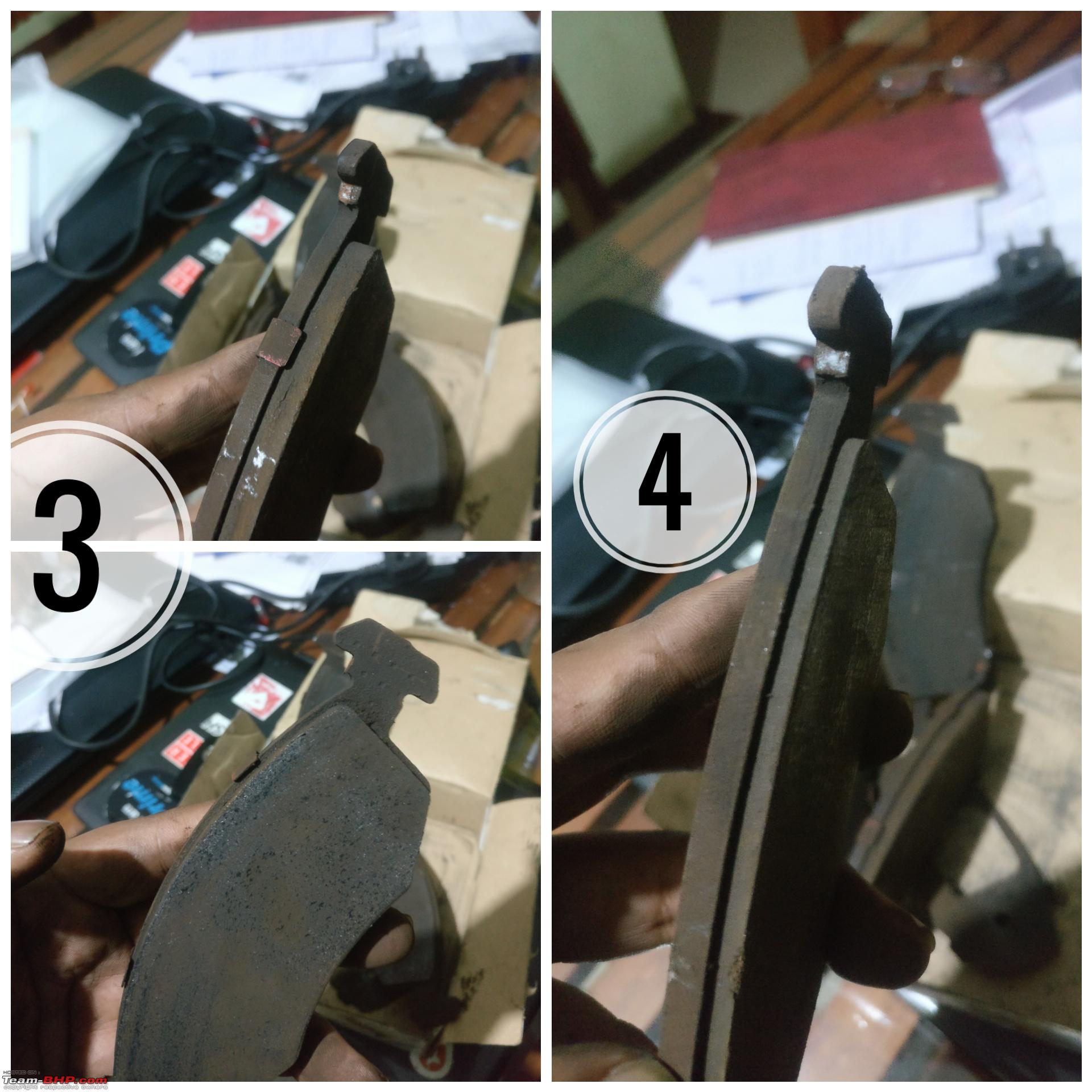

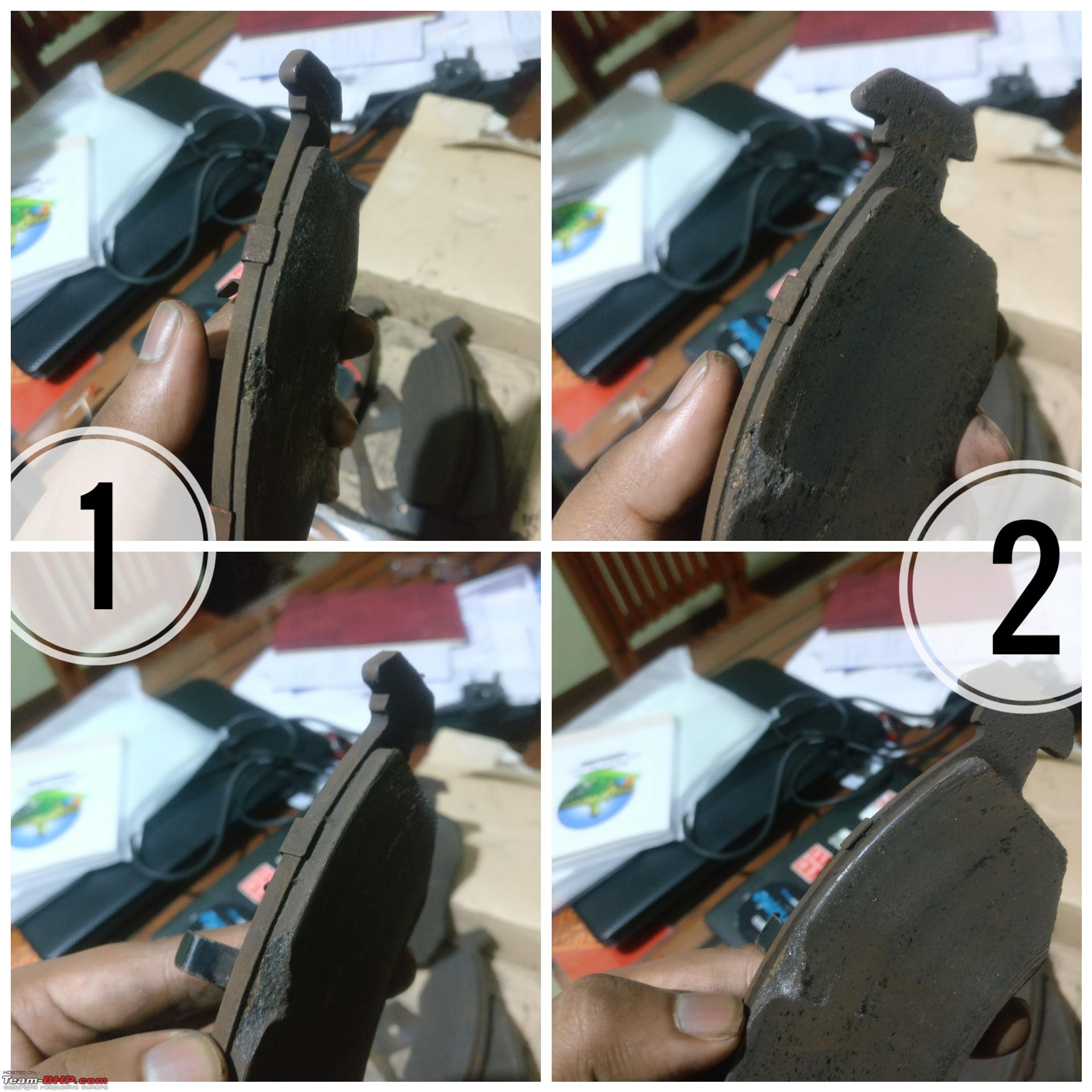

I drive 2009 Fiat Punto MJD. Changed to Brembo pads and rotors at 1,86,500 km. During my recent visit to Fiat Service Centre at ~2,47,000 km I was advised to change the pads, which I did.
I'm little worried about the chipping off observed in the brake pads (labeled 1 and 2 in the pics). Believe it's not normal for Brembo to undergo chipping.
This was a repeat purchase from Amit of Laxmikant Enterprises, Mapusa, Goa. I mailed him a month back seeking his inputs, but haven't heard from him.
PS : My earlier set of Brembo pads (with Fiat OE rotors) lasted roughly 80k km.

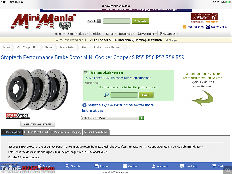

Here is some more jazz about the brakes.
My Cooper S is now 8 years old and in its life its never had the disc rotors changed. They were skimmed once in their lives and that was in December 2019. But frankly the rotors are scored and whatever one may do on the lathe, it is not worth skimming them twice or thrice and all. It is a powerful little car. It needs its proper stopping power too.
OEM BMW Cooper JCW Sports upgrade brake discs are available via the BMW dealer. These are drilled and slotted. The size is perfect even though these are an upgrade. 294x22mm as per stock standard. (Front) The front ones cost 15000 each. The rear are the plain ones and cost about 5200 each so that is fine. So we are talking about 40K. And the front ones have to come from Germany and will take 40 working days give or take. The rear ones will arrive in 10-12 days I believe because they are plain stock standard.
Of course I already have the BMW Cooper OEM Brake Pads and the Wear Sensor in stock.
Else, I can order them off a site I use called Mini Mania in the US. There are plenty options available but I like the same drilled and slotted type from an aftermarket company called StopTech. Size is correct 294mmx22mm. Here the front ones cost 110 USD each and the rear ones 80 USD each. Shipping costs about 160 USD by FedEx International Priority which will get them here in a week or so. So effectively this will cost more or less the same. The gain really is the time.
The OEM Cooper Brake Pads and Wear Sensor will be used here also.
So what I am considering is as follows;
Buy the StopTech Front Rotors from the US and get them shipped in to India in a week or 10 days.
Buy the rear stock disc Rotors from BMW India and get them home in 12 -15 days.
This way, get the best of both worlds and save time too.

Quick Update.
Upon consultation with two automotive experts whom I am privileged to be able to ask, both have clearly said NO to the perforated, drilled and slotted front disc rotors for my Cooper.
These are meant for track days and speed runs and are really not for standard use the way I drive my car 95% of the time. Hence it is better to go with the plain vanilla standard ones is what I am advised.
Apart from that, there are various YouTube videos and other information resources which clearly state that the slotted and drilled disc rotors chew through brake pads at the rate of knots as compared to the normal discs.
So I think I ll just stick with normal discs and save my self some ten grand and of course set myself up for a longer life for my brake pads.
The other good thing is that the normal disc rotors, front and rear, can be ordered say tomorrow (Monday) and I believe I should have them in my hands in 12-14 days so there is a clear gain in terms of time as well.
