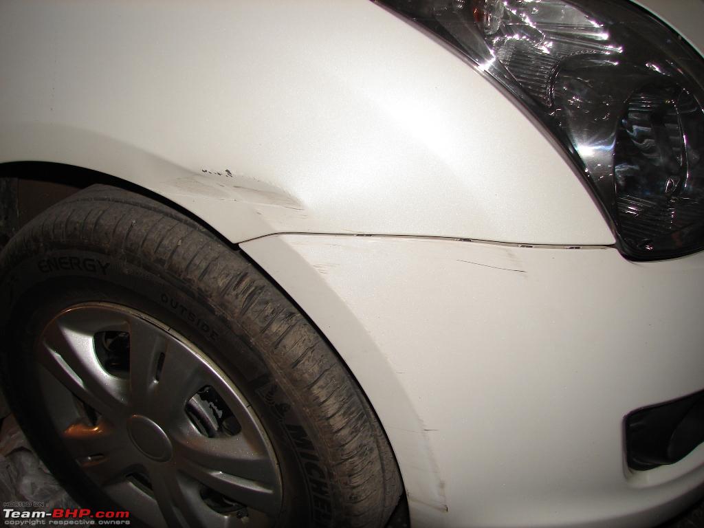

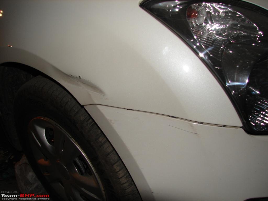

My parked swift (white) was hit in the office parking today. (This isn't even the right emoticon, I feel like crying). The right fender has bent inside and the bumper has a long scratch and dent (somewhat, not sure). Paint has come out from both the areas. The bumper also seems to have more gap now from the fender because of the hit.
1. Would it be wise to claim insurance and get the bumper repainted and fender repaired/replaced or should I get the repair and paintjob done without reporting in order to save on No Claim Bonus?
2. I think I can go to Pandit & Co. for the repair/repaint job but still if one can share an estimate percentage of how much more they charge than the dealer's paintjob? As in, 20%, 30% or 40% more?
3. What is the approx cost for such a repair and paintjob if done by M.A.S.S.?
4. Since the bumper also has a dent (slightly) is it repairable or do I have to get it replaced?
5. Is it possible to just get bumper repaired and painted partially? I know it'd look odd but maybe after a few days (with all the tar and road dirt sticking on it) it might look in line with the rest of the color? Same question for fender, would it be repainting for the damaged area only or the entire fender?

For body work, a professional body shop is always a better idea than the MASS.

Very sad to see such a thing happening to your baby. Don't worry about color matching. Most A.S.S body shops does it in a very professional way. Bumper damage is not too much IMHO. But the fender needs a complete restoration. My opinion is to go for A.S.S and go for a claim if the total amount comes around 8K or more.

Vikram, going by the pics the damage isn't worth taking the car to someone like Pandit & Co. for paintwork. Try Dry Denting, many people there in Sujan Singh Park (Khan Market) who can get the job done.
A) Entirely your choice. The dent is quite shallow, can be easily repaired to new.
A) Not aware of the quality of Pandit & Co. Why should they charge more than the dealer ? IMO, totally unjustified, considering their lower overheads. They should be atleast 20% lower than the A.S.S.
A) Approximately 3,500 ~ 4,000 for the whole fender. Bumper similar price range. Around 1,000 for the spot repair.
A) Can be very easily heated & repaired, clips can be easily fixed back as long as they arent broken.
A) You are lucky with white. its a color which hides imperfections beautifully. You can get away with just doing a spot painting as the are dented is small. However, get it done at the A.S. S where you get your car serviced. If you know the service head, speak to him personally.
I would stay far away from local paint booths, they will give you all types of assurances & most probably end up doing a shoddy job. They will make you run around & the price difference will not be worth it.
In my experience, penny wise pound foolish is the paint job at local paint booths.
You have Maruti's excellent customer service, in case of any issues, you can turn to them for assistance too !

This can be buffed, take it to mass during your routine service and ask them to apply rubbing compound and buff it up, they will charge you 1 rupee. Getting the whole bumper/fendor painted for these small things will make you literally live with the paint shop guys especially in delhi. Just ignore small dings. BTW my paint shop guy charges me 1500(i am a regular) per pannel, he does all this in dupont.

My white Swift zxi had a similar dent (no scratch) on almost the same spot. Got it done from SST's recommended mechanic for 500 bucks, there were few scratches on the front and rear bumper too which were touched up (kalam / hand job) gratis by Maruti Service Masters at Okhla when the car was left with them for two days for rectification of a problem with the rack and pinion motor.
Pandit and company do an excellent job and so do Multan Motors. Nonetheless for such a small dent it is not worth footing their bills with or without insurance claims and bearing their usual nakhra regarding the time taken etc. Otherwise for bigger dents/scratches both of them do a far superior job than any company A.S.S. body shop across the board. Their charges are in line with what a M.A.S.S. body shop would charge for any given body panel. A cousin of mine gets his cars / SUVs bodywork done at Pandits for a fraction of the cost compared to what the body shop of an A.S.S. for the big 3 Germans would charge him.

@nirmaljusdoit: Thanks for the comprehensive answer, I hope I can get the paintjob done for only for the damaged parts.
I thought of dry denting but can't really live without getting a paintjob done too.

Some guy in Kotla (near Def Col, that's where I stay). I got the ORVMs and Door handles painted white along with rims blackened but the paintjob was just not worth the money spent (2k for all).

I usually go to Kumar Automobiles in Okhla, not sure if you've heard of them. Still I think I can get the denting part rectified from SST's recommended mechanic too (once I know who & where he is). Can the same guy do the paintjob as well?

The reason I go to Kumar is because he lets me be with my car during the service, allows me to tell his guys on how I want the 5 tyre rotation to be done and doesn't mind if I ask him not to wash the car (enough swirls already) but clean the underbody and engine bay. I could try MSM but not sure how they would reach to such things?
I just realized that Kumar's also has a separate place (about 30-40 mtrs ahead of his service station) dedicated to denting/painting, its a huge hall and one of the brothers supervises that. I could try them also as I have to get my car serviced this saturday so I might as well get the dent fixed.

Well MSM will not let you into the service area and as for getting things done your way depends on the SA you get when the job card is opened. Some of them note down the minutest of instructions and ensure that things are carried out per the same. Though for a majority of them well the less said the better. As for washing all of them are more than happy to not wash the car and touch the interiors, given the heavy rush of car that they get on a daily basis. They run 3 shifts over the weekends to cater to the large number of vehicles that come in. Anyhow even I get only the under body and the engine bay washed.
Since you are comfortable with Kumar and the repair does involve painting, getting the job done their would be better. I trust they would do spot painting instead of spraying the entire fender, as that would make the fender stand out compared to the other panels.
