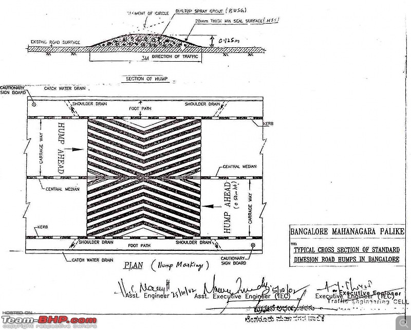

Angled speedbreakers may be a good idea. But , even ensuring that the regular speed breaker construction follows the guideline is a challenge. Simply because the vast majority of speed breakers in the country are illegal - i.e. they have been constructed without following the due process and construction plan - and more often than not due to the pressure put on road construction workers by uneducated and blissfully unaware local interest groups such as RWAs.
Attached the actual guideline and construction plan stipulated by the Indian Roads Congress.
Guideline for Speed Breaker:
  1. Central Height: 10-12 cm; Shape: Parabola; Width: 3.5 metres; Length: same as road width.
  2. Road humps should be painted in a 'V' shape and illuminated by solar cat's eyes (solar cells embedded on pavements/road that reflect sun rays and glow in the dark) to make them visible.
  3. The humps should not be more than five metres away from the junction or the intersection.
  4. Two signboards, one at 20 to 30 metres and another 10 metres away from the hump should be placed for the commuters to know about the road humps ahead. Intrusion of tree branches should be prevented.
  5. Road humps should be put up only on the main roads and not on the cross roads.
  6. In ‘rumble strips’, (humps that have around 5 to 10 strips together), the width of each strip is to be one foot and the gap between each strip, one foot.
These two points are essential. Most humps I've seen are 15-16cm tall and 1.5-2feet wide! Unmarked SB's are invisible, especially when there is a tree canopy overhead.
If this this the actual guideline, I have never seen a single speed breaker following this guideline completely. On the other hand, majority of speed breakers violate every point given in this guideline. I guess the road construction workers misread it as DON'Ts instead of DOs
