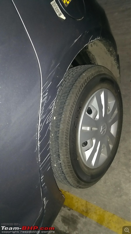

But destiny had something else written for our car as on one of the Monday's my friends and I visited Theur Ganpati temple and came back to Magarpatta city and while parking the car in office parking, I scratched it by trying to park straight next to Pillar. I regretted my decision but the damage was done. New car, first car of the family and entire left side was scratched and the rear left door got bent. Unfortunately we had team dinner that day and everyone wanted to go in my car and I had to inform them that the car cant go as it is in bad condition. I skipped dinner and took the car to Maruti showroom, claimed insurance and got it fixed. They took one week to return the car but the car came in perfect condition. The rear door was replaced and the front door scratches were removed.
Review: 2nd-gen Maruti Swift (2011 - 2017)-rearscratch.jpeg
Review: 2nd-gen Maruti Swift (2011 - 2017)-rearscratch1.jpeg

After almost 6 years, another incident happened where I took a left turn and a bike came from behind and hit my car. Rider was not injured and it was my mistake as I could not see him in the rear view mirror properly. It scratched my car's left back door but no one got injured and I was thankful to God for that.
I have experienced just 2 major issues and one minor key issue in last 7 years that too because of my driving faults, otherwise the Swift is running perfectly fine.

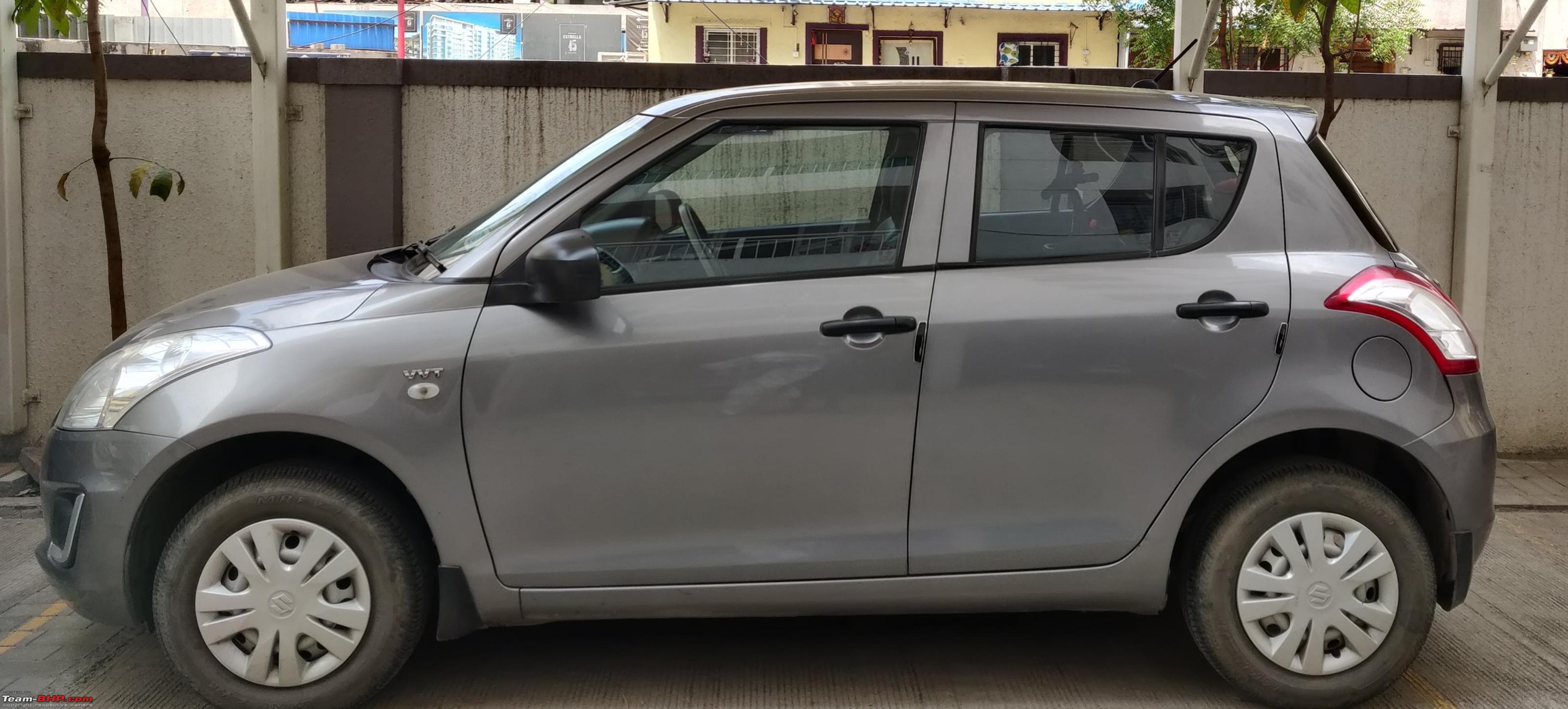

At our Pune apartment:
Review: 2nd-gen Maruti Swift (2011 - 2017)-swiftside.jpeg
