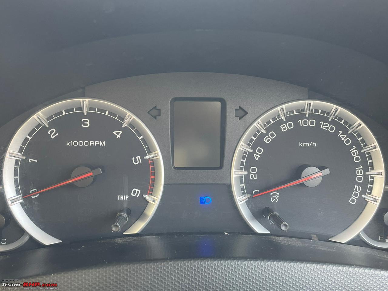

Dear esteemed fellow bhpians,
I own a 2011 diesel swift type 2. She has done 1.7 lakh kilometres as of now. Recently a small electrical issue seemed to pop up. One of the tail light brake halogens gets burned out frequently. There is no specific side. I have changed the bulbs 3 times myself. Got the bulbs from MASS.
Now the high beam indicator on the dash is always ON. Even when the car is turned off. Attaching an image of the same.
Does anyone have any idea why this is happening.
You might want to get your headlight wiring checked as I think your high beams must have fused. It can also be a short in your instrument cluster wiring as seen in the video below
PS: I have replied to your query on r/CarsIndia as well as I’m assuming that’s you as well due to the same username.
Dear esteemed fellow bhpians...Now the high beam indicator on the dash is always ON. Even when the car is turned off. Attaching an image of the same.
Does anyone have any idea why this is happening?
Faced the same issue with the high beam indicators in our 2013 Swift VXi Type 2 for a while before it mysteriously disappeared for no reason.
So... I'm also kinda curious if anyone knows the reason behind it or if it's just an unknown feature
Apparently it’s a short inside the speedo console. At least that’s what the guys from MASS said. They don’t have a provision to fix it other than replacing the console. They said there are people who remove and fix it. I did see a video on YouTube as well. I just haven’t got it done yet.
I still have the issue. It’s mostly consistent now. For some reason it turns off when I drive for some time and turn back on after sometime.
So,we have gotten the headlamp control switch repaired because it was stuck in the ' parking lights on ' position and I decided to take apart the old one and tinker around with it . As I was having my way with it and taking the case apart, the parts encircled in the image below fell out of it and now I have no clue how to put it back in it's place. Can anyone help me with finding their respective locations? The spring mechanism of the assembly is now out of service after these parts fell out. Even reverse searches using the part number and oriparts for diagrams didn't help.

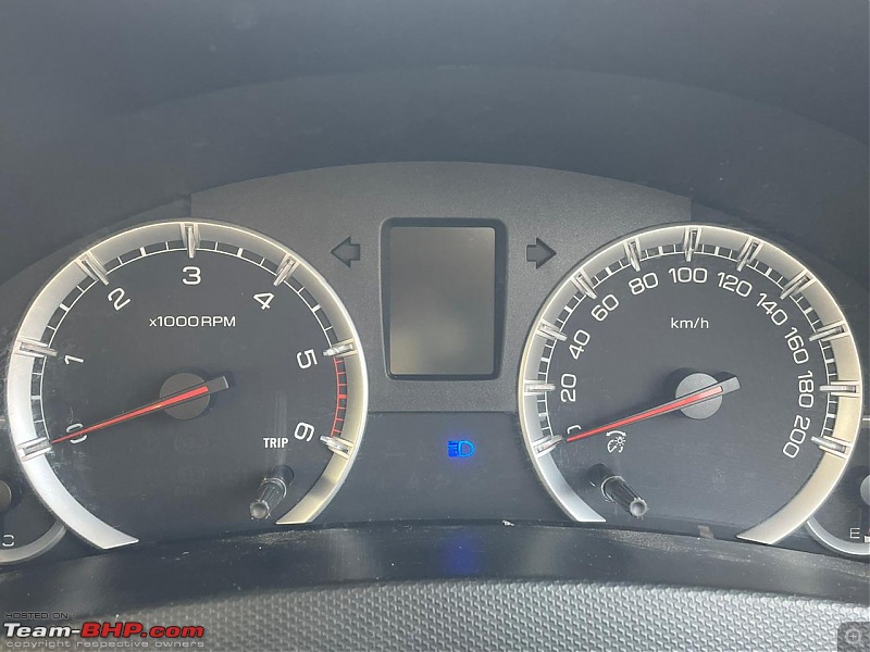

So,we have gotten the headlamp control switch repaired....Even reverse searches using the part number and oriparts for diagrams didn't help.
Attaching the image below since it didn't get uploaded earlier

After having been parked outside near the road for a while, I noticed that the idle RPM was around 1000-1250 instead of 750-1000 RPM usually observed ( without and with A/C switched on).
The car also refused to accelerate beyond 2000RPM and 40km/h.On trying to climb a slight incline ( unpaved ground --> main road), the car stalled 4 times and it was a bit tricky to get the car moving. On moving to 1st gear and lifting off the clutch, RPMs would drop down from 1000-1250 to ~ 800-600,sometimes nearly stalling before springing upto a 1000 RPM again.We decided to get home ASAP since it was almost time for the service centre to close and we wouldn't make it in time.
The issue was temporarily fixed when we revved the engine in neutral upto 4K RPM after warming up and then putting the car in gear.
Today, we brought the car to MASS and I info-dumped our trusty technician and SA, who immediately brought his laptop, OBD-II reader and ran a DTC scan.
The scan brought up 4 codes on the screen, the most prominent one being P2101 - "Throttle Actuator 'A' Control Motor Circuit Range/Performance ".
Turns out that 3-4 years ago, when there was a rat infestation incident in our car's engine bay, one of the thin little wires of the throttle body actuator connection was cut off and the MASS technician fixed with it a copper knot covered by electrical tape since the wiring harness would take 3+ days to arrive from Gurgaon on order.
The current technician and SA also checked the wires, undid them, took a fresh copper wire and cut it and connected the wires properly since we couldn't afford to leave the car there for a couple of days.
As of right now when I'm typing this, the CEL is off, the engine runs smoothly and we're closer to 144k kilometers on the odometer than ever.
Hope this turns out to helpful for somebody and sorry if it's too long : D!
