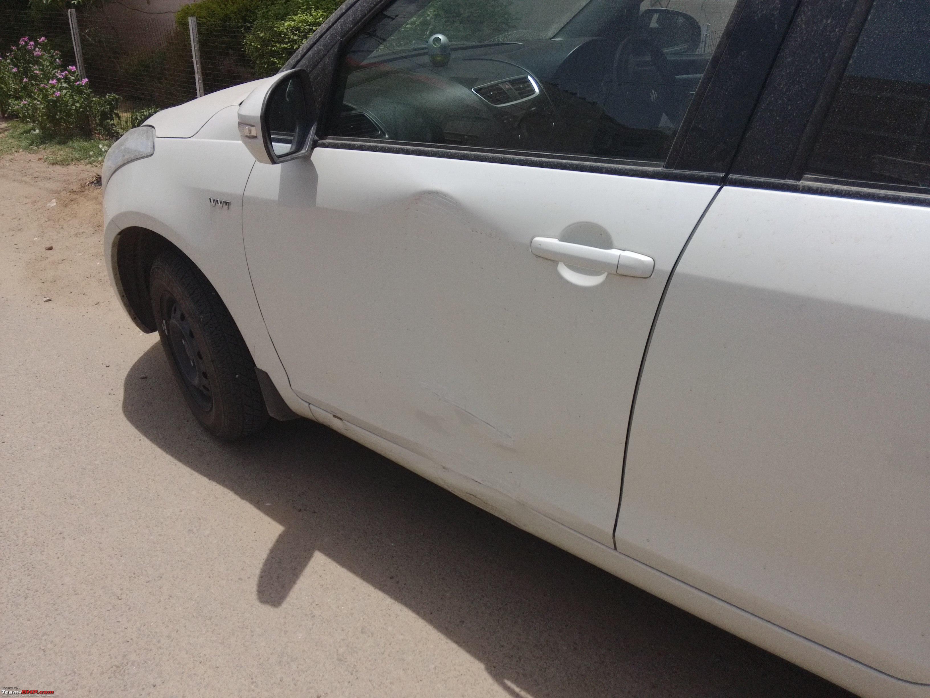

So this happened few days back. Dad was driving and couldn't notice a bent pillar and boulder on the left side.
Result: Passenger side door and running board are dented.
Review: 2nd-gen Maruti Swift (2011 - 2017)-img_20170614_130052.jpg
Review: 2nd-gen Maruti Swift (2011 - 2017)-img_20170614_130114.jpg
Review: 2nd-gen Maruti Swift (2011 - 2017)-img_20170614_130059.jpg
Should I claim insurance and get this mended by a dealer owned MASS or get it mended by a FNG without claiming insurance.
Current NCB is 35% and insurance renewal​ is due in a month.
Thanks in Advance guys.
Go to an FNG and get this sorted. MASS will definitely over charge and quality work won't be that great (as with my experience with them).
Don't spend on insurance to loose NCB. I don't find it worth to loose NCB

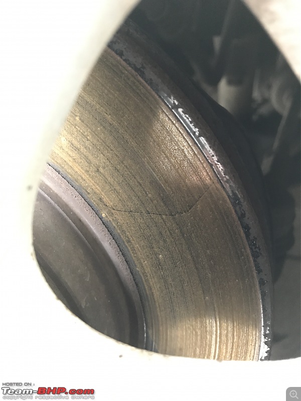

Didn't find the appropriate thread on this so posting here
I changed my brake pads in June. Now a few days earlier, I've been hearing some noise of metal rubbing against metal. Albeit at slower speeds it's super annoying and also, I don't want that noise to be there.
Checked with the garage guy who changed the pads, he tells me that the brake is touching the disc. "Disc Cutting" nahi kiya tha.
That's what he is saying. His solution is to remove the disc and smoothen the surface. I'm unaware that something like this needs to be done or is generally done. Could someone advice?
How many kms has the car run? And how many kms post brake pad change?
Can you post a few images of the rotors and the pads?
Disc Cutting/Skimming is cutting a small surface of the rotor to even out the surface and make it flat. The concentric circles are flattened.
The car has run 42,XXX KMS. The disc were changed around 20K. Post the brake change, the car has run around 1200 KMS. There are circular lines on the disc and it isn't smooth. I'll also click a few pictures if this information doesn't help

Attached are the LHS & RHS of the car respectively. The noise is only from the LHS so far
Mods please merge. Faced an error couldn't join it along with the previous post.
Attached are the LHS & RHS of the car respectively. The noise is only from the LHS so far.
Are you using OEM brake pads?
Looks like manufacturing defect or the caliper pins aren't moving freely causing the pads to bind to the rotor creating pressure on it. Can't be so bad in 42K kms.
What's the area circled in yellow?
Review: 2nd-gen Maruti Swift (2011 - 2017)-img_0296_01.jpg
Is that a crack or some kind of depression?
