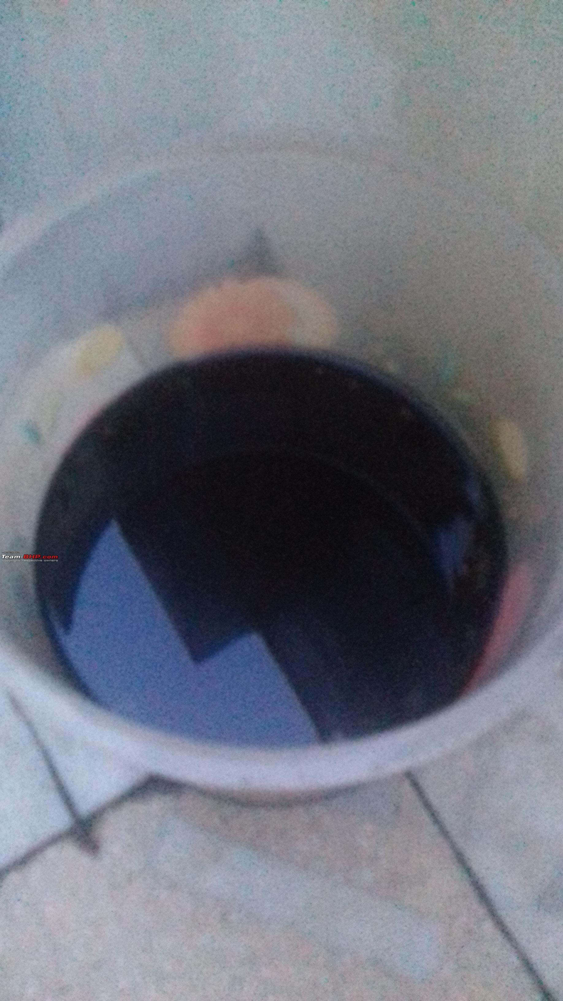

Finally, got the oil changed to Shell. Called up Amar Motors and asked if they could get the oil changed at my home. It was done. They were pretty clueless with which oil they are using upon probing they told me that they are using HX-8 0W-20 engine oil. Damage to pocket is around Rs. 2000/-. Guy came home where my Swift was parked. Mom kept a watch on him. Oil was changed. Just back from a 10 km. drive and what a difference ! Its even more refined, super refined on the road.
I did call up Kiran motors and they told me I can drive the car as long as Oil indicator on dash does not come up. But their response was bring the car here. They did a nice service on Wagon R, but I will be closely watching Swift's oil level from now on for abnormal drop.
I am attaching image of oil which had supposedly done around 1000 kms. after oil change.

I am not able to judge the size of the container. How many liters of oil do you reckon is in there?
