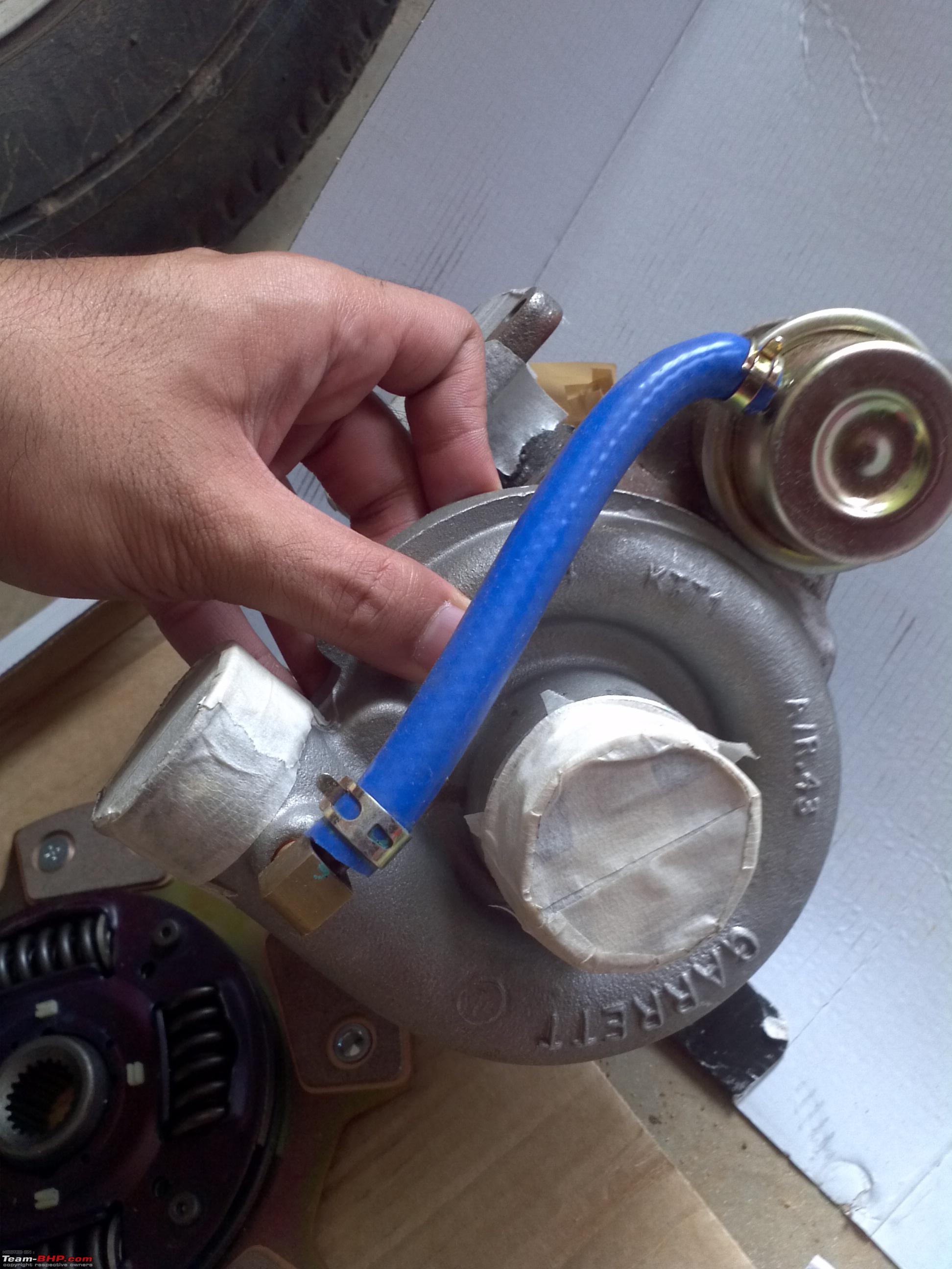

So a small update. Have paid the amount to RRP and the turbo kit for my car is going to be installed next week. :D
It is the standard RRP turbo kit which m4ugr8 also had. Should give me about 200whp or 225-230bhp at the crank.
Components are:
1.) Garrett GT 20 turbo
2.) Garrett Intercooler
3.) Turbosmart BOV
4.) Turbosmart fuel pressure regulator
5.) Haltech 500 ECU
6.) BMC DIA intake system
7.) RRP exhaust
8.) Exedy Clutch
9.) RRP plumbing
Injectors i will change later if i really feel the car struggling at high RPM's.
This also means my automech FFE and K&N Typhoon are up for grabs. They have done only 8000kms, so anybody in chennai with a civic interested in these do PM me, you will get them for a steal. !
Exedy stage I performance clutch going in.
More install pics to follow..
Visited the workshop today. All the parts have arrived except for the exhaust(Monday) and ECU(Thu/Fri).
Install of all the parts except the ECU will be done by Friday. On sat/sun we will wire the ECU and Kayan from RRP bangalore is coming over, so with me driving on the Sriperumbudur Highway/Race track we are going to tune the car to my driving style and needs. We can do boost by gear/RPM etc is what I'm told. So we'll spend the weekend tuning the car. :D
Have taken photos of all the components that are going in.
1.) Old Clutch Assembly removed. New Exedy clutch assembly waiting to be installed

6.) The Garrett GT 20 Turbo
Turbocharged R18 Honda Civic. EDIT: Upgraded Turbo, 0-100 in 7.1 seconds-img_20121103_132752.jpg
7.) The Garrett GT 20 Turbo
Turbocharged R18 Honda Civic. EDIT: Upgraded Turbo, 0-100 in 7.1 seconds-img_20121103_132811.jpg

All the above are on the cards. I would like to gauge the stock setup with the increased power for a week or so before finalizing on components I'd need to upgrade.
1.) Brake pads are going to be upgraded - Mintex or Hawk. I've got new discs upfront 1 Month ago
2.) Tein Super Street Suspension - Very keen to go for this.
3.) Tyres - I'm itching to put some nice 17 inchers on but I'm dreading the ride. And Tein suspension + 17 inchers will blow a hole in the pocket :D But if the Teins can handle 17 inchers(pointers here will be highly appreciated) well, I'll gladly spend
4.) Strut braces - Depending on the chassis flex, I might get these from the US.
So yes, it is not just a power boost, I very much will get the handling and braking up to the mark. Will not change the looks of the car though. Other than the eagle eye headlamps up front, the car will look stock. (and the alloys if upgrade)
