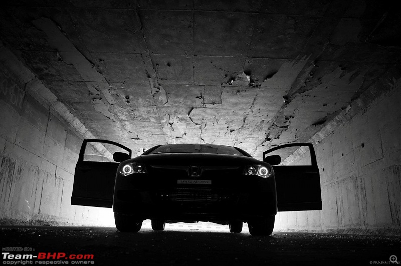

1.) Front View

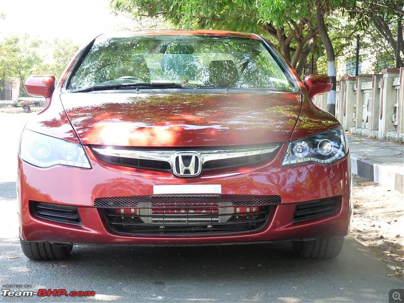

2.) Front 3/4 (or close to that)

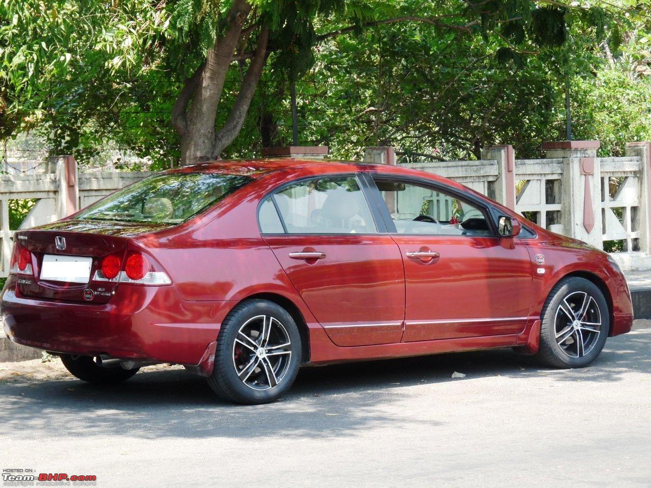

3.) Rear 3/4

Your Civic looks awesome Bhuvan, that looks classy and sporty at the same time. It's a proper sleeper that is sure to surprise a few innocent high-end sports sedans on road. Keep us posted on the turbo's performance over time!

Thank you!! :) It has been over 2500Km's so far and the car has been doing well, except for the jerking at high RPM's which also got sorted out. Takes a little longer to start up, am guessing because of the length of the intercooler pipes etc. Bikers and pedestrians do get shocked when the blow off valve lets out the compressed air lol:
