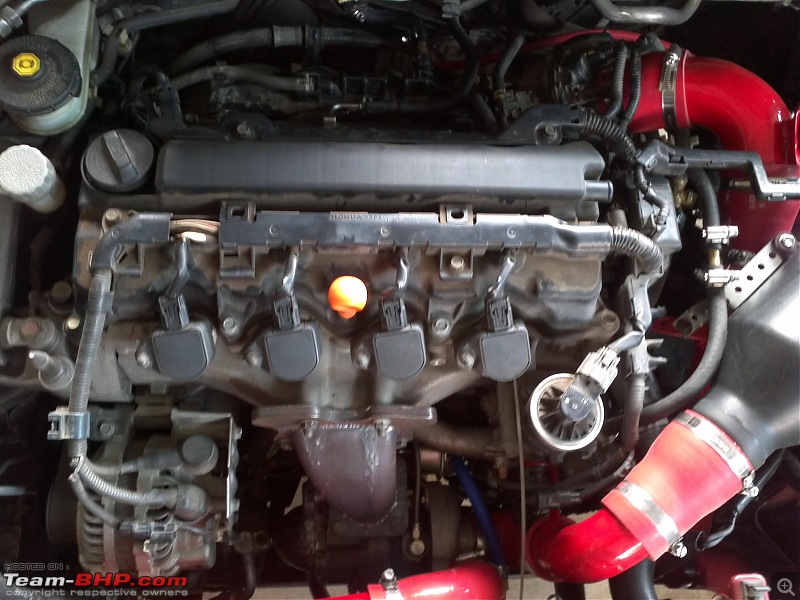

3.) Engine bay with all the fitments
Turbocharged R18 Honda Civic. EDIT: Upgraded Turbo, 0-100 in 7.1 seconds-img_20121208_141331.jpg

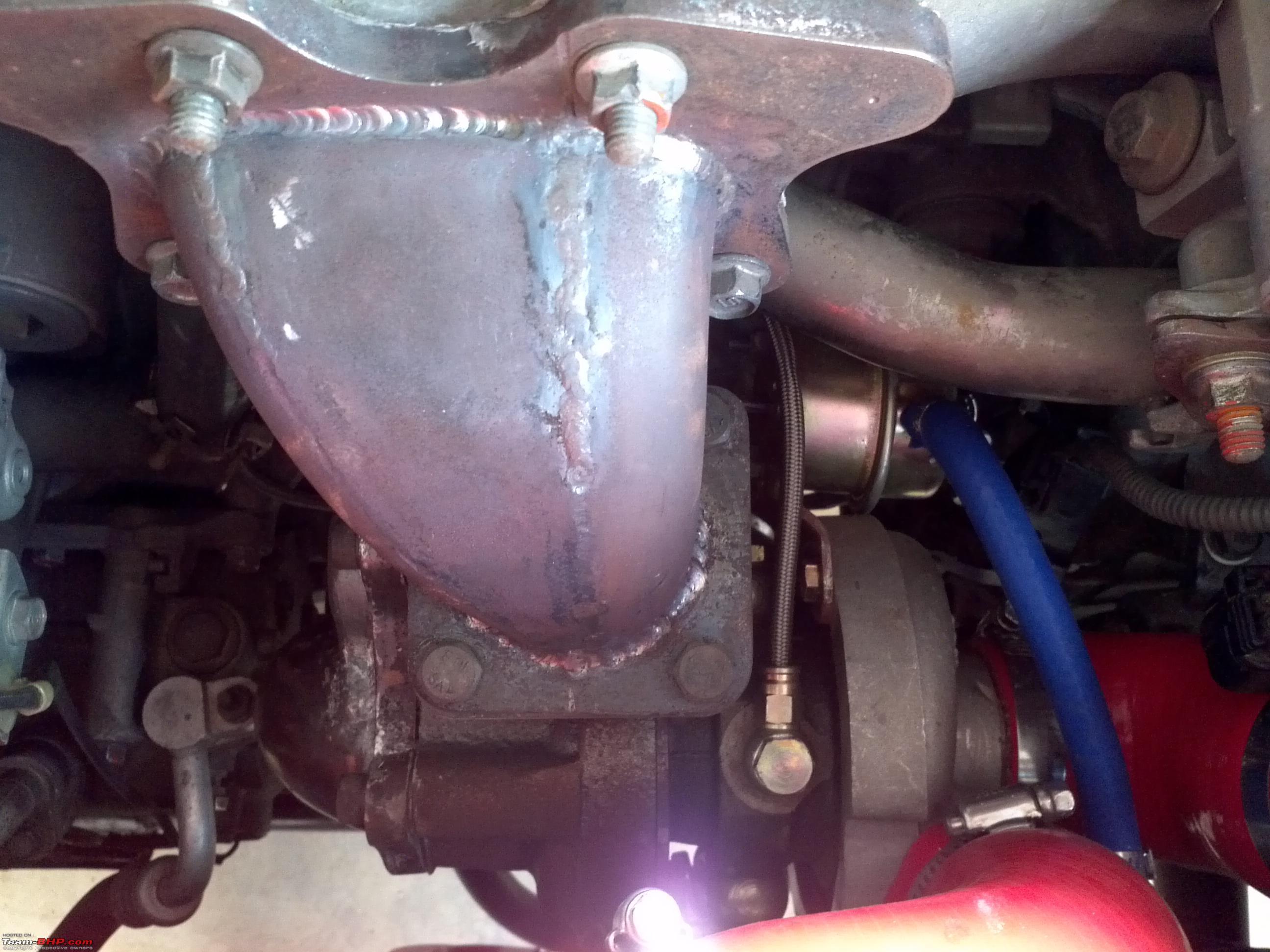

4.) The exhaust header which feeds the turbo
Turbocharged R18 Honda Civic. EDIT: Upgraded Turbo, 0-100 in 7.1 seconds-img_20121208_140840.jpg
