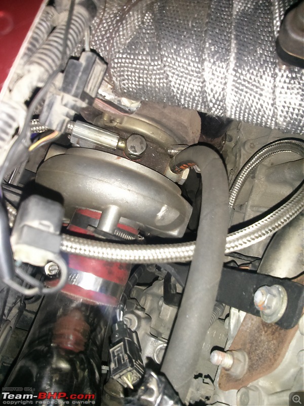

Header wrapped + the wastegate - all new plumbing
Turbocharged R18 Honda Civic. EDIT: Upgraded Turbo, 0-100 in 7.1 seconds-img_20141211_161620.jpg
The huge Evo 6 16g6 Twin scroll turbo
Turbocharged R18 Honda Civic. EDIT: Upgraded Turbo, 0-100 in 7.1 seconds-img_20141211_161638.jpg
Turbocharged R18 Honda Civic. EDIT: Upgraded Turbo, 0-100 in 7.1 seconds-img20141204wa0003.jpg

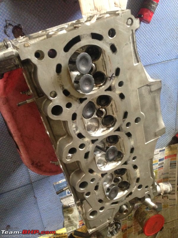

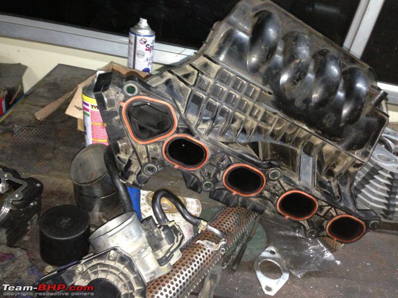

Now, I had planned a holiday to Kabini during the second week of December, so the Civic HAD to be ready for that, since I was flying into Bangalore and driving down.
The day before I left for Kabini, went down to Raceconcepts to collect the car. The car had been dyno'd the night before and peaked at 180whp, for safety and bad fuel, it was turned down to 171whp. But the part throttle mapping was still not fully done and the car was very jerky between between 2-3000 RPM. Boost was coming in only post 3500RPM, after which she was a transformed animal. Joel said he'd fix the car once back from Kabini, and that the drive should give me good time to see what else should be done.
The drive was fine. Went into boost barely 4-5 times, as lot of traffic and it doesn't feel that laggy, decently crisp responses, save for that jerkiness at times between 2-3000RPM. When I got back, I somehow in the back of my mind knew that something was up inside the engine, so I told Joel, take 2 weeks more, dismantle the head, do some basic head and manifold work, and this will give us a chance to check out how bad the carbon deposit is.
They removed the engine from the car and removed the head and manifold. Joel said the manifold design is quite decent, so just made a few mild modifications to even out and increase the flow. On opening the head, there was a lot of carbon, just imagine, I was driving all around South India with so much carbon inside! So all that carbon was cleaned and Joel did some headwork(port matching/polishing etc. I guess) to ensure good flow.
Went to pick up the car on 31st. Some stupid steering relay gone kaput meant we spent half a day figuring out why the horn stopped working and why the check airbag light won't go away. Anyway, the car dyno'd around 190whp, which then was cut down to 182whp. Got much more torque also. The whole jerkiness between 2-3000RPM was also fixed.
Started the next day on 1st January from Bangalore to Hyderabad. On the highway got into boost a couple of times and she just flew. Like Joel said -"Punch throttle and disappear".
Till 3000RPM she behaves like a nice NA car, not laggy, builds up linearly and more than fine for regular driving in the city and even on the highway, but not for urgent progress though, say around 10-15% better than a regular Civic. Step on the throttle post 3000RPM, and be prepared for some serious shove. There is a massive step up in the acceleration and it builds linearly, but it builds so strongly that you really got to have a free road up ahead, or else you're asking for trouble. It is so addictive as right till 6800RPM it keeps building, you feel like redlining it each and every time. Then you realise what dangerous speeds you have reached and back off. Where the previous setup lost power and felt pointless revving past 5000RPM, this is the total opposite.
Once I reached the Hyderabad ORR, I let her loose, since I knew the road all too well, redlined in 2nd, 3rd, 4th and almost in 5th, when better sense prevailed. Trust me, I cannot mention the speeds I reached on this forum, but what shocked me was the ease and time in which I reached those speeds. Very few cars, 530d's etc and higher up will be faster. All the 2 litre diesel German's will be left behind.
I'm sure you guys saw the Gtech numbers in my previous post, this thing has become a demon now. I took my dad for a drive, and when I hit boost in 2nd, his "Woah" at 4000RPM became a "Wooaaaaahhhhhh" by the time I hit 6500RPM.
The car was then driven from Hyderabad to Chennai. I have the AFR gauge now, so she is running slightly rich around 11 is the ratio. Joel is here on the 18th, so will try and fix that. Boost maxes out at around 9.5psi, I have a boost gauge also, so keep an eye on that.
The car is so easy to drive now, behaves just like a stock car. Feels like a nice NA car till 3000RPM and after that, well, I've said quite a bit about that.
A big shout out to Joel and the guys at Raceconcepts for this build, I really really like it, probably what RRP should have done in the first place, but, better late than never.
Pics below - do have a look.
The carbon laden cylinder heads and gasket(which was replaced)

The intake manifold
Turbocharged R18 Honda Civic. EDIT: Upgraded Turbo, 0-100 in 7.1 seconds-img20141215wa0005.jpg
The head
Turbocharged R18 Honda Civic. EDIT: Upgraded Turbo, 0-100 in 7.1 seconds-img20141220wa0000.jpg
The head
Turbocharged R18 Honda Civic. EDIT: Upgraded Turbo, 0-100 in 7.1 seconds-img20141220wa0001.jpg

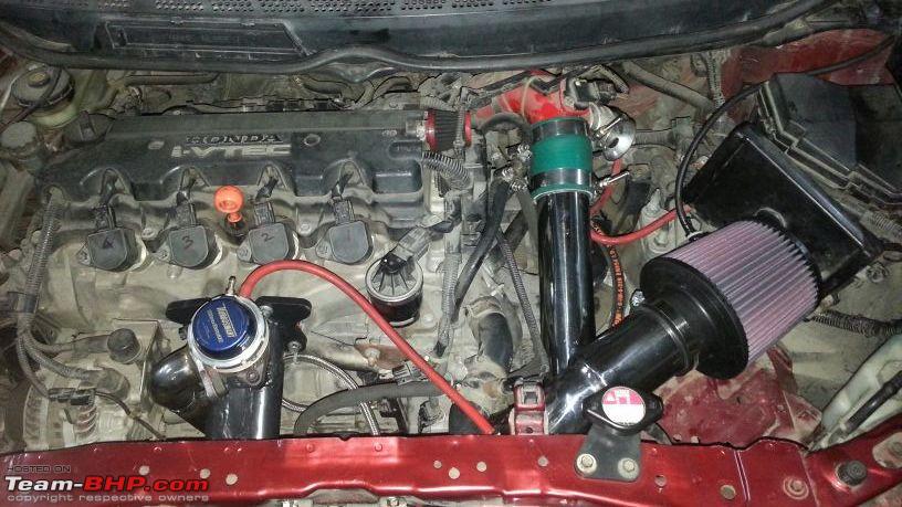

Final Setup
Turbocharged R18 Honda Civic. EDIT: Upgraded Turbo, 0-100 in 7.1 seconds-img_20150111_075738.jpg
Intake - The sctoch tape is around the boost tee
Turbocharged R18 Honda Civic. EDIT: Upgraded Turbo, 0-100 in 7.1 seconds-img_20150111_075632.jpg
