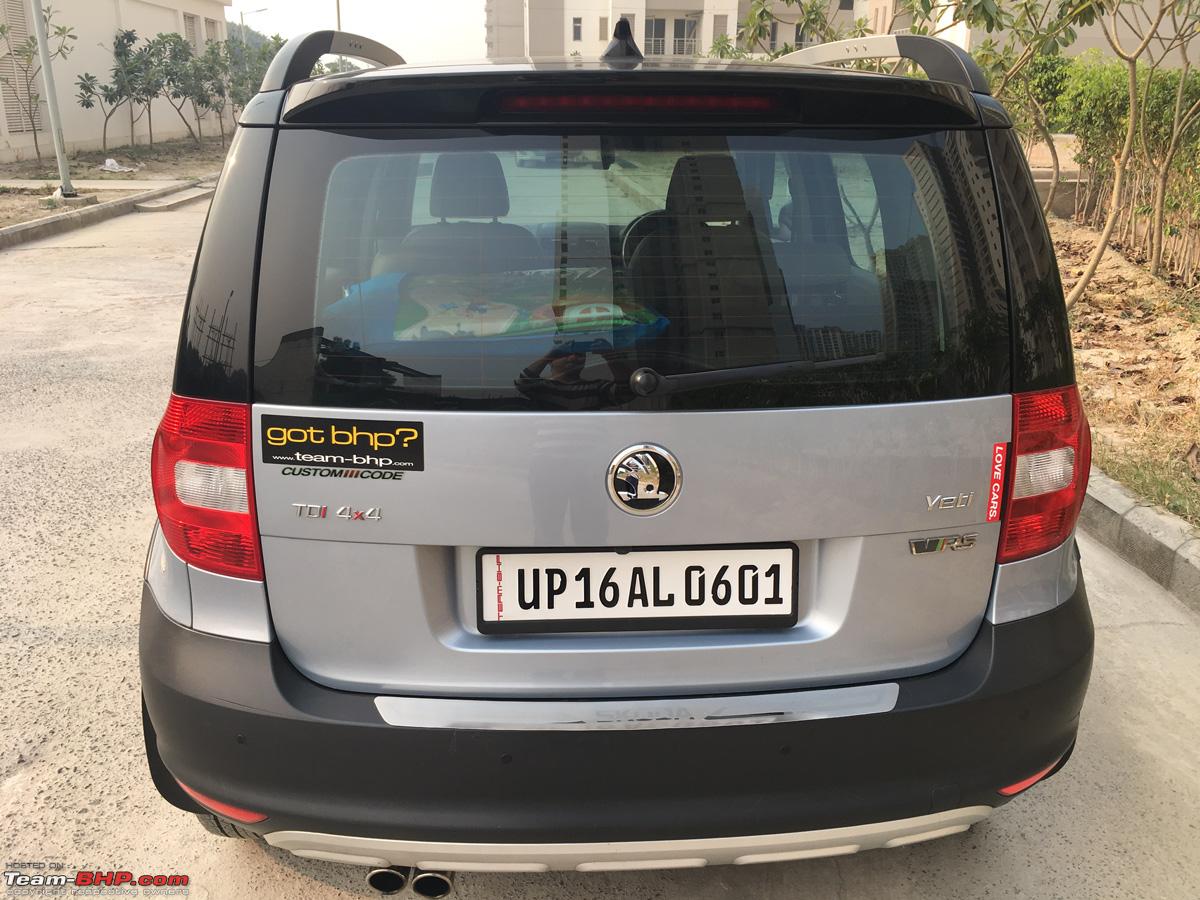

For the rear, added an ABS spoiler at the upper trunk lid to give a bit of 'chin' and to balance out the protruding rear bumper. And both are black! Also notice the steel sill guard for the rear bumper with the 'Skoda' marking. Beyond the looks, it also acts as a protector for scratches on the plastic bumper bit when heavy boxes and items are loaded.
