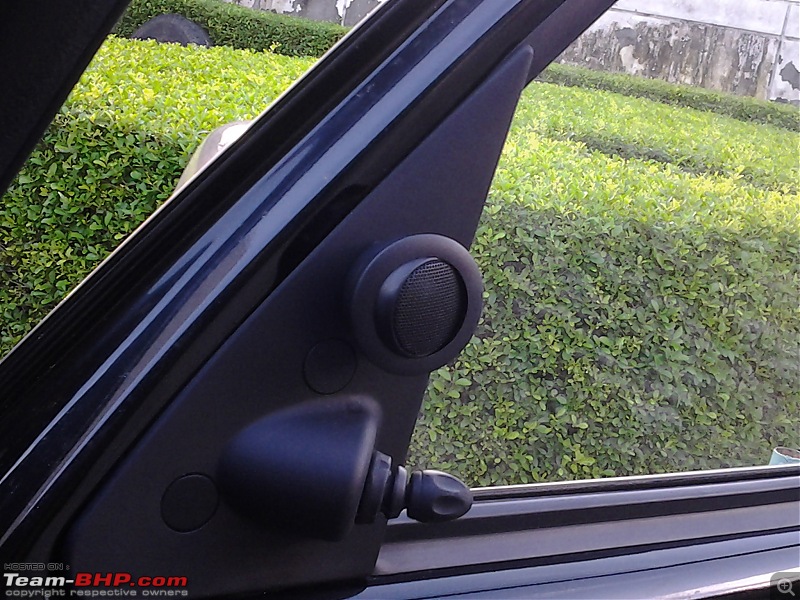

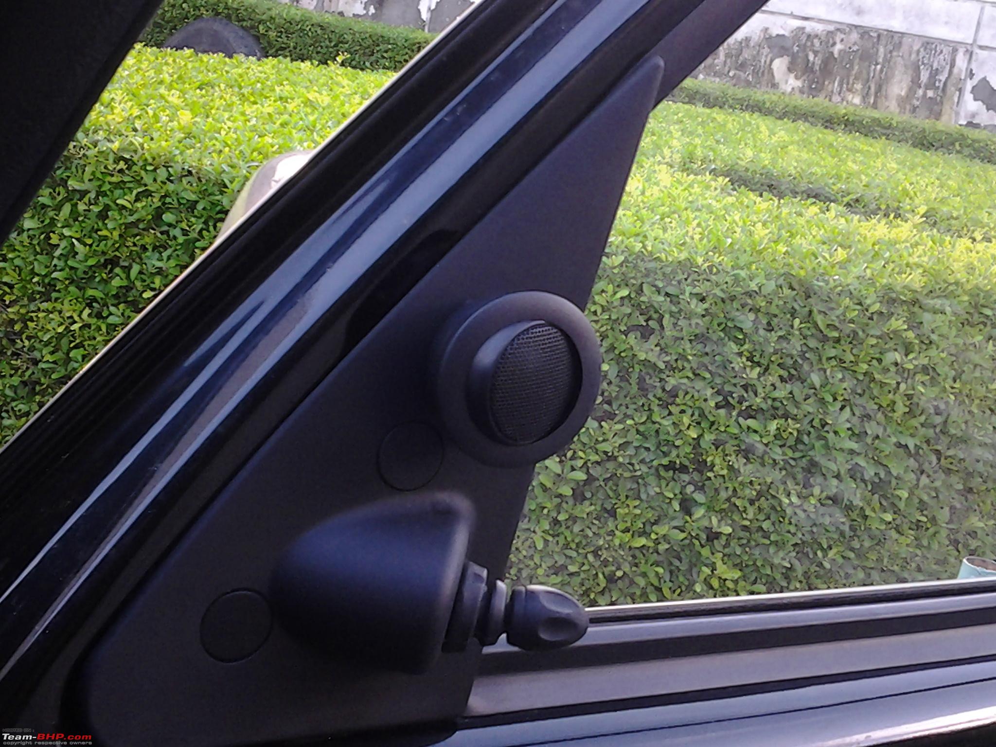

  1. Tweeters removed from dashboard, and placed on the piece of plastic that contains the mirror adjustment levers

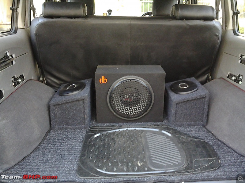

  2. Rockford Fosgate speakers on the boot door were removed and placed in the middle doors. There's a handly little gap just below the quarter glass in the middle doors that were used for mounting, with appropriate sound damping
  3. Hertz HE4 Amp was added to the car, and a Rockford Fosgate Punch series Subwoofer added, to replace the Active Sub. I shifted the active to my Tata Nano
  4. The front components, and the rear Polk Audio speakers, as well as the sub were connected to the Amp, and the old Rockford Fosgate speakers in the middle doors were connected directly to the HU. My idea was to ensure effective sound distribution, with the middle door speakers being under-played, thus ensuring that it seems like a very uniform distribution of sound across the entire length of the vehicle.
The results are to be heard to be believed- I've not exactly spent a lot on this system, but anyone who listens to it asks me if I've spent a six figure number on it. It's not even close to a six figure number in truth, and all made possible thanks to the wonderfully knowledgable folks in Team-BHP, who've turned me into an audiophile really fast
