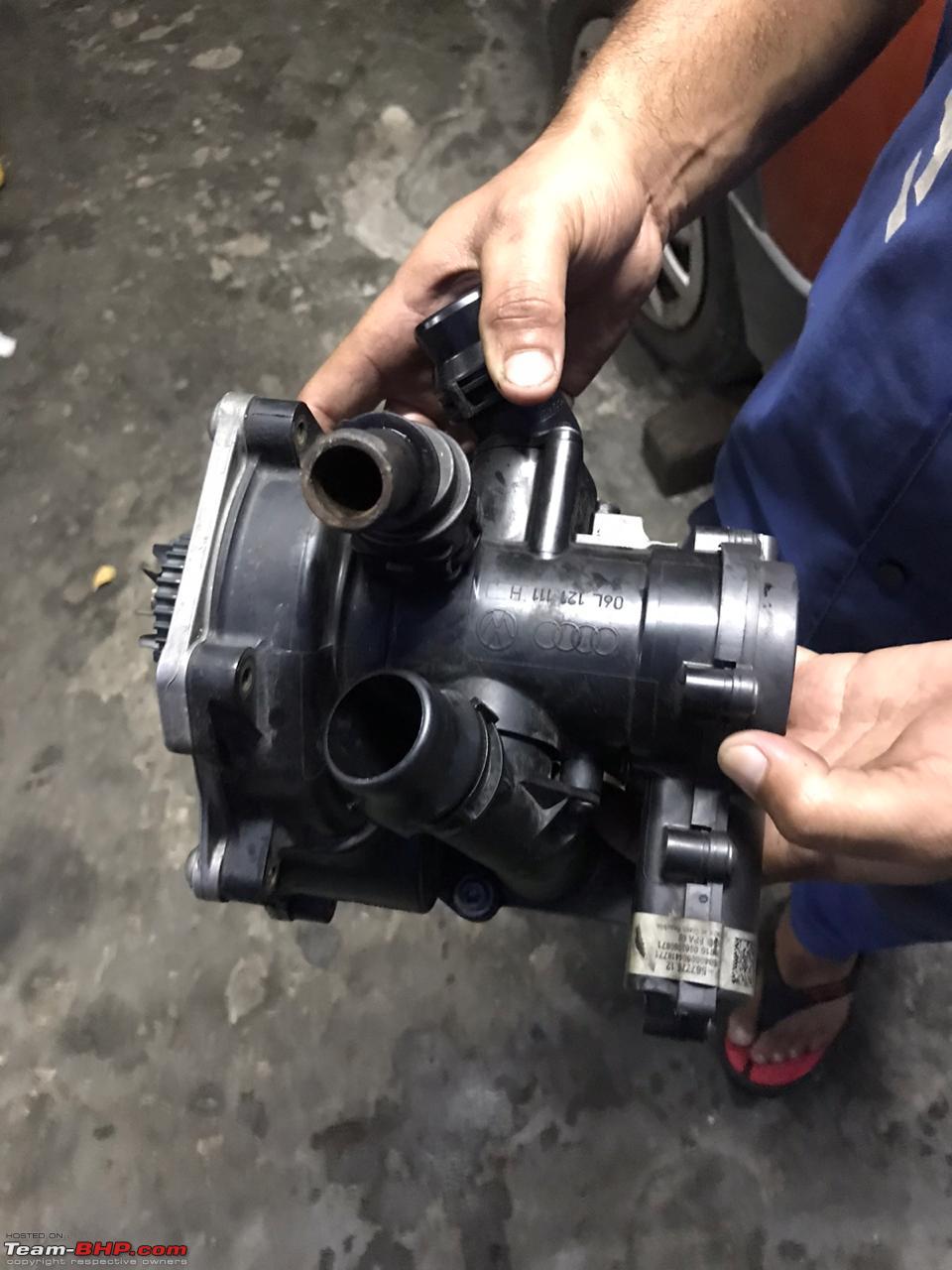

Originally Posted by adi_petrolhead (Post 4910508)
It could very well be a thermostat leak, it will not show any trails of coolant leak unless it is opened for inspection.
Drove it to PPS Service and this time the leak was evident with color all over the parts below. From inspection we could see leak from thermostat.
Very expensive part with labor he said 43K.
I think the part looks like this.
Review: Skoda Octavia (3rd-gen)-whatsapp-image-20201020-5.25.27-pm.jpeg
I'm just wishing I get some discount on this.
Originally Posted by ChoosetoCruze (Post 4908261)
If it persists, something sinister (expensive to fix) is awaiting you.
That is one MASSIVE thermostat! I think what you are referring to, is in fact the water pump assembly..
On a related note, no damn wonder they are notorious for going out so regularly on VAG vehicles. Just look at all that plastic!! Why can’t they use metal water pumps, like most mainstream manufacturers?!
A Google search on the part number indicated on it - 06L121111H says thermostat and water pump housing.
eBay Germany has the part for 186 Euros inclusive of international shipping.
https://www.ebay.de/itm/06L121111-Fu...e/333675346092
Maybe with a bit more searching you can find one cheaper elsewhere?
Perennial recurring issue every 30/40K km in the EA888 engine family. I had my 1.8's unit changed under extended warranty too. Needed some cajoling but I paid only for consumables if I remember correctly.
