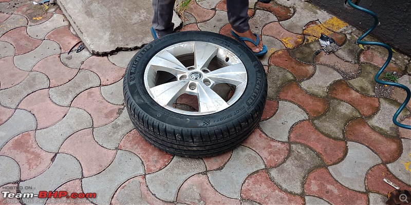

Got Michelin Pilot sport 4 installed from Tyre Trax Pune. Didn't get chance to ride much after that. The vibrations were due to a couple of dents on the alloy wheel which they got repaired for me.

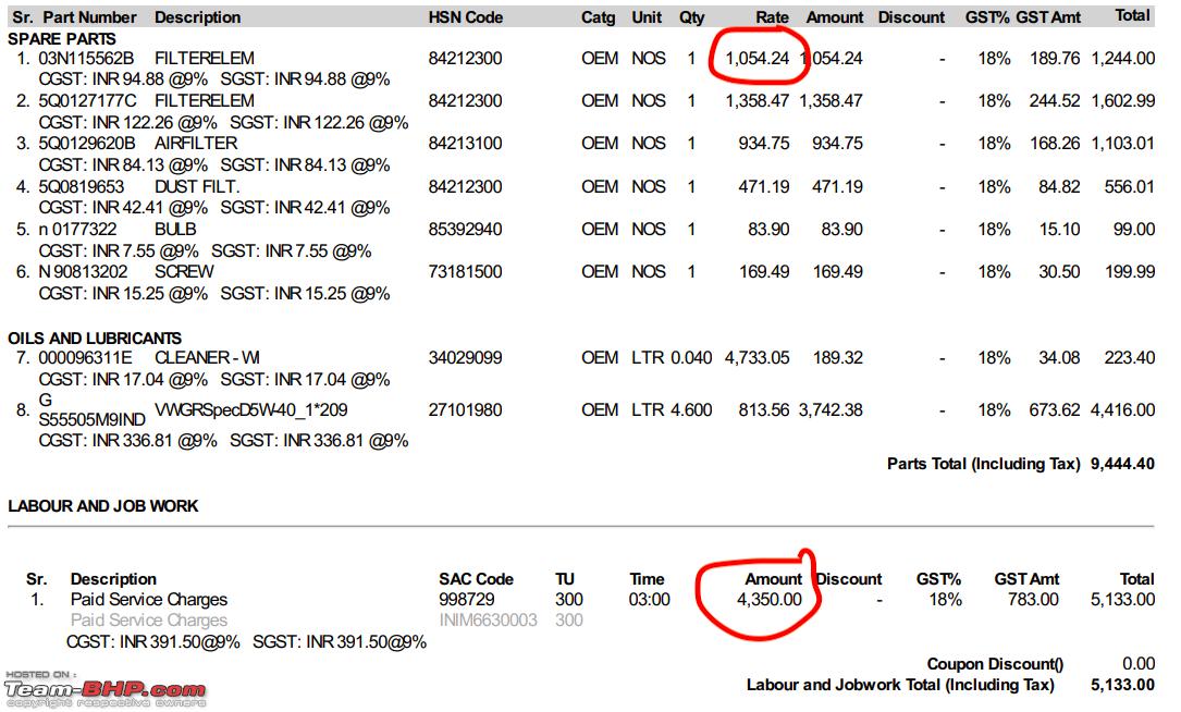

Here is the comparison between service costs.
Labour charges have doubled.
Fuel filter cost is 3 times now.

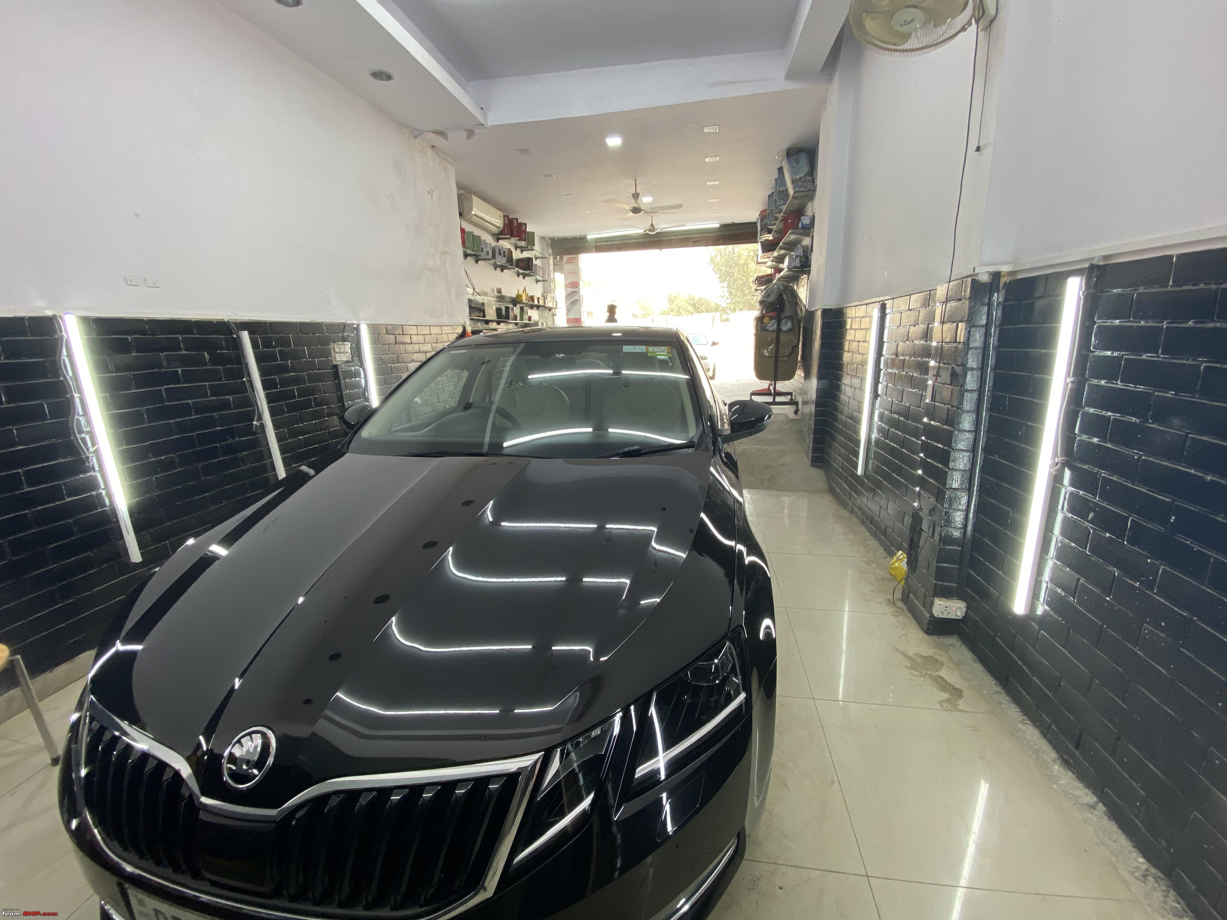

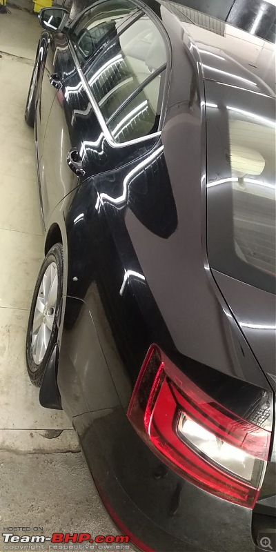

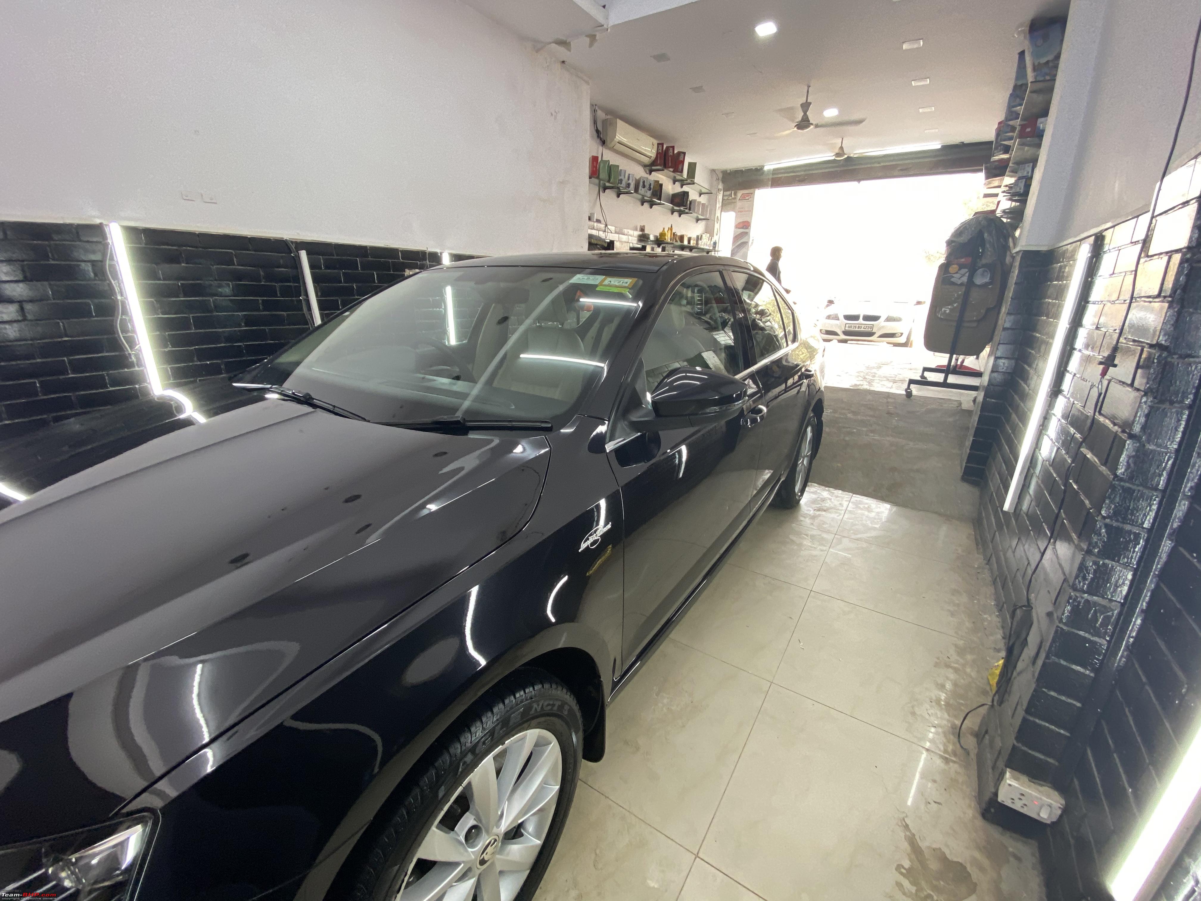

Though my Octy is around 15 months old, I hadn’t got Ceramic coating done. I was a bit apprehensive about the results and the costs. Finally gathered moolah and courage to get it done.
I hunted few locations in Gurgaon for Ceramic coating. Prices quoted were around 30-35 k for 3M and 9H coating was offered. At one of these places, Batra Car Care, in Sec -14, he offered me great discount on it. I had already used his services for accessories for several of my earlier cars. Naturally, I was confident of getting Ceramic coating done here.
After the final result, The shine and gloss was awesome. It was totally worth every penny spent here. I am sharing some of the pics.
