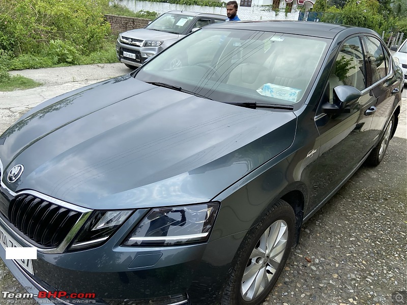

Hi @itwasntme, The details are genuine, verified from few places, plus the gut feeling
The seller is a young professional who travels to hills for work, very often. He doesnt prefer driving to shimla/ solan in Octavia and this leaves the car with his wife ( who doesnt know how to drive) & his toddler. So basically the car is of no use to him.
Visited their home once and checked the car thoroughly. Here is one pic I managed to click. The car looks fabulous in quartz grey, IMO.

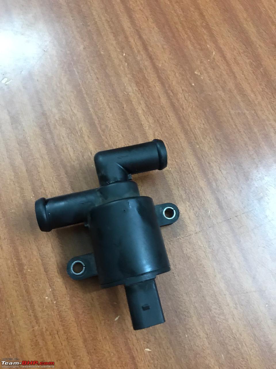

Originally Posted by abacusv View Post
Hi,
My octavia 2015 model has error showing up with bypass coolant error after inspection,
the service guy(local but known guy) says the sensor is gone everything else is fine.
And the sensor costs about 11k. Its coolant bypass sensor not coolant sensor.
Any one has experience with this unit, not able to get one in bangalore. Service guy is trying since few days from various source but getting delayed.
Looking for cost review and spareparts source from where I can get ASAP.
Attachment 2020275
Looks like the problem which started as Rat entry has opened up pandora of problems to my car. I had to take the care to get it checked cos there was a
Airbag error light glowing. Service guy had to put sensor check which gave P2681 error along with rat bitten wire on roof mounted airbag.
I dont know should I thank the rat for making pre-visit the center or is it the
rat that messed up with sensors.
There were no connectors/pipes damaged for P2681 error, so the service guy thought the sensor is gone and replaced it(magnetic solenoid valve). Now the issue still remains, the temp of the engine is shooting up at 130.
The coolant flow from the radiator to the engine is blocked. He tried if its a valve but there was no issue with the valve.
He now, suspects it must be issue with thermostat cum water pump unit. Looking at the part, I feel it will cost me a bomb.
Review: Skoda Octavia (3rd-gen)-whatsapp-image-20200701-4.50.16-am-1.jpeg
Review: Skoda Octavia (3rd-gen)-whatsapp-image-20200701-4.50.16-am.jpeg
I am suspecting either of them(magnetic solenoid valve, or thermostat) must be faulty but not both.
What I want to know is.
1. my car is odo at 66K Km driven, what could cause these parts to damage?
2. The issue did not surface while driving long, but happened due to long parking due to current lockdown. Mine is TSI, wondering long parking should be a problem.
3. Any suggestion on the issue I am facing, if someone had experienced before.
abacusv is offline
As far as I am aware, this is a common issue in the 1.8 TSI engine, and most owners have suffered this failure with the water pump + thermostat or either. Mine was replaced under warranty as it was within the 4th year extended warranty. Unsure if the lockdown had any effect though or whether it was just coincidence.
I suggest you politely ask Skoda for a goodwill discount on the componen replacement cost. If your car has been religiously serviced at Skoda and there are no modifications which can be attributed to contribute to this failure (e.g. remaps, tuning chips etc), they should offer 25-50% off I feel. You will have to foot the labour cost in full though and any consumables.
Let us know how it goes.
Any clue how much does it cost. Looking at size of it, should cost a bomb.
Yes the thermostat housing is about 50K at the ASC if you are out of warranty. You may ask for goodwill and get 20-30 percent waived off if your car has a clean service history and has no mods whatsoever.
