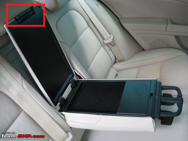

I need to replace the horn on my 2010 Skoda Laura. I have been using some local horn and it failed within a year. Annoyingly, it has about 3-4 sounds (low pitched to high pitched) right now if I use the horn.
And I don't know if this part in armrest of back seat would be available separately outside or I should go for 3D scanning and printing for this. I am unable to use the armrest due to failure of this part. It shows superb's arm rest in the image but 2010 Laura has identical part. Image attached below.
