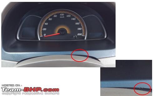

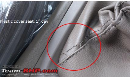

I received the delivery on 10th May. I noticed a few quality issues as shown in below images and informed the sales person about it, he said that I could drop by will be fixed.
But I did not give too much importance to it as they were minor issues.
