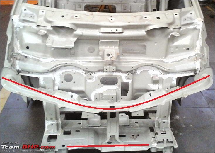

Santosh Varghese shares the following via email.
I would like to bring to the notice of our members, what I personally think, is a design flaw in my (our) beloved Tata Nano.
I encountered a small accident about two months ago, wherein I rear-ended a Matiz (when he suddenly braked). I was not fast, may be 40-50 km/h when I rear-ended it. The Matiz had no scratch; not even on the bumper which my Nano rammed into.
And here is the list of damages to my Nano: air-con condenser, front bumper, front bonnet and the metal bar that holds the bumper (picture attached and marked with curved red line) and the bonnet lock was deformed.
The metal bar was deformed to an extent where it had to be completely cut and replaced. Technically, the metal bar is a part of the crumple zone but having the air-con condenser and other associated parts fixed to the same metal bar proved very expensive.
I strongly believe that if the AC condenser and the related parts were NOT bolted to the metal bar, I could have saved a lot.
Even the bottom of the air-con condenser is fixed to the bottom part of the chassis (marked by a straight red line) due to which the chassis got deformed slightly.
So every time one bangs into something, he/she WILL end up replacing the air-con condenser (not to forget the associated parts that hold the condenser in place), bumper and front bonnet and all of this just because they are all commonly held in place by the said metal bar.
Wish TATA would read this and possibly in their next upgrade, they can redesign the front-end in such a way that the damage is less, or in other words, the number of parts which need to be replaced (in the event of an accident) are minimum.
Attachment 1394648
An associated problem is the very small vaccuum capacity of the servo, especially considering that the small 2 cylinder engine is at the rear & the servo in the front. After 2 or 3 pumps, the servo runs "dry" with consequent complete absence of servo assistance, especially when you need it most. I am considering building a small vaccum reservoir and attaching it to the servo for that much extra vaccuum capacity. I will keep this forum posted.
Hi S2, would you kindly get photos of the damaged air condenser from Mr Varghese? A crash at 40-50 kmph should have resulted in more damage than the bumper-bonnet-bonnet lock. I'm assuming that the crash was actually at maybe 20-30 kmph. I think the exhaust pipe of the Matiz might have punctured the AC Condenser necessitating a replacement.
