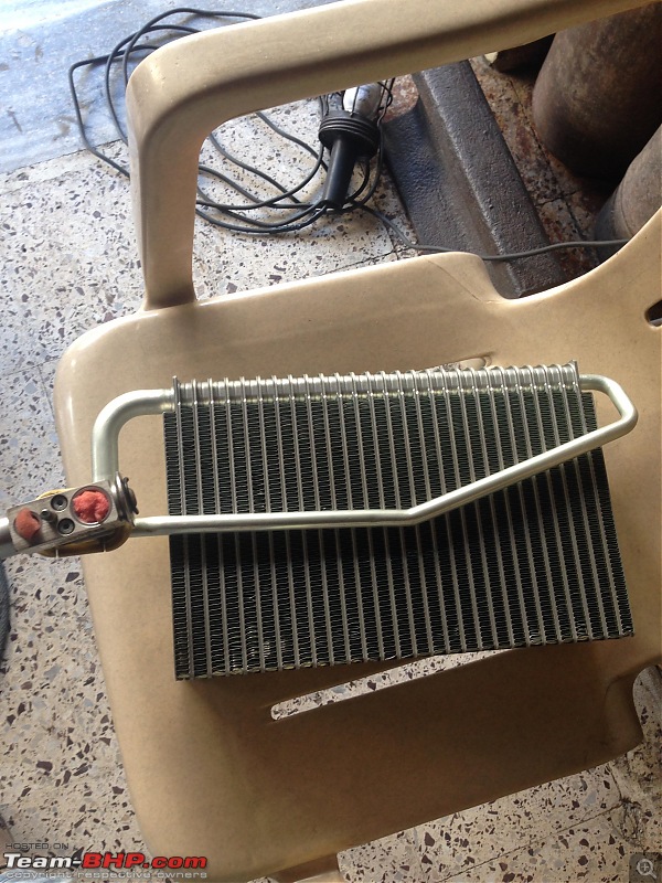

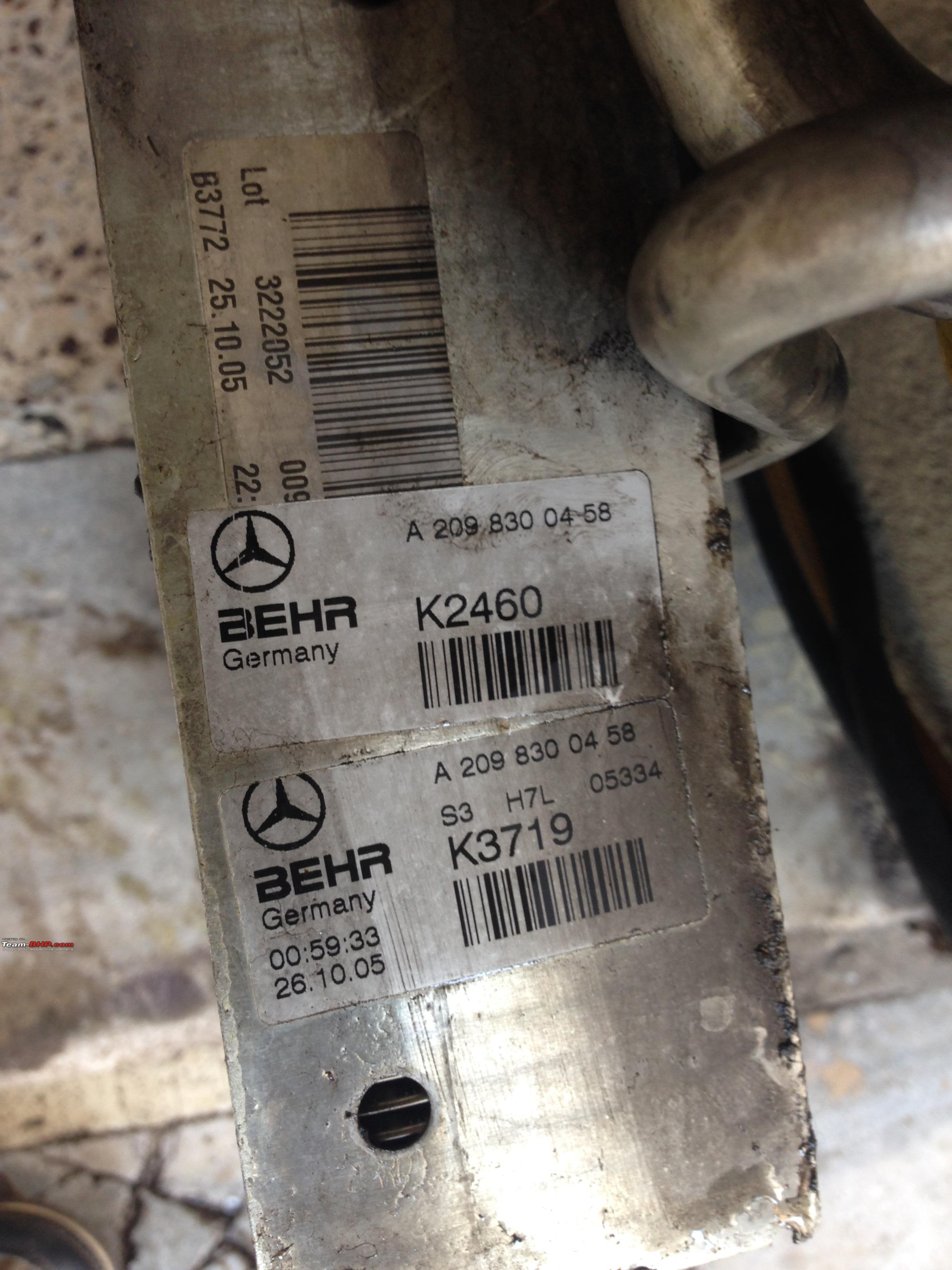

Re: My experience with a pre-owned Mercedes C220 CDI (W203)
Some more Work in progress photos....
The Black box that houses the Evaporator core is finally out!
The Black box being opened.
And Finally we reach the Faulty Evaporator.
My experience with a pre-owned Mercedes C220 CDI (W203)-img20140422wa0018.jpg
My experience with a pre-owned Mercedes C220 CDI (W203)-img20140422wa0019.jpg
The Expansion Valve.
The New Evaporator Core.
How long did it take to reach the sweet spot actually ? Have installed the new core and putting things back in place, is there a 100% guarantee on the fit and finish, Can the refit when done manually be as perfect when compared to factory fitment standards in order to give a squeak and rattle free driving experience from dashboard perspective ?

It took us about 3 hours to get to the Evaporator.Well the fit and finish is perfect in my car.End of the day it all comes down to the skill of the technician working on your car.
