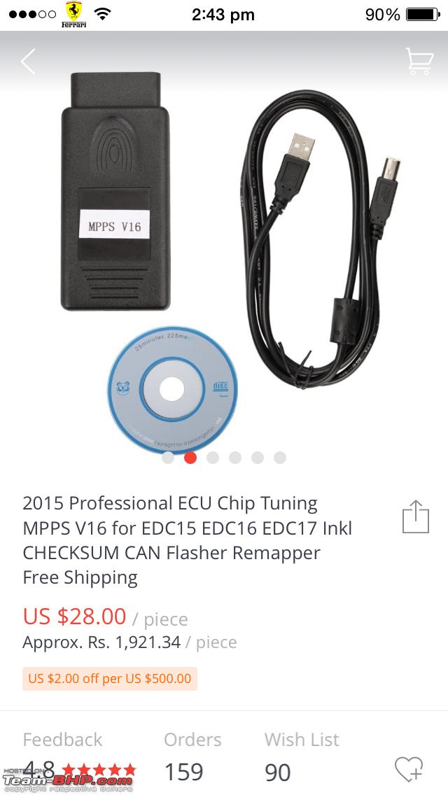

Got the Remapping Cable from Ali express. Installed software on my computer, Downloaded file from my car and sent it to a tuner in Latvia payed him 5000.rs for shutting off EGR valve and increasing initial acceleration. once I got the file back through mail copied the file back to my car.
The car can match the latest C class in performance. And also the improved brake's have given new confidence, earlier the brake pedal was soft and cars used to cover quite a distance before coming to a stop.

Iceman1 thanks very much for your appreciation and for starting this wonderful thread for all W203 owner's.
Parts cost I don't really remember Since I gave list to my father and he got them procured them for me.
As far as remapping is concerned.
As you are owner of same car you may know that in first 2 gear's in City the car is sluggish. There is huge lag which leads us to use throttle even more finally leading to bad fuel average.
By turning of Egr valve electronically we are always allowing fresh Air into the engine irrespective of Car's RPM. Generally at low speed the Exhaust gas gets recirculated. By doing this car has more power at low rpm and also we can feather touch the throttle in traffic instead of nailing it to floor.
The advantages are
Better Acceleration
Better fuel mileage
Less carbon deposit in engine since only fresh air is pumped each and every time.
I Had also instructed my tuner to increase power output by 5% (Generally upto 30% can be increased within safety limit by an experienced tuner)
He would have slightly increased % of turbo boost pressure, And all the maps such as driver's wish map etc.
Be aware when your copying the remapped file back to the car.
The instrument panel would show system error and ensure you have sufficient battery in car since for the whole duration of 10 minutes which took to copy the file back the engine fan ran at full speed.
I was worried if my battery would have ran out I would have spoilt my ECU. and there is no turning back once the copy procedure begins.
Remapping is much better option compared to tuning box and I also have copy of my original file with me incase I need it.
It would give whole new life to your car.
