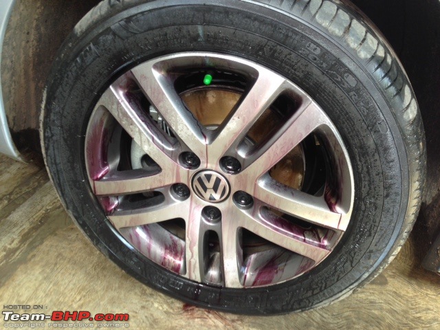

2. Iron Decontamination
Effect of iron decontamination on the tyres
Silver VW Jetta DSG Highline 2.0 TDI - Latest addition to our family-image1.jpeg

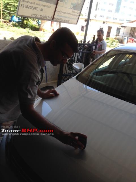

Mohsin checking the depth of paint before polishing. It was 99-110 microns. Good quality paint work from Volkswagen.

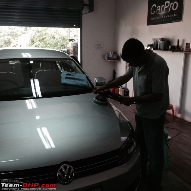

Polishing the car with Car-pro polish
Silver VW Jetta DSG Highline 2.0 TDI - Latest addition to our family-image5.jpeg

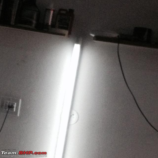

Same bonnet area post the polish work (the pic below is slightly over-optimistic, the a faint line of the scratch can still be seen but no where as in the above pic)
Silver VW Jetta DSG Highline 2.0 TDI - Latest addition to our family-image8.jpeg

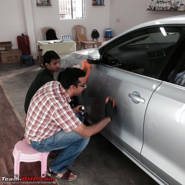

5. CQuartz coat
Mohsin and Team applying CQuartz
Silver VW Jetta DSG Highline 2.0 TDI - Latest addition to our family-image7.jpeg

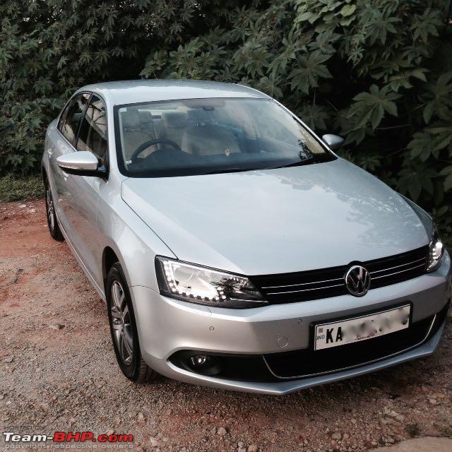

Final Finish
The car after the treatment. Unfortunately Silver doesn't show the results as good as the dark colours.
Silver VW Jetta DSG Highline 2.0 TDI - Latest addition to our family-image9.jpg
Verdict: Extremely satisfied with the results. Mohsin came across as a passionate and genuine guy with lot of knowledge on detailing. Good experience at Ultimate Detalierz.

1. Can you tell me what benefit/advantage does iron decontamination of wheels has?

1. Iron decontamination removes the brake dust that comes from the wheels. It gives more longevity to the paint & finish is what I understood.

But, is it just me or the "after polish" photo really shows some tubelight and some cans on wall?
It does show that way! The finish was really awesome. It took about 5-7 mins of buffing on that panel to get into that finish. They used Scholl 3 Gold polish which has an extra heavy cut to remove the scratches.
The real beauty of the coating is known when you spray water on the car. Water just washes off the body and doesn't stick. Will take a video the next time I wash the car and share it.
