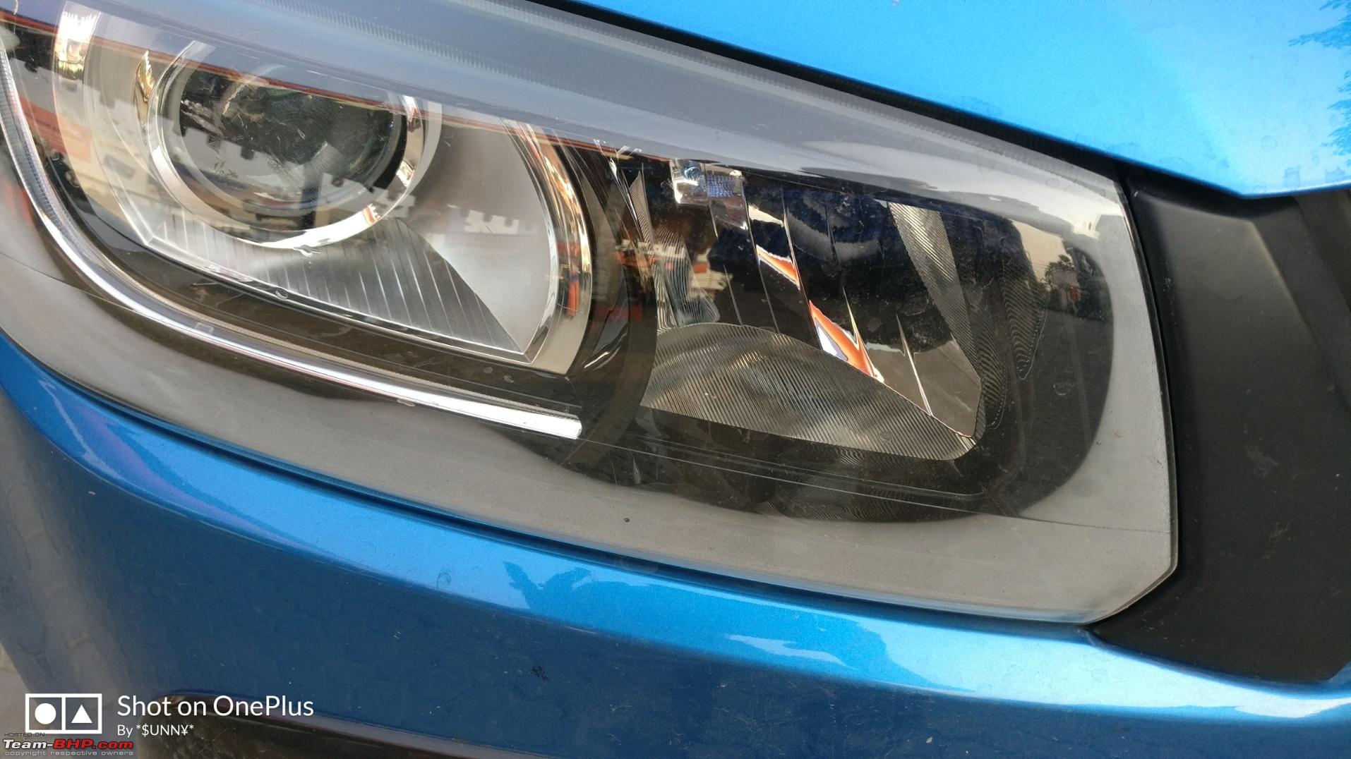

Had gone on a 200km drive today, and the condensation issue has again cropped up, albeit much less than last time. Weather is kind of humid and dry at times so not sure what's the reason this time. Showed it to Workshop Manager while coming back just for info and he said he'll inform people higher up. My both headlamp units were changed in March I guess.
Operation Khoj: Maruti Vitara Brezza ZDi+. EDIT: Car sold - Page 7-img_20171015_182122.jpg
Operation Khoj: Maruti Vitara Brezza ZDi+. EDIT: Car sold - Page 7-img_20171015_182138.jpg
I'm not sure if they'll do anything this time. Anyway I'm happy with my light setup and will follow it up only if it starts condensing a lot. Had posted this just a few days back-
Hi, great write up. My headlamps were replaced under warranty and I haven't faced extreme condensation like earlier but yes, there is some amount of condensation which occurs if there is some heavy rains after a hot humid weather.
The condensation issue per se. http://www.team-bhp.com/forum/offici...ml#post4084383
Originally Posted by gururajrv View Post
Have you heard of any owner confirming resolution post the replacement?
And now I get it, again!

Thanks for following up on this sir! Yes, it looks like a defective design that's either letting the heat generated within the headlamp assembly stay inside without a small hole as ventilation support for the heat to go out or the humid weather is the culprit for all this condensation issue within the assembly - not sure if i'm sound technical when I'm mentioning this, but this is what I think .
This will have to be escalated to the higher ups in MASS or MS rather, because of the fact, the least MASS can do is to switch another assembly as replacement but they won't consult with MUL for sure. This will not go anywhere and is bound to sit with us for a long time to come
This is one reason why I didn't bother going to my service station.
Have you noticed any drop in lighting performance on the other hand when you find this condensation happening? I haven't noticed any drop as such. Cross verifying with you.

Sorry for a delayed response. The first time it started happening was during last year monsoons. The condensation was so much that it would scatter the light thereby reducing it's intensity in an already pathetic illumination of the headlights. It took a few months for them to change it. This time, with the new headlamps,the condensation is less but it's there. I've not noticed any drop in performance, maybe because I'm using Micro Fogs which in themselves are too good and mask the poor performance of headlights.
