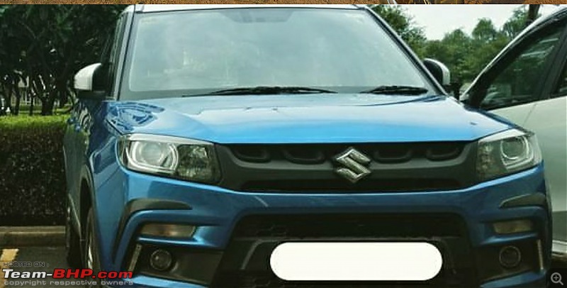

2. DRLs -
This was another thing that I always wanted to have. I was surprised when Brezza was launched with Bull-Horn LEDs not actually a DRL, even when a cheaper Baleno had it in its top trim. I came across a post on Facebook VBOC page regarding Philips DRLs being sold as a MGP. The local dealership helped me in getting it. I got it fixed at the dealership so that my warranty remains intact.
Operation Khoj: Maruti Vitara Brezza ZDi+. EDIT: Car sold - Page 7-img_20170212_115703.jpg
This is how it looked earlier.
But I somehow was not happy with its placement so started tinkering myself. Then I managed to fix it like International Vitara.
Operation Khoj: Maruti Vitara Brezza ZDi+. EDIT: Car sold - Page 7-img_20170415_094005959.jpg
I liked this as the best.
But at this location, the DRLs were always loose, even my 2 year old son was able to pull it out once! I was looking at another place when I found out that the lower black part of bumper comes as a separate unit. This started another project of mine, fixing the DRLs in a better way so that they are not loose. I procured right and left pieces at 200 INR each and started my work. I made a cut out in the plastic part and after fixing the DRLs, I sealed the gaps using glue gun. After that, I used M-Seal to cover it up and filed it to smoothen it. Last was to paint all M-Seal to black so that it looks like an original fitment.

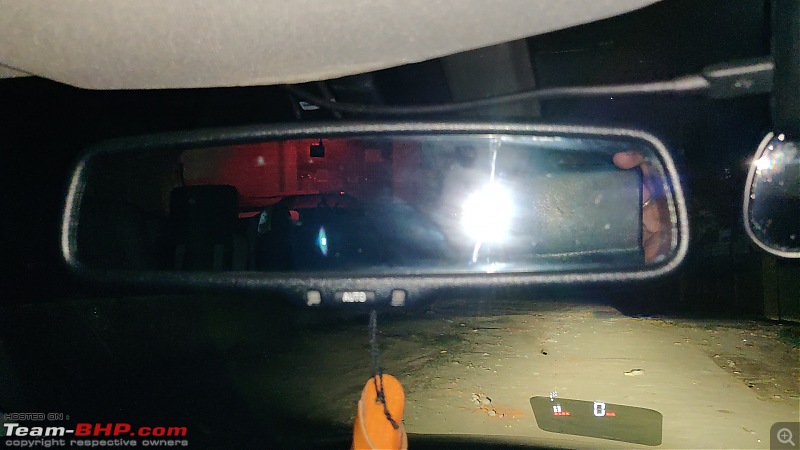

3. Auto IRVM or Electro-Chromatic Mirror -
I drove my brother's S-Cross which has the ECM and I was really happy with the results. Since Brezza had this as an accessory, I asked my dealer and he ordered it for me. Once it came, I got it installed at MASS during 3 year service. The connection was taken from a hardwiring I had done earlier for my DashCam which I couldn't utilise as it was not supporting my DashCam. The lights were on, there was power to the mirror but it wasn't functioning. The electrician wasn't aware about the wiring so he left it like that. Since the harness was unavailable, the coupler had been removed from the mirror casing and wires were directly connected. I was not happy with this. When i came home, I removed the mirror, used a soldering iron to connect the wires. Then I checked the issue with it not working so I removed the hardwire kit and took a connection from the fuse tap. Voilą, it started working.
Operation Khoj: Maruti Vitara Brezza ZDi+. EDIT: Car sold - Page 7-img_20190813_212040.jpg
Working as a normal mirror without power.
Operation Khoj: Maruti Vitara Brezza ZDi+. EDIT: Car sold - Page 7-img_20190813_212046.jpg
ECM works!
This is one of the best things I have done to my car.

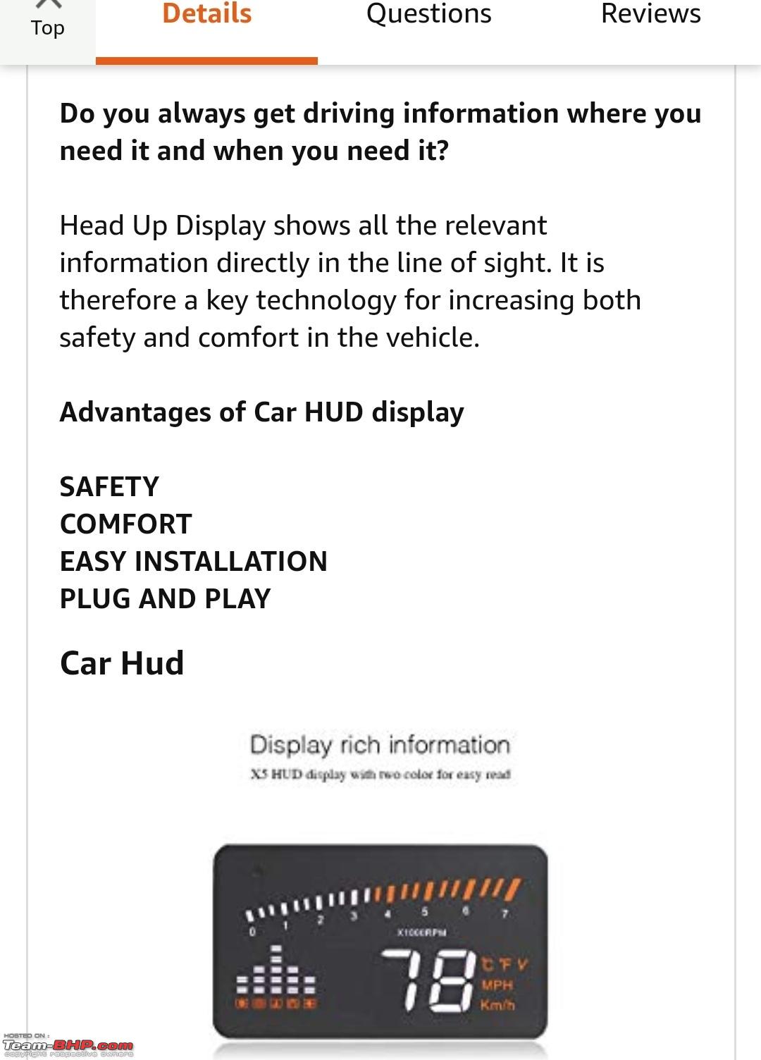

5. HUD -
This was one other thing that had my fascination. I kept on searching different places, forums and websites for the same. Lastly, I took a plunge and got this - removed as it was not loading. Search on Amazon for Head Up Display Car HUD and you'll get lots of option. This gets connected to the OBD2 port by an adapter which comes with the display.
This is an OBD2 based display and comes with a reflector film that needs to be stuck on the windshield. It shows me the battery voltage before and after cranking, speed in kmph as well as water temperature, overheating alarm, engine speed etc as a display.
Operation Khoj: Maruti Vitara Brezza ZDi+. EDIT: Car sold - Page 7-hud.jpg
Operation Khoj: Maruti Vitara Brezza ZDi+. EDIT: Car sold - Page 7-hud1.jpg
Operation Khoj: Maruti Vitara Brezza ZDi+. EDIT: Car sold - Page 7-hud2.jpg
Operation Khoj: Maruti Vitara Brezza ZDi+. EDIT: Car sold - Page 7-hud3.jpg

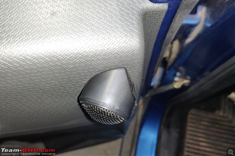

8. Sensairy - Link (SensAiry : An app-based TPMS)

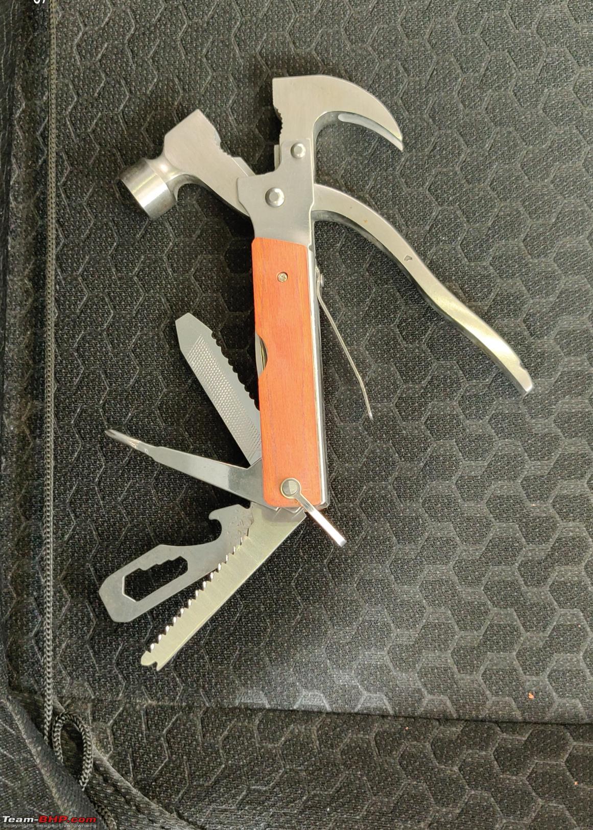

16. Ceasefire - For any untoward incident with respect to fire. It came with a multi-utility hammer.
Operation Khoj: Maruti Vitara Brezza ZDi+. EDIT: Car sold - Page 7-ceasefire.jpg
Operation Khoj: Maruti Vitara Brezza ZDi+. EDIT: Car sold - Page 7-ceasefire1.jpg
Operation Khoj: Maruti Vitara Brezza ZDi+. EDIT: Car sold - Page 7-hammer.jpg
Operation Khoj: Maruti Vitara Brezza ZDi+. EDIT: Car sold - Page 7-hammer1.jpg

The hammer shaped multi tool looks very interesting. You mind sharing a link.
Thanks for taking the time and sharing the details with us.
I had placed order for Ceasefire fire extinguisher online and they were hand delivered to home. There is an offer which includes the hammer for free.
Kit
The hammer is also available separately.
Hammer

Please tell more about the tyre pressure monitor unit above the conversation mirror
ashishy is offline
Old 30th August 2019, 07:18   #68
BoneCollector's Avatar
Location: .....
Posts: 3,333
Thanked: 11,380 Times
re: Operation Khoj: Maruti Vitara Brezza ZDi+. EDIT: Car sold - Page 7
The TPMS is by an Indian startup company called Tymtix and is named Sensairy. There is a detailed thread about it, link is shared in earlier post. The display is also by them but initially it was not available. I got it recently. Please go through this thread. TPMS (SensAiry : An app-based TPMS)

Thanks. The HUD is not from any known brand. It had cost some 2k in one Amazon sale.
It shows the correct speed, helps me in setting my cruise control at say 95kmph in a 100kmph zone. RPM is also correct. But what I like is the battery voltage before, during and after cranking. It shows the correct value as cross checked at MASS. During the day, it has some glare when the Sun is at some angle to HUD, but otherwise one can see it. At night, it is quite prominent. It was installed just over the speedo console initially but was a distraction at night. Now at present location, I can see the speed with my peripheral vision. It has an on-off switch so I switch it off after any drive and switch it on only before starting. The actual HUDway cast glass is very costly and needs a smartphone to work. I wasn't keen on that. The link that I've been trying to share somehow leads to a broken page.
Operation Khoj: Maruti Vitara Brezza ZDi+. EDIT: Car sold - Page 7-screenshot_20190830091024__01.jpg
Operation Khoj: Maruti Vitara Brezza ZDi+. EDIT: Car sold - Page 7-screenshot_20190830091033__01.jpg
Operation Khoj: Maruti Vitara Brezza ZDi+. EDIT: Car sold - Page 7-screenshot_20190830091040__01.jpg
Operation Khoj: Maruti Vitara Brezza ZDi+. EDIT: Car sold - Page 7-screenshot_20190830091047__01__01.jpg
Operation Khoj: Maruti Vitara Brezza ZDi+. EDIT: Car sold - Page 7-screenshot_20190830091055__01.jpg
Operation Khoj: Maruti Vitara Brezza ZDi+. EDIT: Car sold - Page 7-screenshot_20190830091107__01.jpg

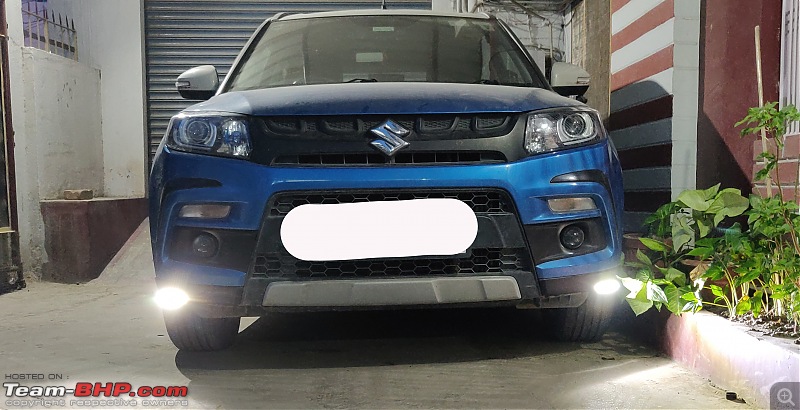

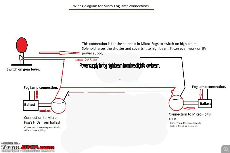

Re: Birthday gift to my Maruti Vitara Brezza ZDi+
Micro-Fogs
I've changed the setup of working of Micro Fogs. Now I've tapped low beam of headlights for fog high beam. So when I switch on fog lamps, only fogs work. When I switch on low beam of headlights, still only fog low beam will work. High beam activates only when I click on the switch on my gear lever. The fog lamp high beam is independent of the headlight high beam.
Operation Khoj: Maruti Vitara Brezza ZDi+. EDIT: Car sold - Page 7-img_20190924_213705.jpg
Fog lamp switch on - Micro Fog low beam on.
1 plus headlight's low beam on - Both Micro fogs as well as headlights work in low beam only.
2 plus gear lever switch on - Micro fogs high beam also activated with headlight's low beam only.
3 plus headlight high beam on - All in high beam now.
Gear lever switch off - Only headlights in high beam, Micro fogs in low beam only.
Fog lamp switch off - Headlights working as per the switch position.

Rear seat passengers used to complain about poor sound quality and not being able to hear songs properly. The rear speakers of Brezza are fixed in lower part of doors, just like front ones. The front also gets a pair of tweeters that makes the audio experience better. I'm not an audiophile so did not succumb to urge of upgrading the stock speakers. Dr. Parvez (XRoader_001) had installed MGA Hertz tweeters in his Brezza since a long time and he did say that once it's done, there is no need to upgrade the stock speakers. So I also took the plunge. Got the part number from him and placed an order with my local MASS guy. Part arrived in a week and I fixed it about 2 weeks back. I don't have snaps while doing installation as I was doing it alone. I'll explain a few things in detail.
Operation Khoj: Maruti Vitara Brezza ZDi+. EDIT: Car sold - Page 7-img_20191226_133828.jpg
Operation Khoj: Maruti Vitara Brezza ZDi+. EDIT: Car sold - Page 7-img_20191226_133902.jpg
The Hertz Tweeters.
The Hertz tweeters come with a crossover. I seriously have no idea what a crossover is and was clueless how to connect them. The installation manual had many things except how to connect (More on it here). Again, Dr. Parvez to rescue. He checked with his local MASS installer and told me that the input wires to crossover is from the respective side speakers and output to tweeters.

Now question was, where to fix them. He has fixed them on back side of car, where the seatbelts are. I was not keen on that place for 2 main reasons. Firstly the wires needed to be passed beneath many panels and I was not confident of removing and fixing them back properly. Also, the wires would have to be connected to the speaker wires and identifying them would have been as issue with me. Secondly, they would sit right behind the ears of passengers and I found that it might not be good.
Operation Khoj: Maruti Vitara Brezza ZDi+. EDIT: Car sold - Page 7-img20171227wa0007.jpg
Operation Khoj: Maruti Vitara Brezza ZDi+. EDIT: Car sold - Page 7-img20171227wa0006.jpg
Operation Khoj: Maruti Vitara Brezza ZDi+. EDIT: Car sold - Page 7-img20191119wa0003.jpg
Operation Khoj: Maruti Vitara Brezza ZDi+. EDIT: Car sold - Page 7-img20191119wa0005.jpg
Tweeters as fixed by Dr. Parvez.
So I followed the front setup. The door panel was removed after carefully removing the puddle lamps and other attachments. Then the tweeter base was fixed. I've fixed it to the door panel just near the top facing the rear seat. This solved the issue of removing and fixing other panels plus wiring part. The plastic base that came with the tweeter is fixed to panel with screws and the tweeters are inserted into them and locked. The wire was passed through the base inside the panel. The tweeters may look awkward as they're not sitting flush with panel. There was an attachment to fix it flush but the tweeters wouldn't have got locked firmly due to thickness and curvature of panel. The wire is then connected to the wires of crossover and soldered. The crossover is firmly fixed to inner side of panel using a zip tie and plastic glue. Then the wires for input are connected to the speakers by splicing them and directly inserting them in speaker coupler and locking them. The wires were checked for pullout by exerting force but it didn't come out. So practically, no original wires were spliced. The wires were secured and loose ends tied up. Panel was fixed back.
Operation Khoj: Maruti Vitara Brezza ZDi+. EDIT: Car sold - Page 7-img_20191226_185224.jpg
Operation Khoj: Maruti Vitara Brezza ZDi+. EDIT: Car sold - Page 7-img_20191226_185237.jpg
Operation Khoj: Maruti Vitara Brezza ZDi+. EDIT: Car sold - Page 7-pixlr_20191226133642457.jpg
The Tweeters as fixed by me.
The audio quality has improved leaps and bounds after this install. My mother, wife and son are happy with the setup. And for front passengers also, the quality is better than earlier.
