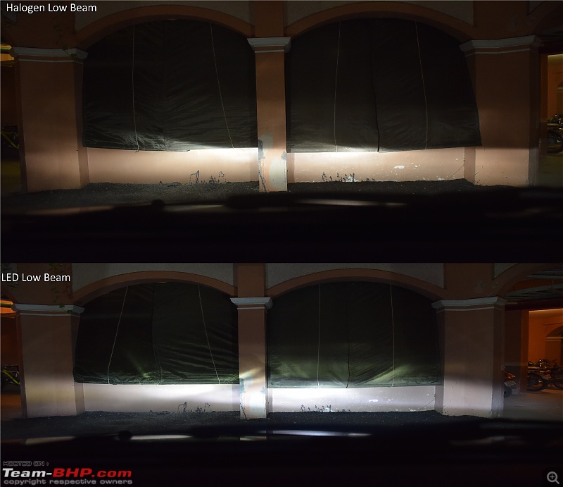

I got 55$ MIC Tuning 6000K H4 headlamp LED lights from the US, a friend carried them down. They had very good reviews on Amazon, so I thought, no harm in trying them out for 3.5k.
I am very happy with them. I installed them on my own, quite simple, would recommend two longish zipties to help install. It comes with fans, which are not audible unless the engine is off. I had blue pilot lamps lying around from the civics HID kit, so popped them in here, and it matches well. The amount of light it throws out is much more that stock, the throw is also longer and the colour looks really nice. Scattering is barely there, nobody has flashed me when I drive with my low beam on at night. I do not use high beam in the city. Enough talk, I shall let the pictures below do the rest of the talking. Hope this keeps you all occupied till the remap.

Low Beam - LED vs Halogen

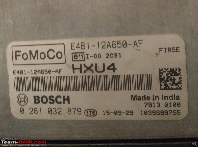

Hey, so we had a go with the new adapter, and still no success. We are just unable to read the ECU via OBD or bench. We(Akshay of GT Tunerz) were on call with Qauntum Tuning of UK, and whatever they suggested we had anyway tried, and did not work. We did not want to force read the ECU using random protocols, so tried only the relevant ones.
So, as of now the car is still on the stock map, which is not a bad thing. Akshay is going to Quantum in May, so he will take my ECU along, and we will see what the guys out there can do.

The ECU. The made in mexico ones get read easily, the made in India ones are a pain to remap.
Thanks for the update. Indian made ECU is the culprit, I believe. Alientech Italy would need the physical access of ECU to crack protocol. Also it's good that you did not try to force read the ECU using different protocols. I had similar experience in S-Cross with TOT. But they did force read my ECU and it always had checksum error. Doing more research into it, I have read that force reading the ECU might result in incomplete read (say few maps missed etc).
