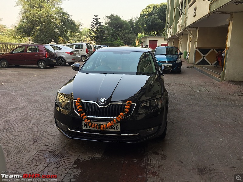

Gudipadwa 2017, how things move in life as you upgrade. Hyundai got replaced by another Hyundai, Sadly, Honda did not have anything to offer.
Welcome home, Škoda Octavia 1.8L TSI - The one with a mental disorder-img_9323.jpg

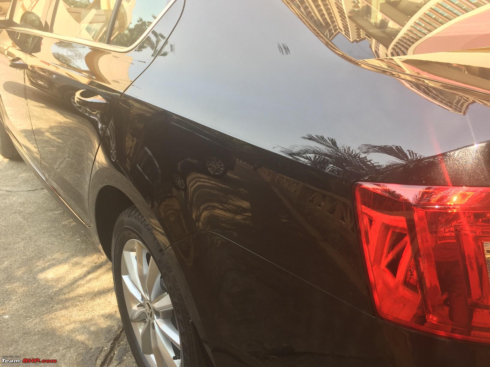

Reflection on the bonnet of the nearby building
Welcome home, Škoda Octavia 1.8L TSI - The one with a mental disorder-img_7571.jpg

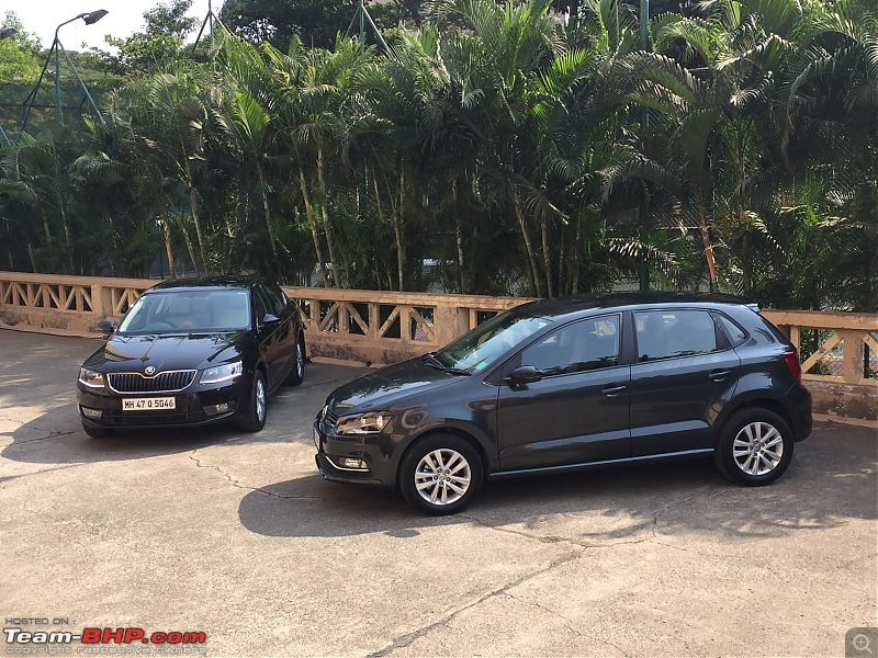

Ladies & Gentlemen, presenting another beauty, that's Deepankar's aka Dippy's Tsi (His car also has the same coating)
Welcome home, Škoda Octavia 1.8L TSI - The one with a mental disorder-img_7574.jpg
2 mental cars, together
Welcome home, Škoda Octavia 1.8L TSI - The one with a mental disorder-img_7578.jpg
