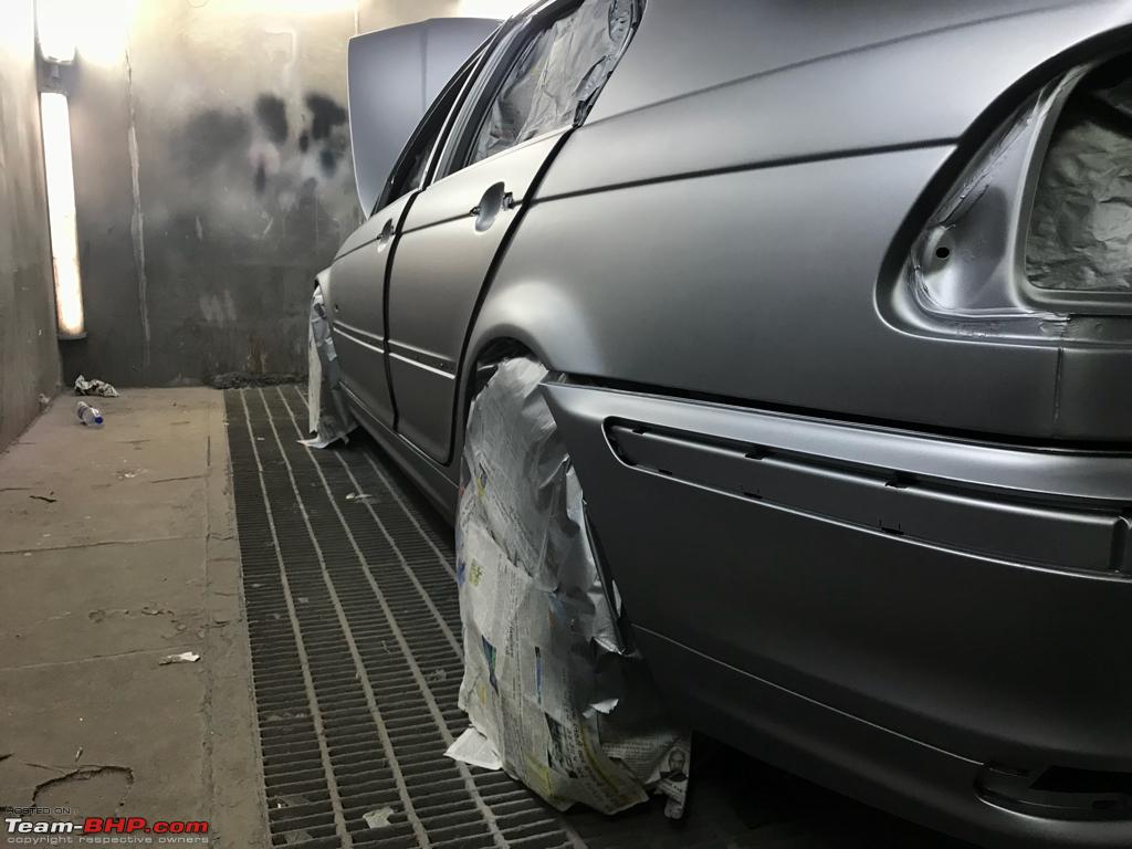

Paintjob Begins - Silver Grey Metallic
Paintjob begins & this is how it looks with 3 coats of paint (SILVER GREY METALLIC);
My 2001 BMW 328i (E46) build thread | EDIT: New video & upgrades on page 15-imageuploadedbyteambhp1525976219.536903.jpg
My 2001 BMW 328i (E46) build thread | EDIT: New video & upgrades on page 15-imageuploadedbyteambhp1525976234.976693.jpg
My 2001 BMW 328i (E46) build thread | EDIT: New video & upgrades on page 15-imageuploadedbyteambhp1525976245.822801.jpg
^ 3 more coats (clear coat/lacquer) to follow which will add the gloss
Cant wait for the final results
Oh. My. God. Are you sure you want to carry on with a gloss clear coat?

I can understand this frozen finish is looking striking good as well, but IMO for a car this old i would always prefer the old school high gloss finish. Will share the end results shortly, hopefully by tonight
Great colour choice Karan Can't wait to see the end result!
Considering how particular you are about proper work on the car, don't you think the paint booth area is too dirty? Wouldn't the dust blow up and settle into the clear coat?
amansanc is offline   (1) Thanks
I am sure Karan is very particular about the paint quality and finish. It is impossible to control the dust which enters the paint booth after the paint is left to dry because of people walking in the booth to check the paint or for some other work. In order to minimize the chance of dust settling on the wet paint, most paint booths thoroughly clean the booth before painting or applying clear coat and wet the floor too. Few dust particles do settle on the clear coat even after all these precautions and these are easily removed while wet sanding.
Good observation, i do partly agree that the booth was kinda unkempt with some bits of papers, a bottle etc lying around BUT it sure was dust free and had a proper air handling unit. Rest as Akib mentioned below the next process of wet sanding should surely take care of those impurities if any. Shall post some pictures in a bit.

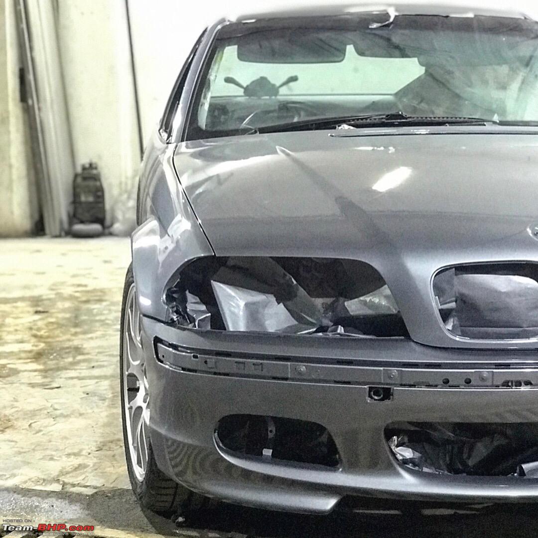

2 coats of primer, 3 coats of paint (silver grey metallic) & 3 coats of lacquer later this is the end result;
My 2001 BMW 328i (E46) build thread | EDIT: New video & upgrades on page 15-imageuploadedbyteambhp1526054079.273744.jpg
My 2001 BMW 328i (E46) build thread | EDIT: New video & upgrades on page 15-imageuploadedbyteambhp1526054223.916194.jpg
My 2001 BMW 328i (E46) build thread | EDIT: New video & upgrades on page 15-imageuploadedbyteambhp1526054238.595427.jpg
My 2001 BMW 328i (E46) build thread | EDIT: New video & upgrades on page 15-imageuploadedbyteambhp1526054254.509838.jpg
My 2001 BMW 328i (E46) build thread | EDIT: New video & upgrades on page 15-imageuploadedbyteambhp1526054274.889881.jpg
So far it seems Team DADesign have done a good job with the paintjob
Next steps will be wet sanding the car (after 2-3 days) & 2 coats of polishing.
Hope everyone likes it
