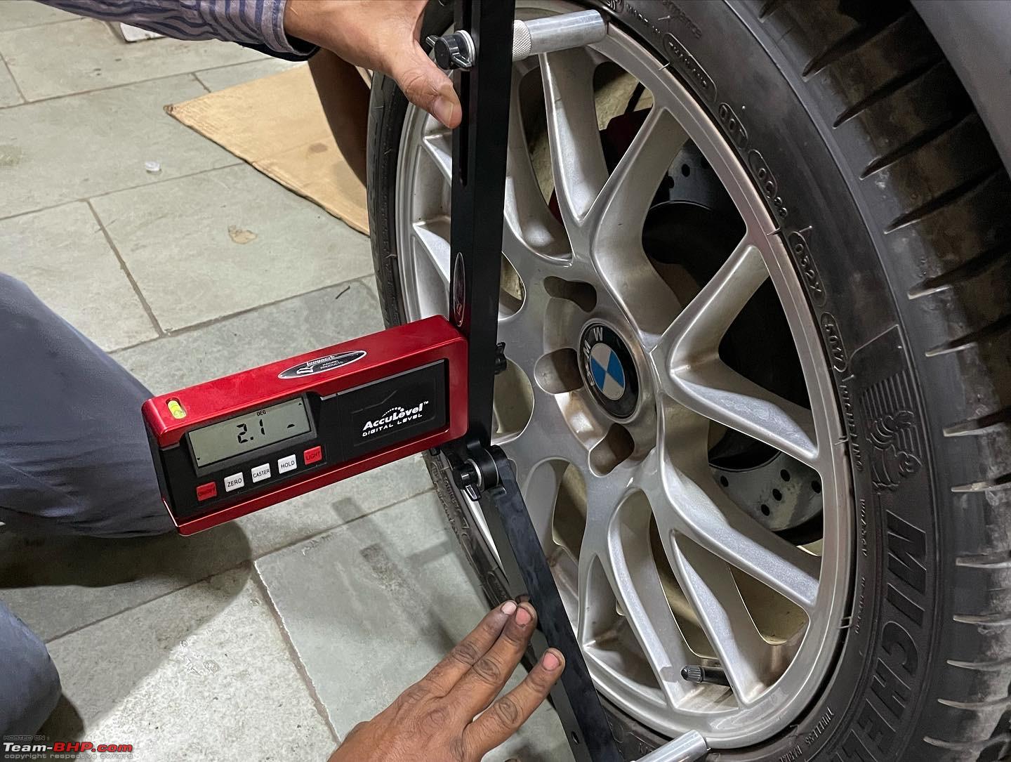

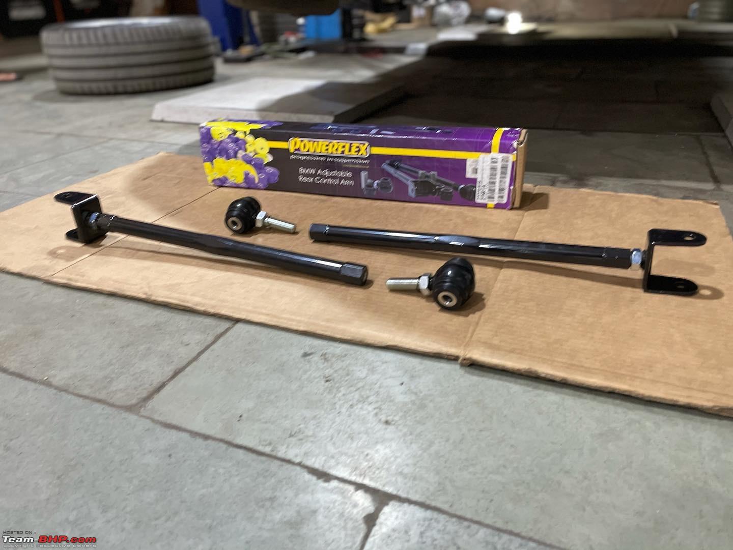

My E46 needed the rear camber to be negative but unfortunately it did not have adjustable rear camber arms. Hence with the help of N1 Racing I sourced PowerFlex Adjustable Rear Control Arms. These can run negative camber upto - 3 Deg. (Note factory spec. for rear camber of a low slung E46 is -2 Deg.)
This Upgrade will Surely help me explore the true handling potential of my car.
Here are some pics during the install;
My 2001 BMW 328i (E46) build thread | EDIT: New video & upgrades on page 15-008a479d7e0b40a882ff04055aaa38e5.jpg
My 2001 BMW 328i (E46) build thread | EDIT: New video & upgrades on page 15-c5fc9f0f6c9549459a5e8c908d9f4cd5.jpg
Old V/s New;
My 2001 BMW 328i (E46) build thread | EDIT: New video & upgrades on page 15-e03bb81b98cf41a0b89e9663cdb07e7b.jpg
The install took time as the Exhaust had to be dropped to access some bolts, overall in this pic we can see my Magnaflow Exhaust being refit back into place while the Control arms were partly fit in.
My 2001 BMW 328i (E46) build thread | EDIT: New video & upgrades on page 15-c70a5f1531fe475db5753018381d5fca.jpg
Team N1 passionately setting up the Camber Gauge;
My 2001 BMW 328i (E46) build thread | EDIT: New video & upgrades on page 15-8469a73bfdd54a07bf6728bf91ffadeb.jpg
Rear Camber Set @ - 2.1;
My 2001 BMW 328i (E46) build thread | EDIT: New video & upgrades on page 15-b73d789a042f4c91a458f5f2856ab18a.jpg

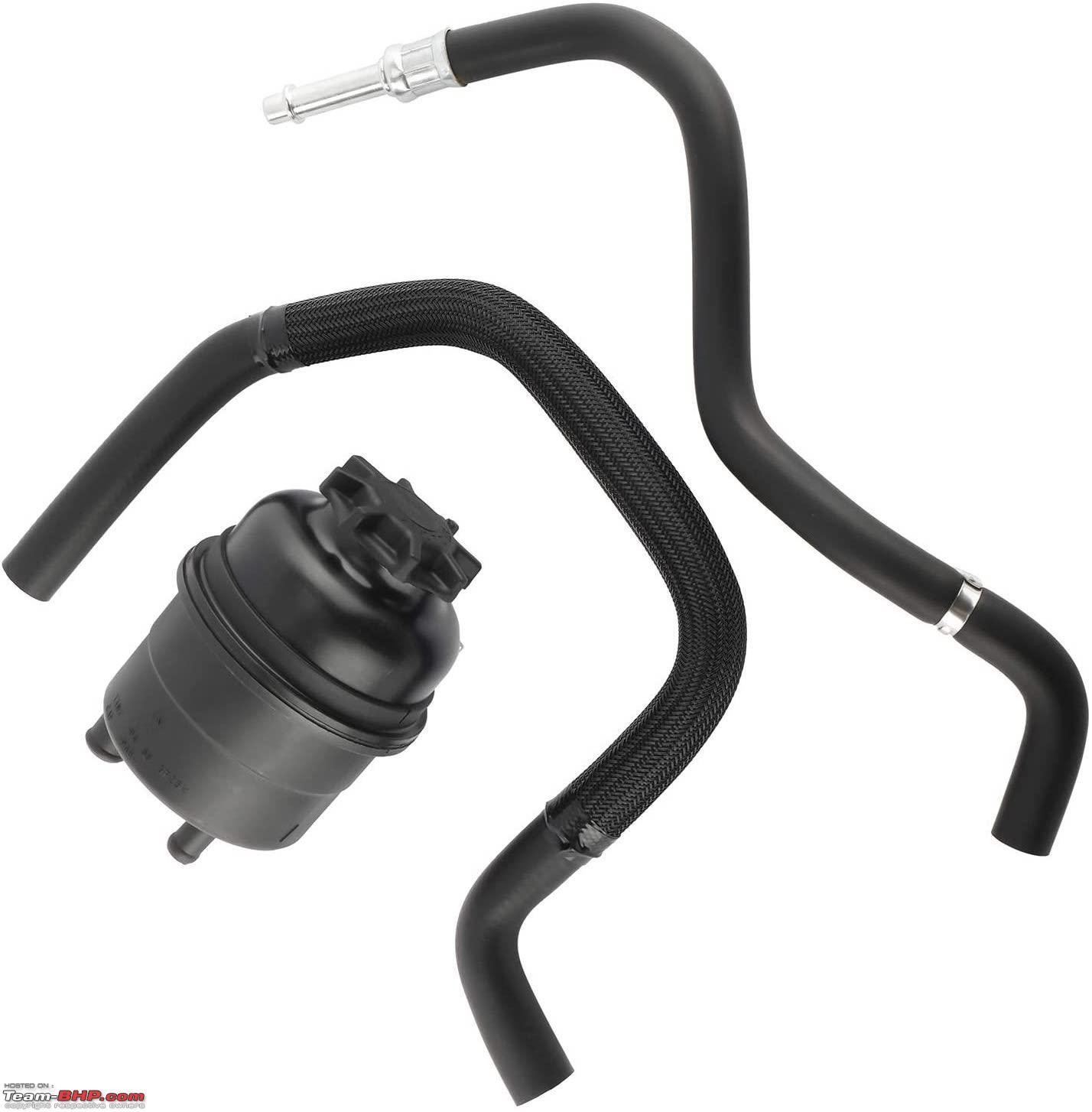

1) Power Steering Fluid Leak;
My 2001 BMW 328i (E46) build thread | EDIT: New video & upgrades on page 15-power-steering-.jpg
Few weeks back I had observed a leak in the engine bay area and was visible in the underbody too.
It was discovered that the power steering fluid was leaking, hence got the power steering reservoir and some other small parts/pipes changed to fix this issue for good.
The Power Steering fluid the car uses is ATF (Cheaper than CHF used by other newer cars), do note that this is a hydraulic unit.

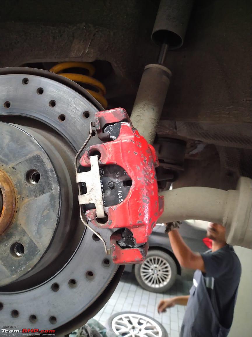

3) Rear Brake Pads;
The rear brakes (Disc & Caliper) are from the E46 M3 but during the initial modifications for some reason (probably availability) regular E46 3 series pads were installed.
This was creating some uneven wear & contact patches on the discs;
My 2001 BMW 328i (E46) build thread | EDIT: New video & upgrades on page 15-photo20211106111158.jpg
Fortunately BMW Infinity workshop had E46 M3 brake pads in stock hence got proper M3 brake pads installed;
My 2001 BMW 328i (E46) build thread | EDIT: New video & upgrades on page 15-photo20211106111252.jpg
My 2001 BMW 328i (E46) build thread | EDIT: New video & upgrades on page 15-photo20211106111307.jpg

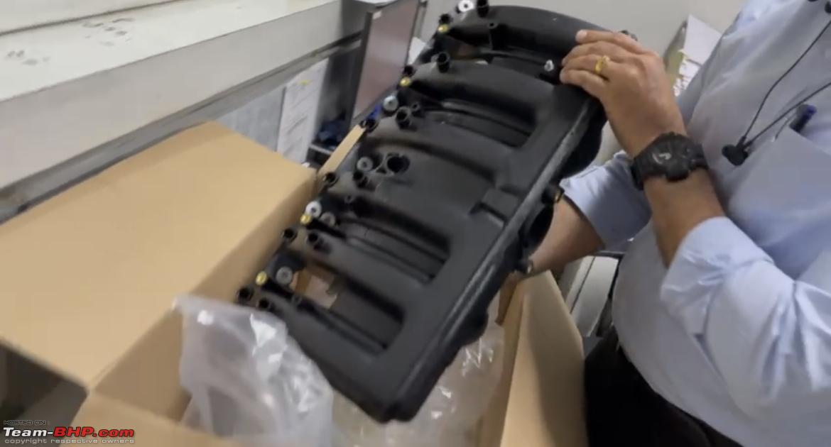

6) Intake Manifold Job;
My 2001 BMW 328i (E46) build thread | EDIT: New video & upgrades on page 15-img_c2155966d0881.jpeg
The car was having some issues with the idling & did misfire sometimes. This was diagnosed with issues related to the Intake manifold & some odd job carried out by the ex owner. In this case i did not go into repairing/rebuilding/refreshing the intake manifold instead i ordered a completely new one & got it installed. Sometimes its best to replace than to repair it holds especially true with older BMW's. As they say an ounce of Prevention is better than a pound of cure.

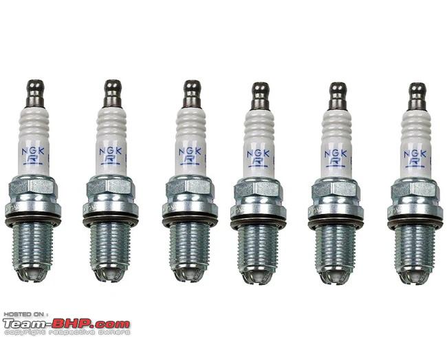

3) Spark Plugs;
As per the service centre guys they found Excessive shooting in cylinders 1, 2 & 3. To solve this the spark plugs needed a change.
My 2001 BMW 328i (E46) build thread | EDIT: New video & upgrades on page 15-ngk.jpeg
Last change of spark plugs was 5+ years back, hence went ahead installed new plugs.
