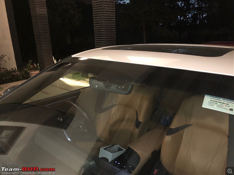

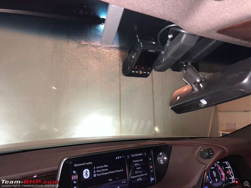

Seeing increase in road rage incidents in NCR and next to no traffic sense, i wanted to make myself feel a little secure and decided to procure a dashcam. I already had Transcend Drivepro 100 dashcam purchased 3 years back, but it was powered through Li-ion battery. There is always a risk with battery powered dashcam especially with the heat we face here.
Requirements:
1. Capacitor powered
2. Dual channel
3. Wi-Fi feature for ease of data access.
After researching a lot on Team-BHP and dashcam forums, i placed order for Viofo-A129 Duo on Aliexpress. It had all the features i needed and was quite VFM. The package arrived in a little over a month as it was retained by Customs for some reason. Thankfully, i was not charged any duty.
Driven: Lexus ES 300h-img_7340.jpg
Install:
I was pretty clear that i don't want to risk my warranty with hardwire install. ES has 4 USB ports plus an additional power outlet in the central console. I decided to plug-in USB adapter that came with the dashcam inside the center console. That way i didn't need to fiddle with it daily, and it'll be quite discreet too.
Driven: Lexus ES 300h-img_7344.jpg
There was sufficient gap between the armrest and center console trim for the wire to pass through.
Driven: Lexus ES 300h-img_7343.jpg
I installed the power cable first from the IRVM, passing through A-pillar trim. I made sure that the cable should not hinder inflation of side airbag, incase of an unfortunate incident. I wish it never comes to that.
For this, i routed the cable from behind the airbag.
Driven: Lexus ES 300h-img_7345.jpg
Then from behind driver side dashboard trim to the under the driver side seat from the door sills.
Driven: Lexus ES 300h-img_7347.jpg
Driven: Lexus ES 300h-img_7348.jpg
As it's dual channel dashcam, i also needed to run a wire from front dashcam all the way to the back, i removed B pillar trim, and routed the wire alonside power cable all the way to the back seat, beneath the trims.
Driven: Lexus ES 300h-img_7349.jpg
Driven: Lexus ES 300h-img_7350.jpg
Installed front dashcam behind IRVM and rear dashcam on the extreme right side as it was hindering operation of powered sunshade.
Driven: Lexus ES 300h-img_7352.jpg
Driven: Lexus ES 300h-img_7371.jpg
Driven: Lexus ES 300h-img_7353.jpg
Driven: Lexus ES 300h-img_7367.jpg

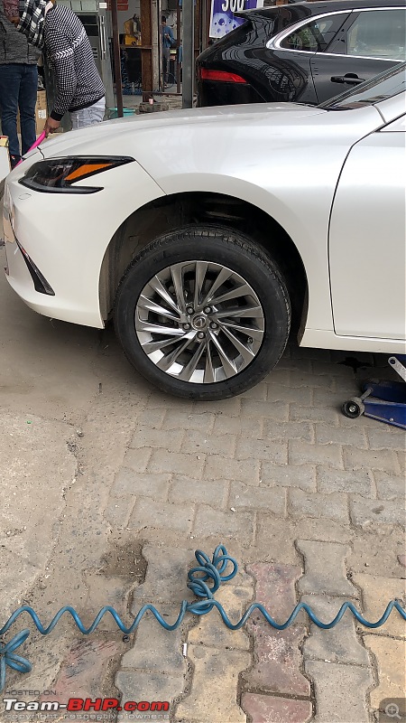

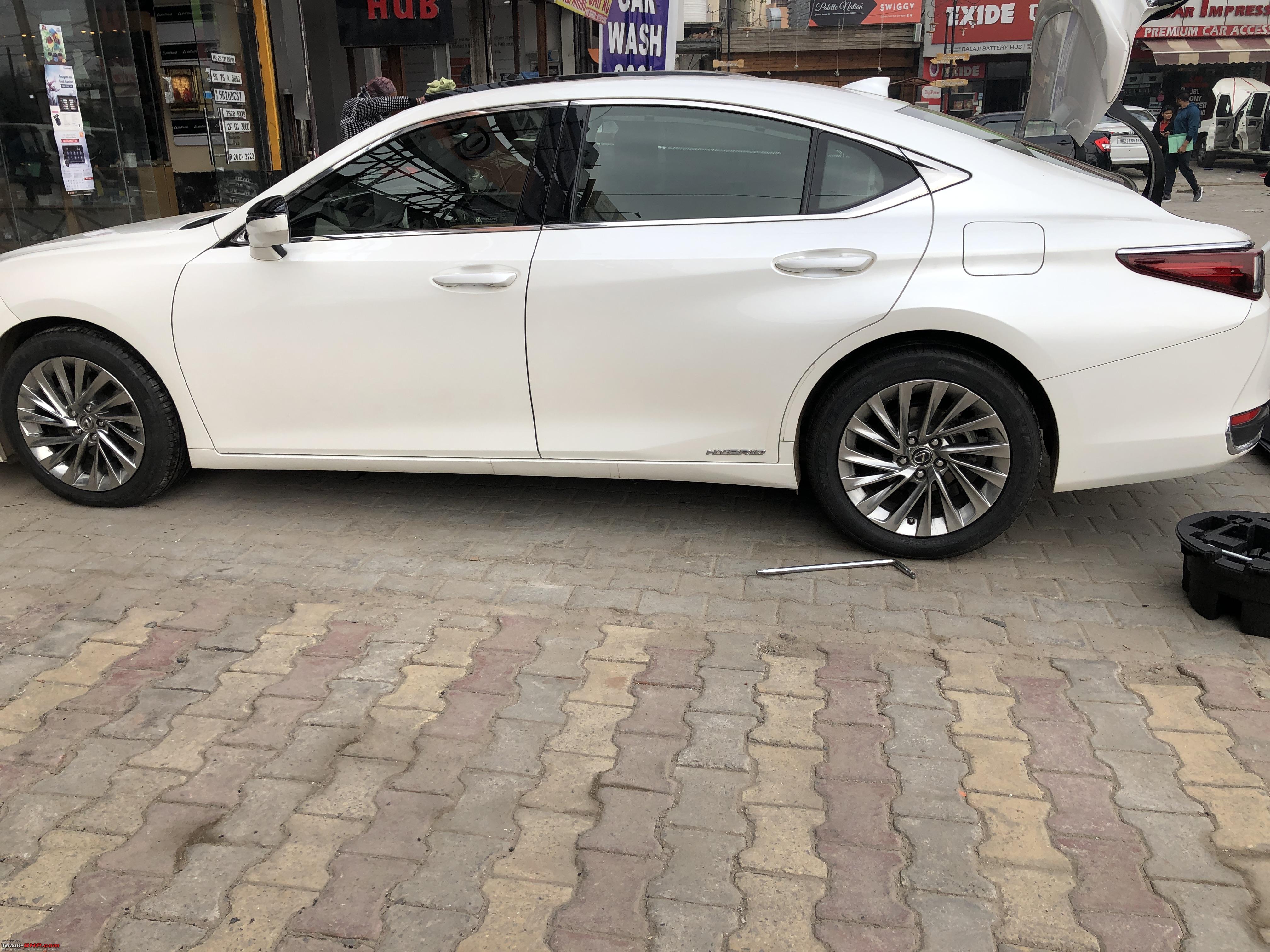

Tire Upsize:
All the 4 tires of my car were due for replacement as the tread was nearing to wear indicator.
Few months back, one of the tire was destroyed by Petrol Pump puncture repair shop due to intentional sabotage by poking 4 hole in the inner sidewall. I got it repaired and changed it with the stepney for the time being.
Yesterday, one of the tire suffered side wall tear due to impact with a sharp pothole.
Driven: Lexus ES 300h-ce3a4fce00fc459d9ba89ee1084bf2fd.jpeg
I had to change it with stepney, and guess what? The stepney was leaking air due to punctures in sidewall. It was maintaining pressure in the boot, but the seals were not holding pressure under the weight of the car. Also, one of tire had gouged sidewall.
So that made 3 out 5 tires damaged or unsafe.
It’s well documented in the forum that Lexus ES suffers from low GC, and frequently scrapes over speed bumps.
Instead of 235/45 R18 which is the OEM size, I upsized to 235/50 R18.
Using the formula “Width x Height/100” we can determine the actual sidewall height.
235/45 gave me sidewall height of: 105.75 mm
235/50 gave me sidewall height of: 117.5 mm
That’s a healthy increase of approx 1.2 cm. The variation is above 3% but it doesn’t affect the behaviour of car as such. Instead, now the ride is cushier and the suspension is able to absorb road joints and bumps really well. I’m happy with the change.
For the tires, i had the option of Pirelli Scorpion Verde and P-Zero, and for Michelin i had the option for P4ST.
The Pirelli Scorpion was priced at Rs. 17,500 and P-zero was Rs. 15,000 without bill and warranty (Grey market)
I went with Michelin Primacy 4ST which costed Rs. 20,000 per piece (with bill and warranty).
For now, i got 4 tires changed.
Driven: Lexus ES 300h-f24cacc8fe4848db9fefda14cb48f25c.jpeg
Later on, i took the car in a empty parking lot and made high speed U-Turn to see if there was any rubbing due to upsize but there wasn’t any.

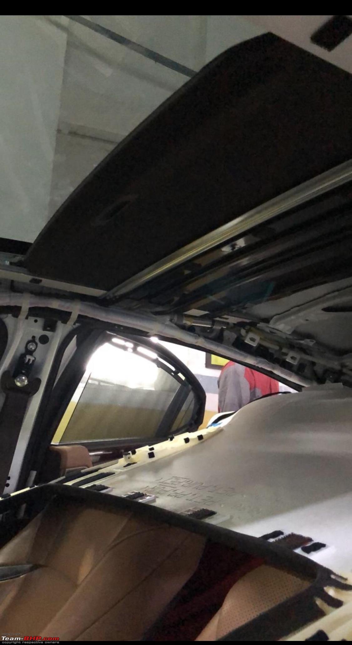

So, got the car back from the service center after 9 days.
The work done on the car were as follows:
1. Excessive noise and movement in Indicator Stalk
- Made a video and sent for warranty replacement approval from Lexus.
2. Front Left Suspension Squeak
- Was traced to cowl top, but noise again appeared after bringing the car back home. Will send it later for detailed inspection.
3. Rattles from Screen and Center console
- Removed the panels and installed them with NVH tape.
4. Sunroof Noise
- Well, this turned out to be a biggie. The noise was supposedly fixed on 6th day. But after my drive, i found it the same as it was before. Had to give car back for additional inspection. All in all, the roof liner had to be removed twice. The second time, the noise was traced to joint between roof sheet metal and B pillar. It was fixed after removing sunroof assembly and filling the joint with foam filler which hardens after being sprayed.
5. Rear Door Creak:
It was fixed after removing the panels and reinstalling the wood trim with NVH tape in between.
6. Rear Suspension Noise
This was fixed in second round. It was eliminated after greasing anti roll bar bushing and rear shock absorber bump stops.
7. Driver Seat Frame Movement:
Made a video and is sent to Lexus India for warranty approval.
