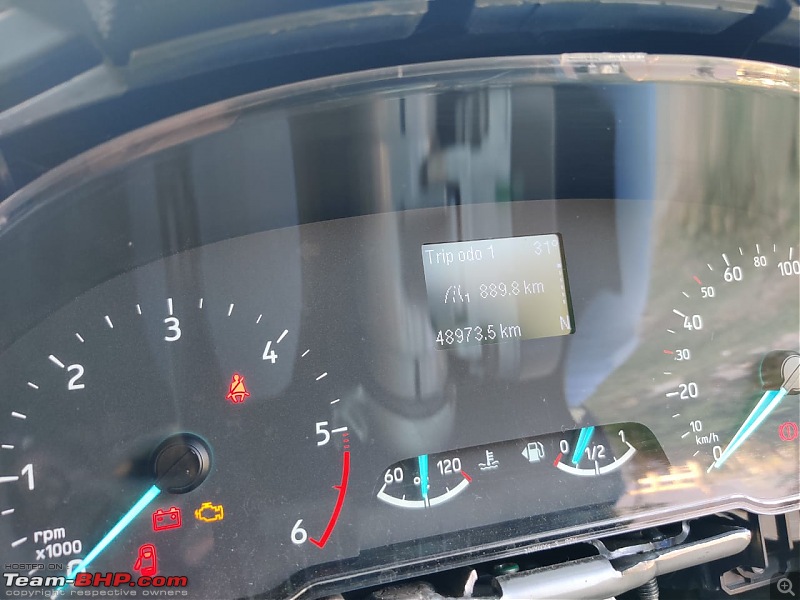

Also enabled compass on the instrument cluster using IPC module(bottom right corner of the MID display). Enabled the oil service interval, driver alert system a.k.a Driver fatigue detection and ceramic brake pad wear indicator(though I have stock brake pads, I have experimented by enabling the option. Likewise for Driver Fatigue detection as well)
I find the compass direction useful. Going to change this bland looking MID soon
Blue Baby comes home - Ford EcoSport Facelift Titanium TDCi-img_20201101_232934.jpg

49,000 km Update: Cluster Swap to Diesel AWD ST-Line cluster (Part No. GN15-10849-CDH)
The Car is almost about to complete 50k kms and I thought why not gift it something . I tried enquiring for the S variant speedo with all scrap dealers across India and no luck here :(. FASS won't give the instrument cluster without seeing the car in person. Also, Naveen's post of changing the cluster gave me some confidence that I can configure the cluster on my own.
Since a detailed explanation is given by Naveen already, I'll be sharing my experience
Link for the detailed mod explanation( this includes for cluster swap and cruise control):https://www.team-bhp.com/forum/diy-d...e-variant.html (DIY: Upgrading the Indian EcoSport Titanium to the Global ST-Line Variant)
On my usual searching spree on all car related sites across the globe, on February I found the exact speedo cluster(I was very particular about the diesel cluster because functions such as glow plug indicator and water in fuel filter does not work in a petrol cluster) I wanted for my car on eBay. Contacted the seller directly and Boom! No shipping to India via eBay .
The Eureka moment:
Then I had a contact of mine in the UK and requested him to get the speedo for the price I requested the seller(90 Pounds) and ship the meter to me. He readily agreed and I got the speedo shipped through Royal Mail (India Post equivalent in the UK). The tracking number given by Royal Mail works for India Post tracking as well.
The wait:
This is really the most thrilling part as the speedo got stuck with the customs the day it landed in Bangalore. A couple of trips to the Foreign Post office and by explaining the justification to the Customs Superintendent, the parcel was cleared in a week(the lack of customs officials is the cause for the delay).
Then the blame game of the post office started. I had to run around to a couple of post offices as my area pin code was changed without informing us(duh!). This ordeal was for 2 days
The result:
Finally the courier reached my house yesterday and I was super excited to see the meter. I went to Hosur as Naveen and I wanted to explore some more modules in the Instrument Cluster and got it fixed yesterday.
After plugging in the meter in my car, we saw 4WD gauges et al. and we decided to enable the features that are relevant to our use.
The output was impressive and the highlight is that google maps navigation works on the MID itself which is usually possible if there's a HUD. Note that navigation in cluster will work only with the bigger MID and Sync 3 version 3.4 build 19200 or 20282 and above.
However, the remaining functions are same as the S variant
Let the pictures do the talking:
1. My Old Cluster
Blue Baby comes home - Ford EcoSport Facelift Titanium TDCi-whatsapp-image-20210314-11.28.47-am-1.jpeg
